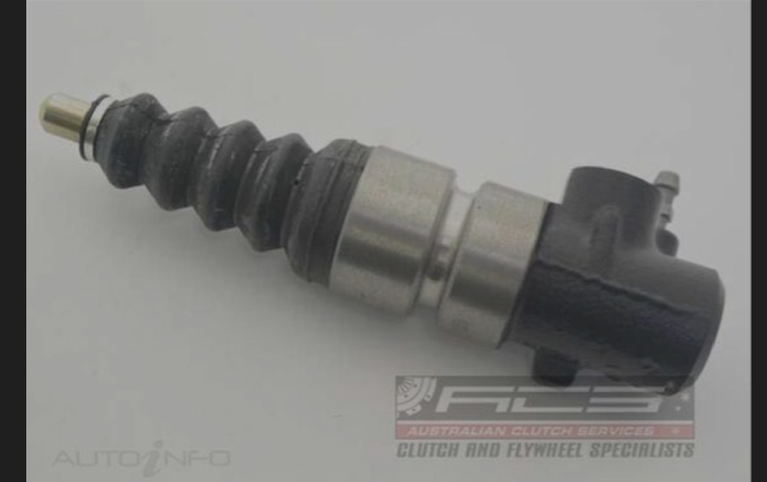

Mitchell, If the pushrod was too long AND the clutch fork, throw out bearing and clutch pressure plate are all OK, then you would have to engage and lift the clutch pressure plate in order to have the slave cylinder fully seated so the mounting bolt will thread into place. That's got to be at least 50 -100lbs of shoving to line up.
Also the slave would try to pop out before you got the bolt in since the pressure plate would be pushing back against the clutch fork. So if the mounting bolt goes in without argument, the slave piston is not too long IMHO.
