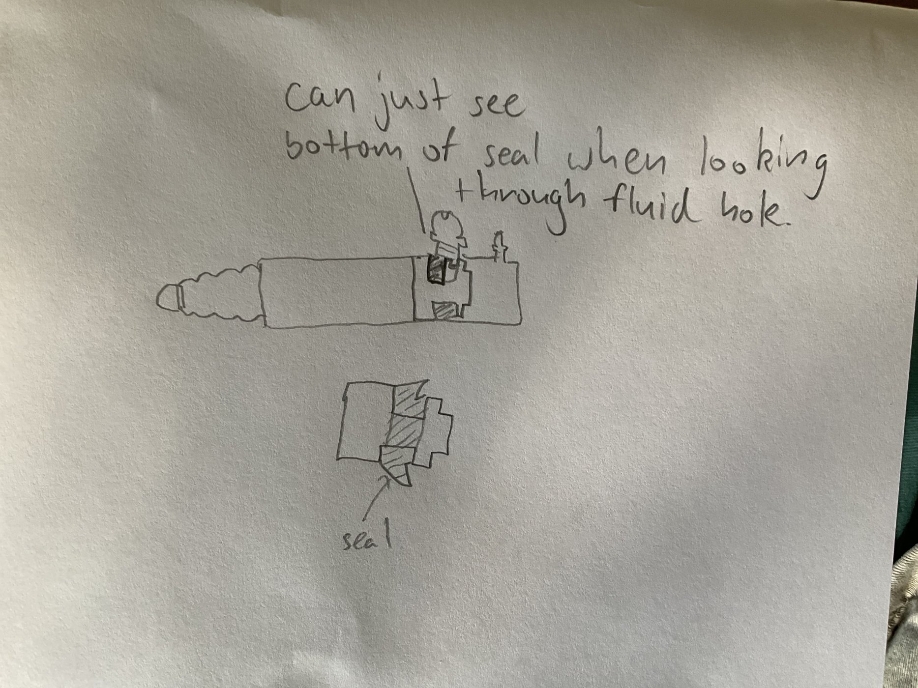

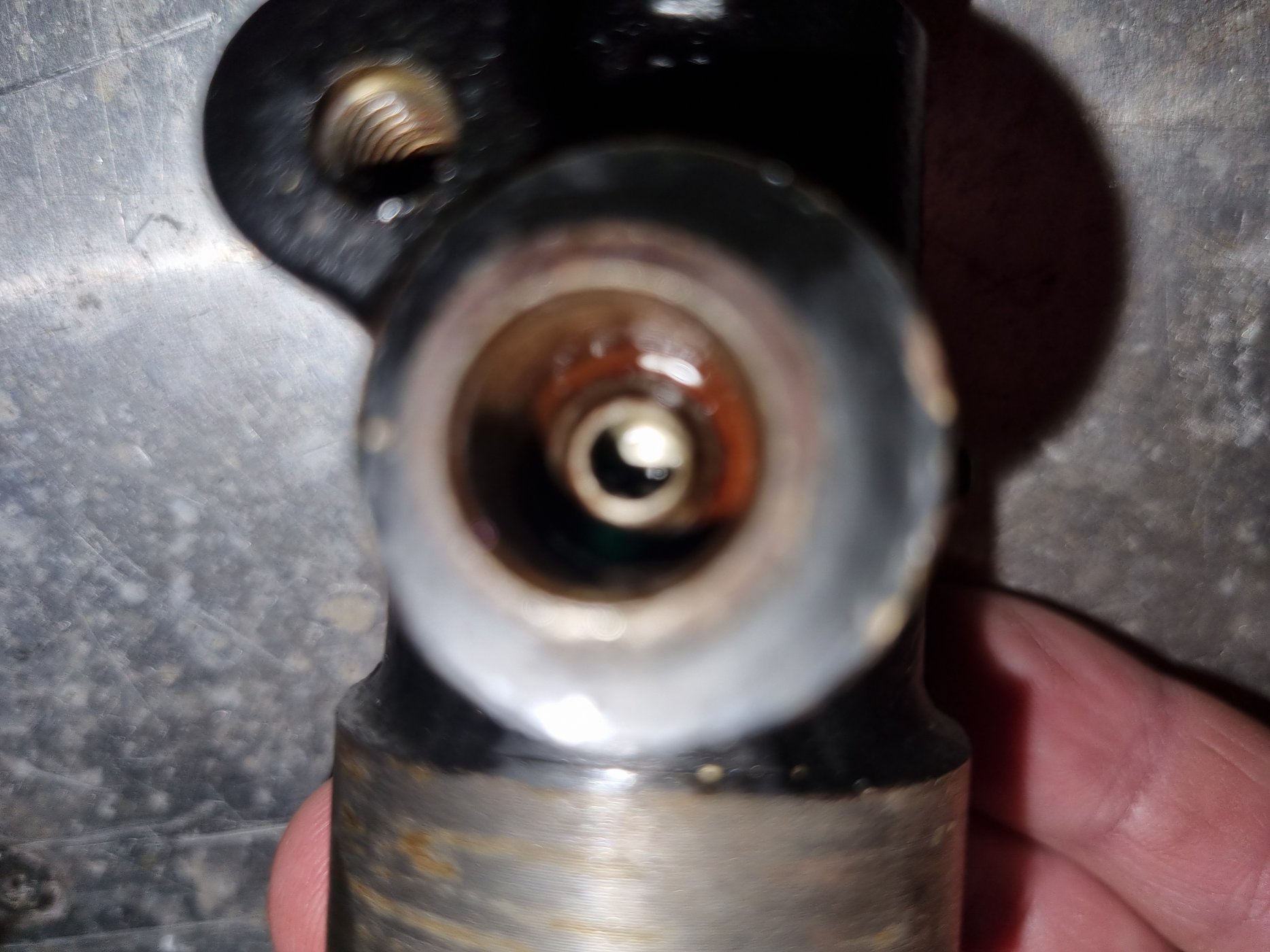

My gut would say that no you should not be able to see the seal when you look down the bleed or fill hole. In my head that would mean that the fluid would have a way past the seal in your picture a little dogleg upwards near the bleed nipple past th e seal and into the dust gator.

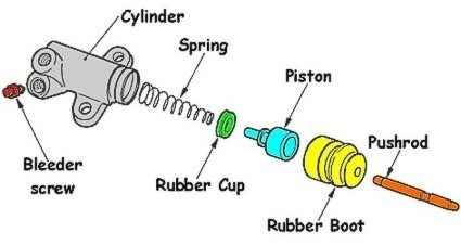

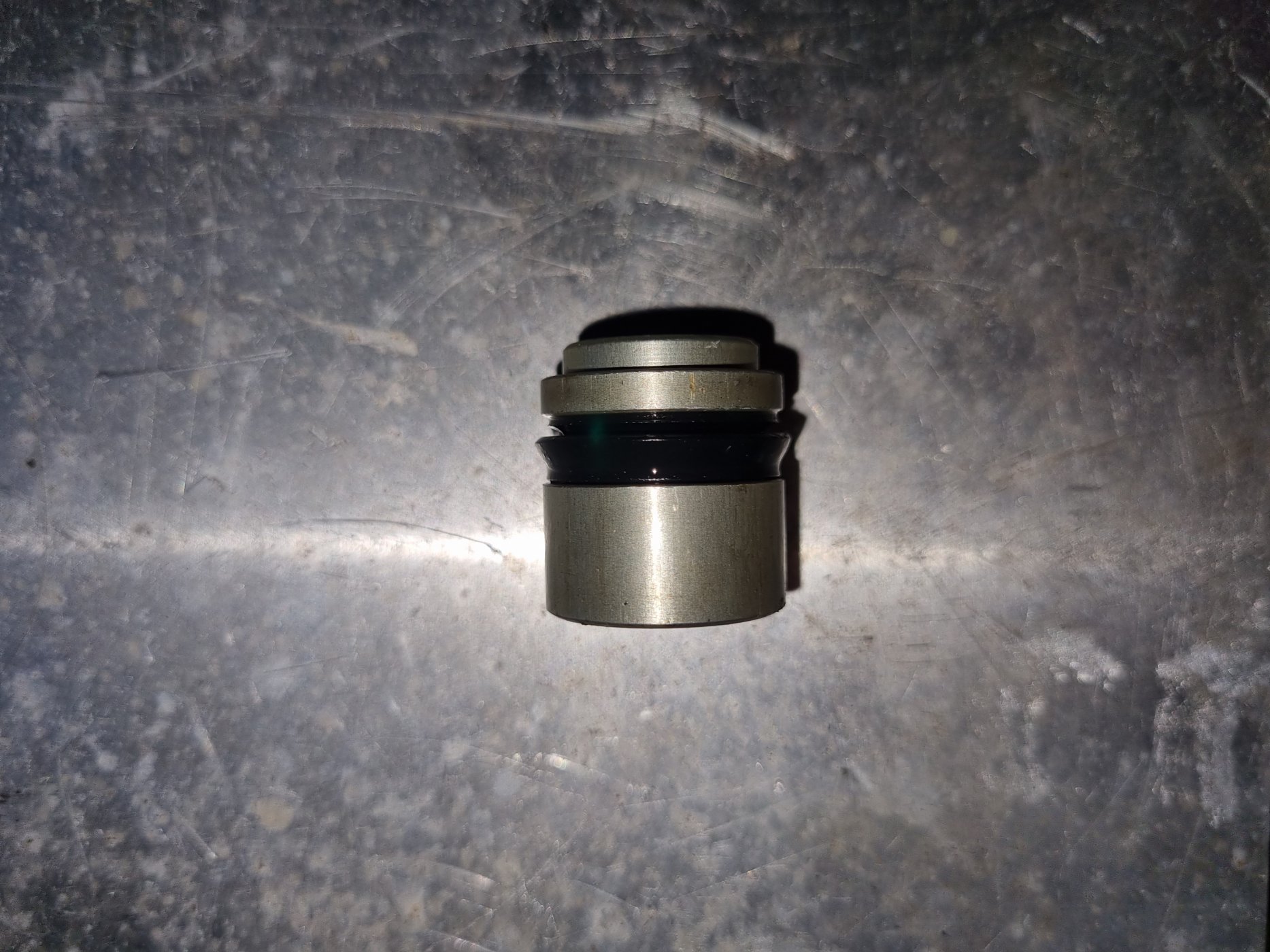

Does it have a "rubber cup" missing as seen in this image that will stop the piston so that the seal never moves further than thebore and not into the bleed nipple area?

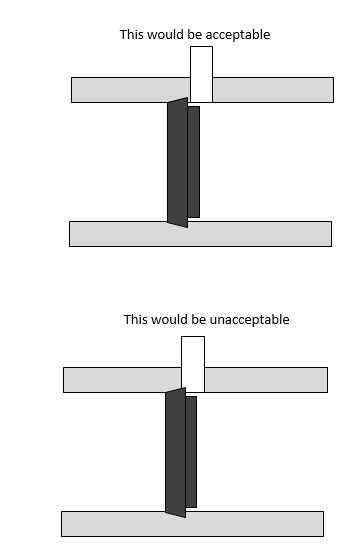

Ian is on the mark here, but the exact positioning of seal is critical in that when you "just see the bottom...". If you can see the pressure flap (the directional, concave portion of the seal or Rubber Cup in the above diagram (the edge of the lip that is facing rearward), it would seem that fluid pressure at that point cannot swell the lip radially outward to seal the cylinder because pressure is applied now to the wrong side of this flap or lip. If the lip (flap) is not visible, and you only can see the base of the seal (NOT the edge of the lip), then you may have a properly positioned piston/seal. Looking at the photo (out of focus, or I need new glasses), it looks too close to call, because it appears you are looking at the base of the seal, but surely the lip is extremely close to the port at that position based on the other photo of the piston only.
If indeed the seal is too far rearward, a shim or some means of forcing the piston just a mm or two, forward should help (the small protrusion at the rear of the piston in the drawing above would be too short). If indeed the seal is too far rearward, that to me indicates a faulty design or machining, and perhaps why you've had two in a row with this problem. If the lip is not positioned, it would allow some amount of fluid (not much) by the seal until the piston moved forward and properly stopped any leakage. Heck, stick a penny in the end of the bore, reassemble, and go with it ;).
I left the lip (cup if you will) in the drawing below "relaxed" so that it better illustrated my point. Normally it would be compressed in the bore.
its hard to tell from the small hole. Will get the magnifying glasS on it to see if I can work it out. If I shorten the pushrod then that should allow the piston to sit forward more.
It’s similar. The cup is a seal that sits in a groove in the piston. A photo on post #47 shows it’s position. It’s looking like I can see the bottom of the seal but not quite the flap part, but it sure would be close.

Mitch, if you shorten the pushrod, that would help, but what is the clutch wear doing to this relationship? I believe clutch wear will help you out in your case (guessing). In my Porsche set-up, wear would cause the problem to re-emerge as the clutch disc gets thinner. So you may be fine and done, especially if your slave has a spring in the back (behind the piston), because it will always be pushing the piston forward with some light pressure. If it doesn't have a spring...then?
My thoughts about sticking a shim behind the piston prevents the piston from ever being pushed far enough back to ever present this issue. I suppose either option will be effective if this is indeed the problem.
