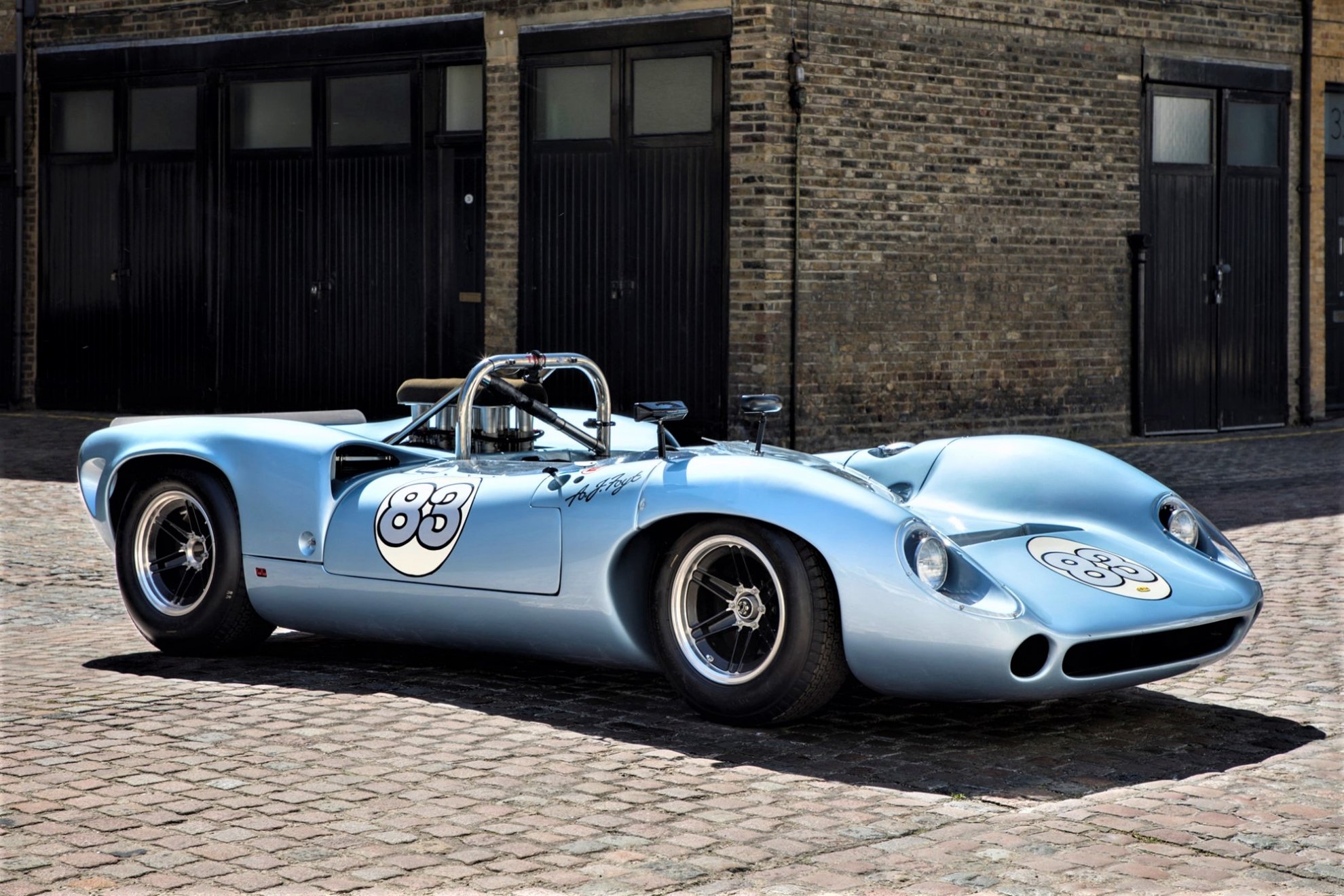

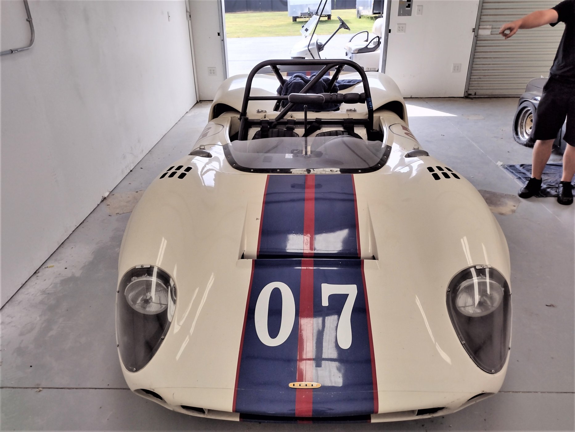

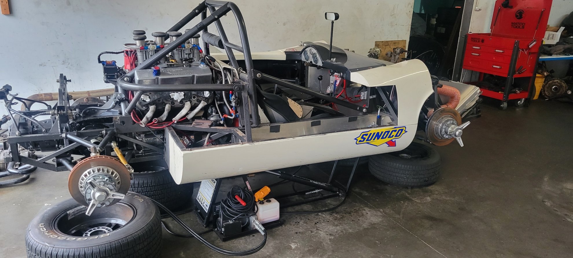

@Fran Hall RCR - Fran, I now own one of the two cars completed by John Gyan from Can-Am Creations (the one featured in the Kit Cars mag writeup). I have replaced everything rubber, rebuilt the Webers, recharged the fire suppression system, aligned and corner weighted, added 12V and USB power ports, added horn with hub button, turn signals, and applied the same livery and graphics as # 83 driven by A J Foyt. The car already had a GA title, so I plan to plate it and do some cruising in Michigan, as well as vintage racing (it has an HSR logbook). I was informed that you worked with John Gyann and helped him develop the car - is this true? First photo is car as I obtained it. Second photo is the livery and graphics being applied at this moment.

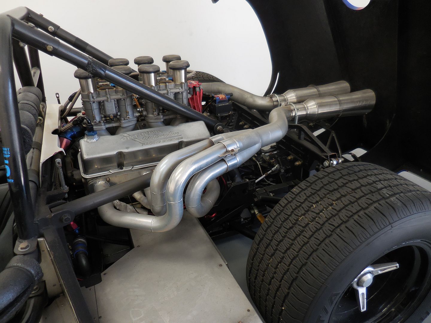

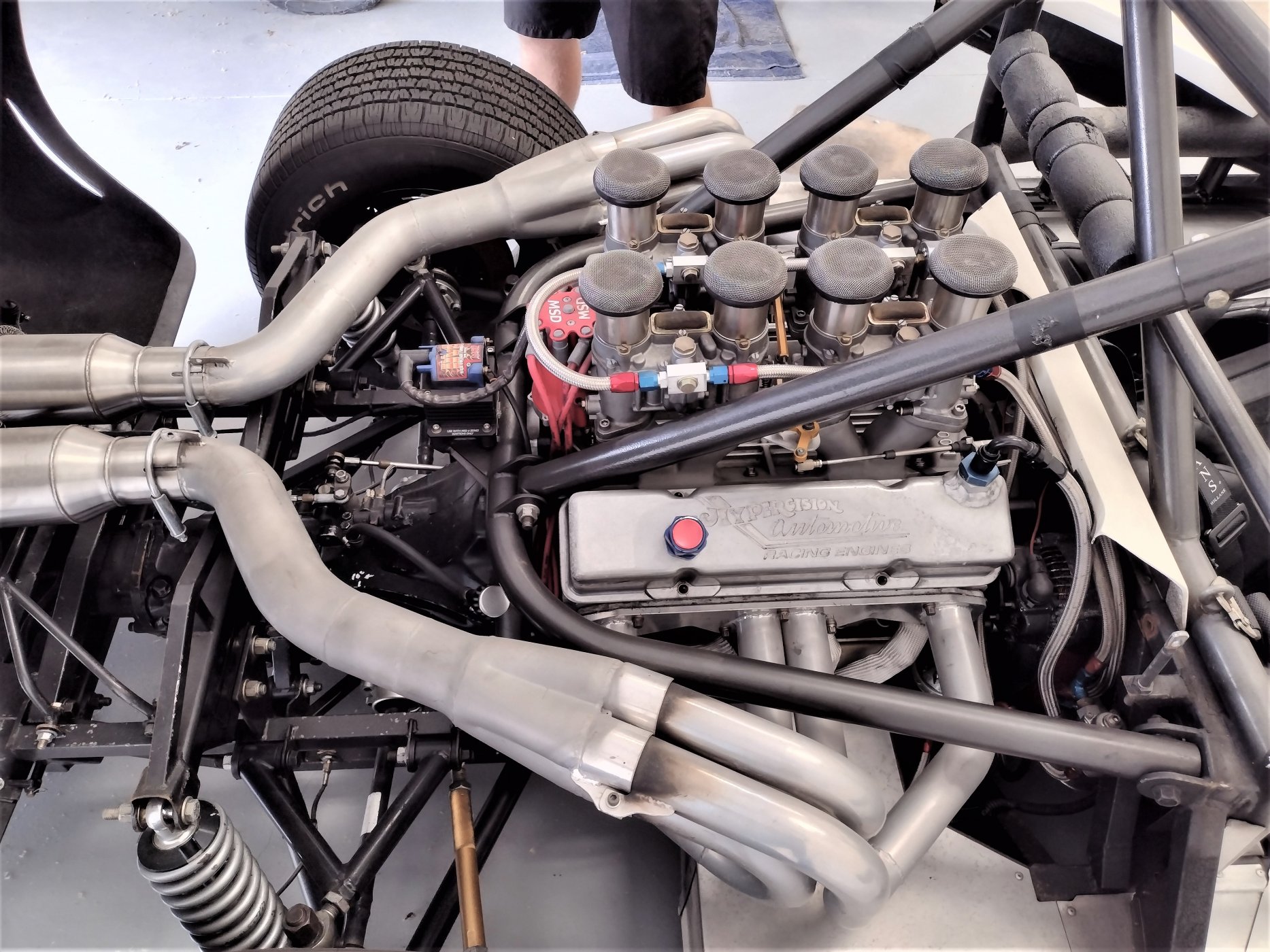

Additional rebuild info: My T70 is not historically accurate. It is is dimensionally accurate, and, with a steel frame, structurally similar to the earliest T70 Mk I's. I have been advised that some of the panels are ex-Huntingdon, and the motor is Can-Am spec, albeit slightly detuned (460 hp). The motor is a 383 CI SBC fitted with an original Moon manifold and 4 Weber 48 IDA two-barrel downdraft carbs. The car runs on 93 premium, but pulls stronger with a couple gallons of added race fuel. The car was built by John Gyann near Chicago at the turn of this century. According to Fran Hall, the frame of the car was constructed by Lola Continuation cars in England a few years earlier. John Gyann wanted a car with robust chassis and suspension, and convenient parts accessibility - a car suitable for both road and track. Thus, my T70 is equipped with Corvette C4 uprights, hubs, wheel bearings, spindles and more. The car has a steel frame with aluminum sections, similar to the Mk I. John Gyann eschewed a 4-speed Hewland trans (which would have been neat with the clutchless upshifts enabled by the dogbox rings) in favor of a 5-speed Getrag engineered for a much heavier Audi. The addfitional, and lower, first gear and baulk-ring synchros enable easier driving around town. He built two T70's, and planned on putting the car into production, but a recession intervened, and only two were produced. Now that mine is almost back on it's (rubber) feet, both cars will still be running (the other on European tracks, acccording to a prior owner of my car). My T70 has an HSR logbook, has run a few races, won a couple, and participated without great success in the 2012 Walter Mitty in Atlanta. I hope to complete my SCCA Competition licensing this coming weekend, and future plans include entering my car in a few races per year. After three races over two years, I will receive my Pro license, which is basically a bucket list thing - I do not intend to do any serious racing - vintage appearances only. There are some really serious racers in vintage, to be sure, but no kamikazes, as the rules protect valuable cars and older drivers. For most of us, it's about participating, not winning, although there are exceptions driving their 800 hp Ford GT's and Porsche 935's. My finger will get tired pointing them by.
The car is now painted and final reassembly has begun. The T70 imaged in my signature is not actually mine, but carries nearly identical paint color and graphics.

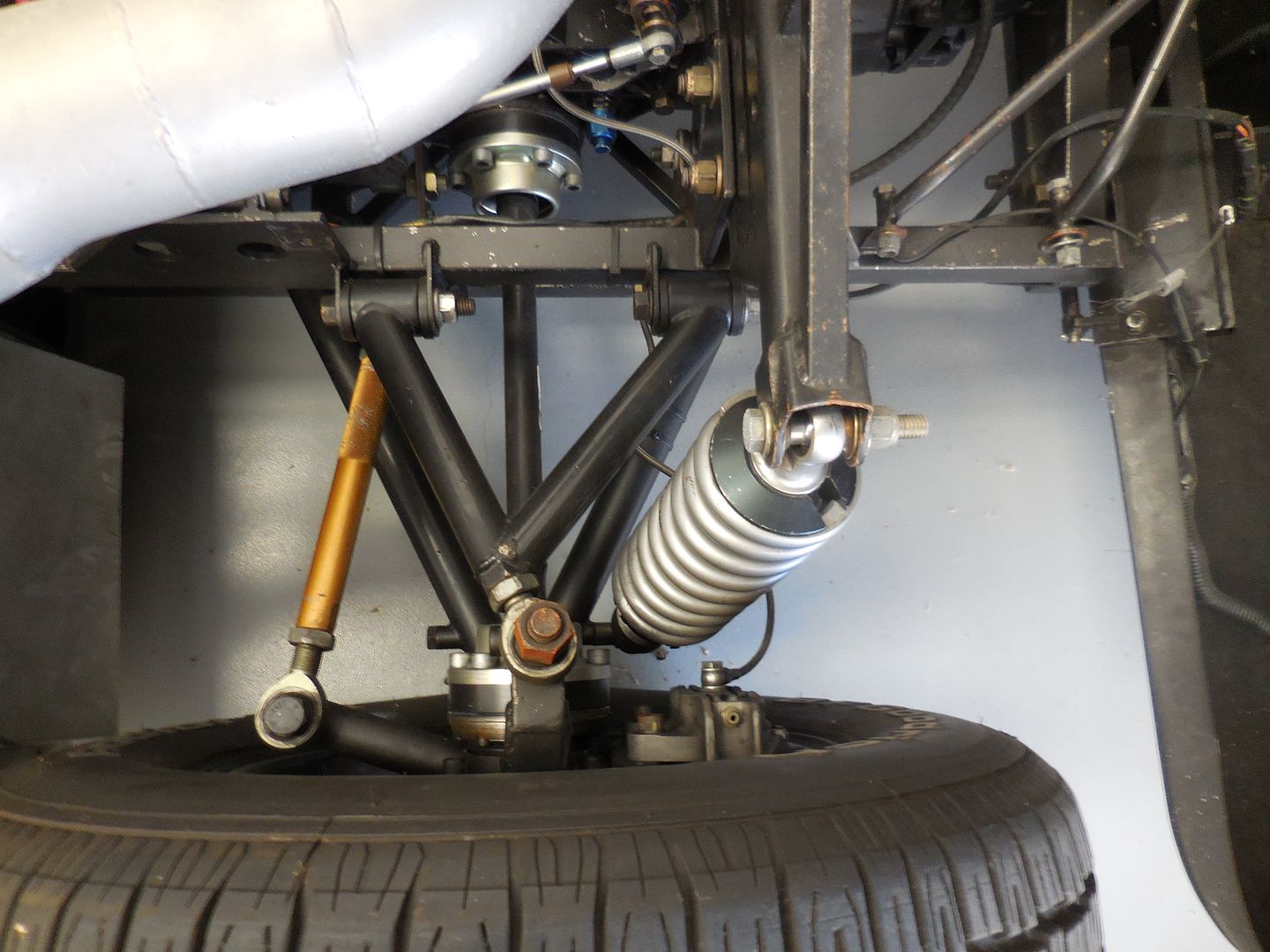

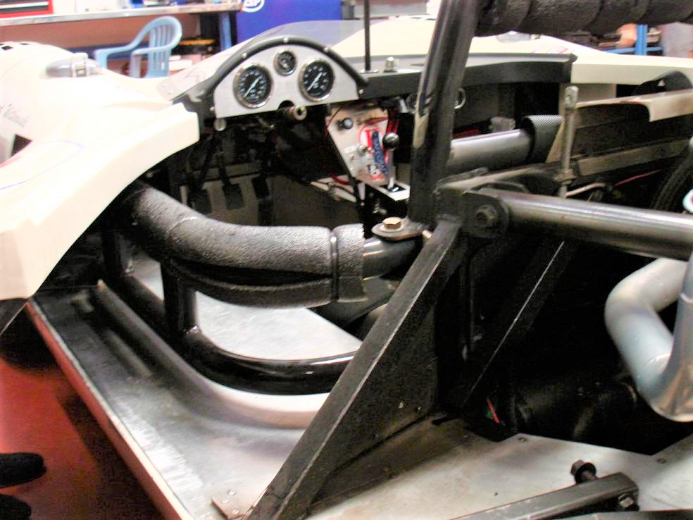

Brian - I don't have too many images of the chassis, as the restoration work is being performed in Cumming GA. Here's shots of various areas of the chassis, and one shot with most of the body panels removed. Apologies for the duped photos:

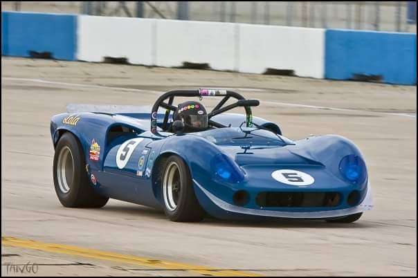

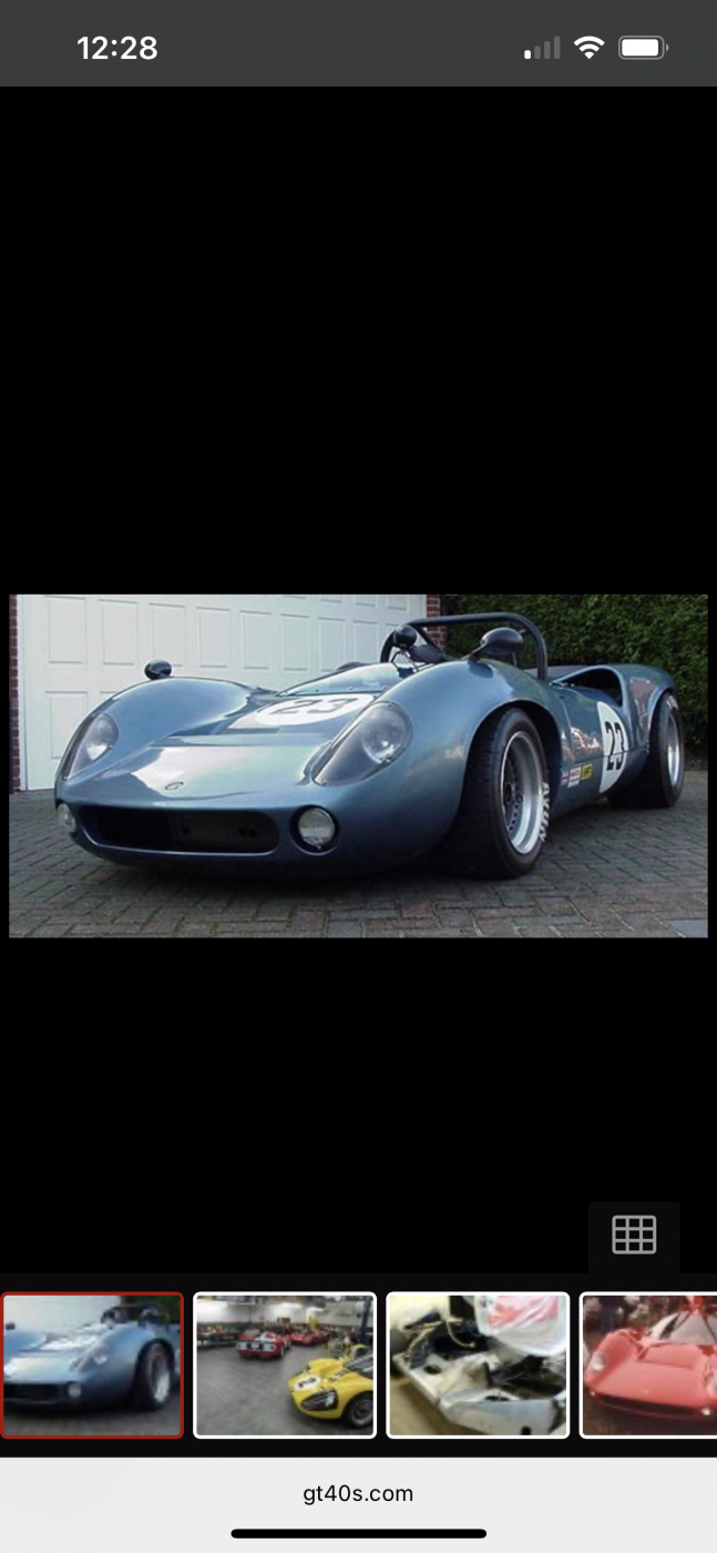

my old car…
I bought everything from John Guyan. Still have 1 of the 2 original chassis produced by Heritage Engineering in the UK. Sold the other one (car pictured above) to a friend who turned it into a coupe. Your chassis was actually produced by John Guyan and bodied as a red Spyder. Another friend of mine bought it and I provided the more authentic nose currently on the car.
@Johan - so good to hear from you! I have wondered about that second car for a while now. I heard it was racing in Europe - is that the case? Coincidentally, I am setting up my Lola much like you did - similar paint (Electric Blue metallic) with no stripes and 3 roundels. I was even going to give it the number 23, which is part of my wife's full birthdate, but you got there first, so now I may have to reconsider. I notice you got rid of the knock-off wheel spinners and went to single center nuts - I am trying to do that now - any tips on parts, etc? Looks like you primarily raced yours - did you run vintage or? I will run some vintage races, but my primary use will be street. I have owned Caterham Super Sevens nearly my entire adult life, so I understand well the exposed driving position, light weight and extreme power-to-weight ratio. I was aware that my car was originally red - I have the issue from Kit Car mag that featured it on the cover. One of the car's previous owners told me that the hood on my Lola was originally from Huntingdon - is that true? The owner I bought the car from, Ron in Georgia, also sold me an entire spare body - the nose looks the same, but maybe I am wrong. I am saving the pictures of the sister car you included - thanks for those. I'll take others if you have them.

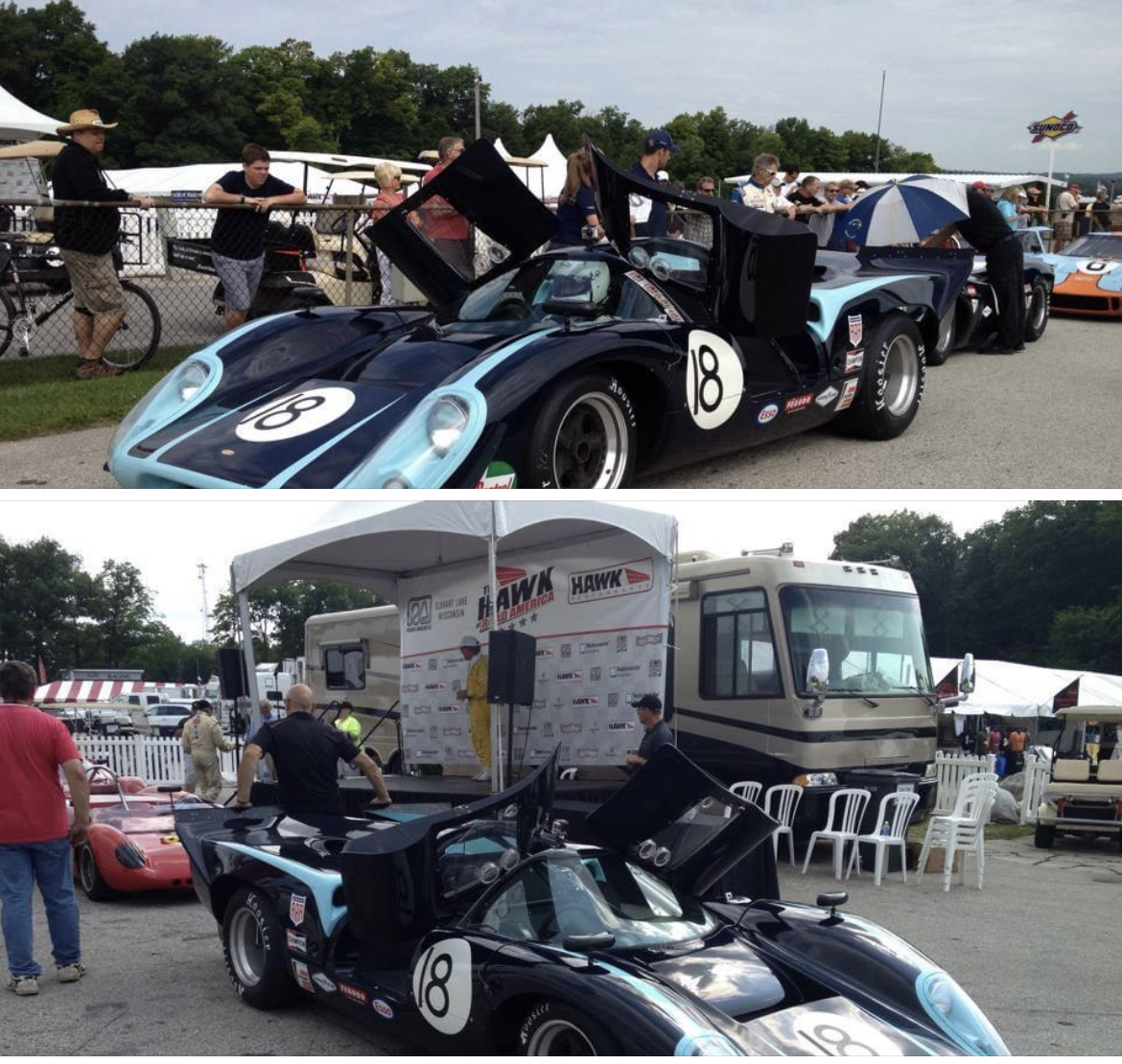

this car is the same car as the blue 23.
this car is now the coupe above.
it has always been a race car and is the original Heritage Engineering T70 when it was the Blue 23.
highly developed with Hewland and big HP, great brakes, etc.
I have no use for parts for this car as I sold it many years ago to the guy who turned it into a coupe. He has it currently for sale with Olthoff.
