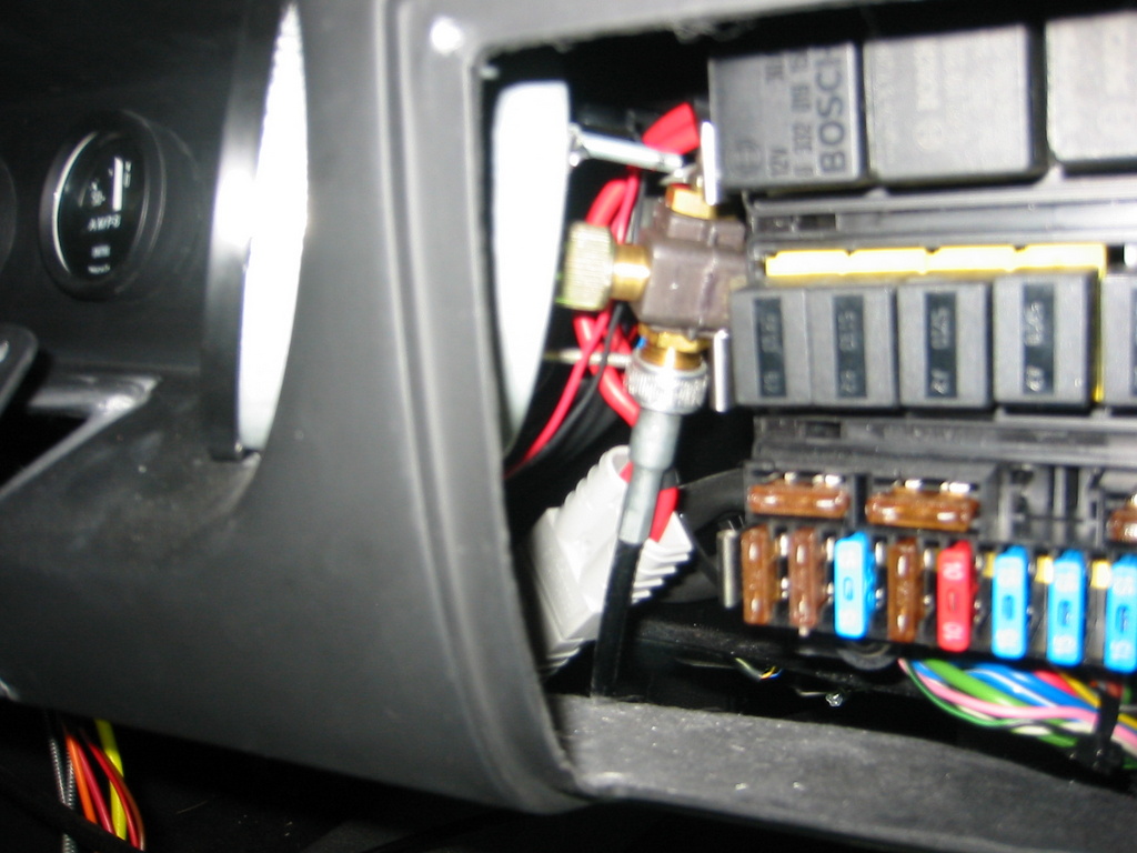

I'm still not sure whether or not:
a) The ZFQ and Smiths factory speedometer will work correctly (even if not calibrated) without adapters, and
b) Will there will be an adapter on the back of my speedo, should I dig into the dash?
Surely someone would know something about this combo.
Can't tell you how well it works with adapter(mine worked poorly without) but in 30 secs you can pull the fuse cover panel, stick a flashlight in there and see if you have one.

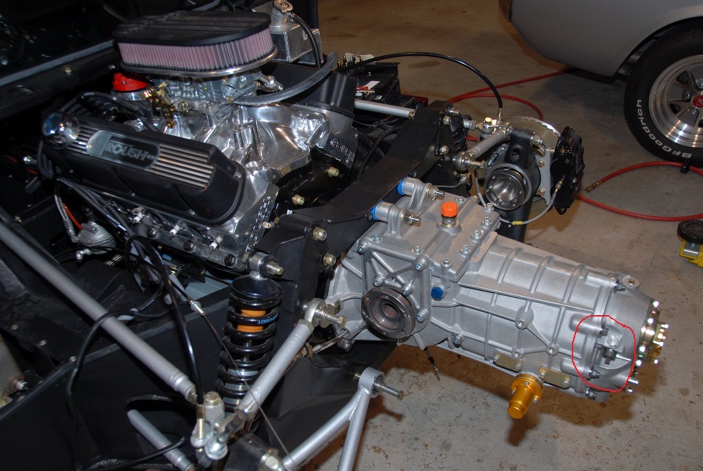

The one at the back is only needed to adjust your speedometer readings to your rear axle ratio.The ZF's have a about 10 different ratios to pick from, from 3:20 to 5:13. Not sure about ZFQ. I think mine is a 3:80 but I'm not sure about that either. My speedometer didn't work long enough to see how accurate it was.
Unlike the old cars we are used to there isn't a little plastic gear on the end of the speedo cable the sticks into the trans that we can change. Yes there is a gear just inside the transaxle but as far as I know you can't change it. Maybe we should talk to Quaife about that.
