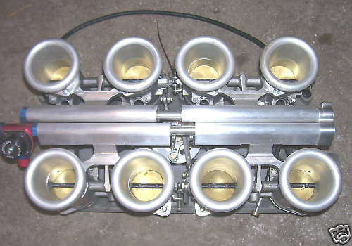

• TWM 50mm IDA THROTTLE BODIES and MANIFOLD

you need to select the cam arround your TWM setup or the motor will be awfull. We are TWM agents so have been through all that, give me a call or PM and I can sort it out for you.
