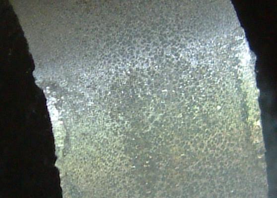

Maybe someone cam comment on the finish of cam lobes. I have just bought an Edelbrock Performer RPM cam.
1) there are some pits on the journals - not terminal
2) also slight scrathes and pits on the lifters
3) worst the edges of the lobes are not ground but have feathering
(see photo) its not too clear as I squished into the 50K limit. What happens if one of these nasties comes off? Can I grind the edges myself or is this dangerous?
I have more pictures which I will append using a URL to my website.

I just had a new one in the garage from Isky and it didn't look like that at all. It was smooth, radiused edged, etc. I vote send that thing back, I wouldn't run it.

I wouldn't put that in my lawnmower! /ubbthreads/images/graemlins/shocked.gif Send it back! And demand that they pay shipping /ubbthreads/images/graemlins/mad.gif , both ways!
Yikes! I wouldn't put that thing in my lawnmower! /ubbthreads/images/graemlins/shocked.gif
Send it back, and demand coverage for shipping! /ubbthreads/images/graemlins/mad.gif
Jim Rosenthal
It does look like it missed the polishing machine. A sobering thought when you think of how many cams they sell. What I think they ought to do is send you a new one.

Well I took the cam back to the supplier. They said that they would install it in one of their engine builds but even so my concerns were understood and they would give me a refund. However we then looked at some other cams as an alternative.
Firstly another Edelbrock to compare, it was exactly the same finish, with rough sides to the lobes. Then he opened a Comp Cams and this was again the same finish - in fact it looked near identical with the same stamps "CWC EP15". Obviously from the same source.
The guy at the shop also said that they have had lobes with blow holes from the casting and had to send these back. Edlebrock are not keen to accept returns it seems and their quality control is poor.
So at present I have kept the cam. Frank Catt has confirmed this quality is par for the course.
I have already ordered heads, intake manifold and timing set and now fear for the state they will arrive in. Has anyone else had similar issues??
I have seen cams with a parkerized finish which is supposed to be used in break in to hold oil, etc. Not sure if that is what we are looking at here. The pit is deffinately a problem. I have seen several cams with rough lobe sides.
Most of the ones I have seen have been Comp Cams.
