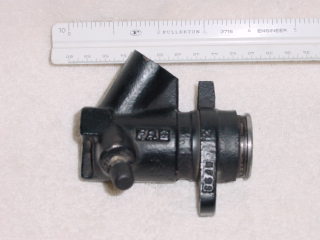

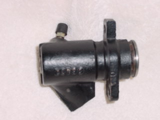

Here are two pictures of my clutch slave cylinder. It mounts to the bell housing of my Renault 5 speed UNI trans. I've been to a couple parts warehouse people that can't find a replacement. The only numbers to reference on the unit is 'S6432'.
If anyone can help, I need a part number and/or car it can be referenced to. I will call Andy at Tornado if all else fails but I'm counting on you guys. Thanks in advance.

the clutch slave cylinder is from a renault 21 turbo both series 1 and 2 the cylinder was fittted to virtually all the rennault 21 turbos and is fairly common it can still be purchased in the uk for around 25-50 gbp depending if you go to someone like bettaparts a hydrolic wheel cylinder supplier we use or delphi from another supplier i will find out the part number and post it here if you have problems locating one in the us give me a pm
chris parker
Chris, I was told when I got mine that it is not from a 21 turbo (Renault garage) - it is a renault item but not sure which one. Should be about £120 from what I remember.
