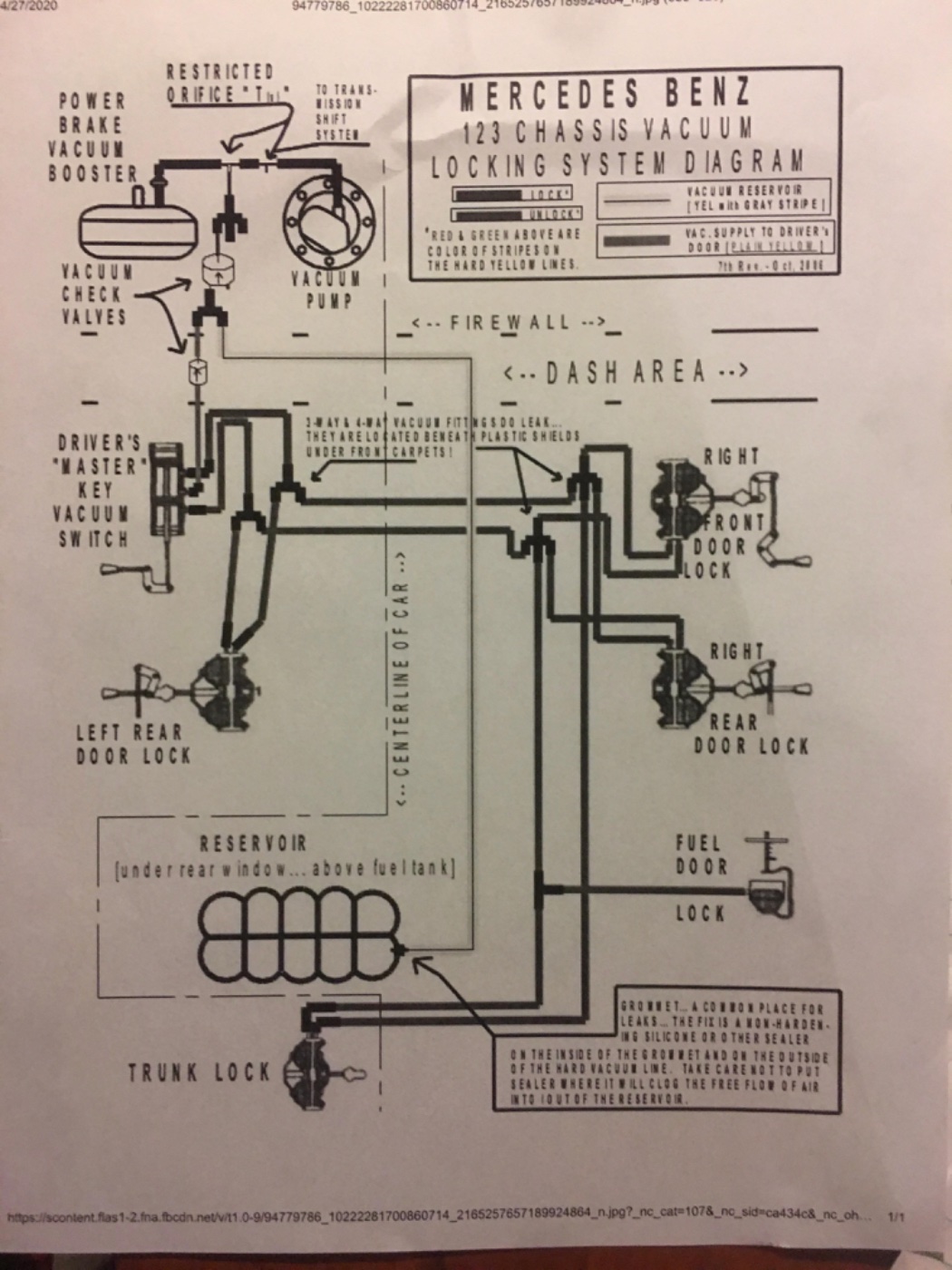

By pure expérience...... the doorlock system on those Mercedes are functionning on vacuum principe, un locking locking all operated by vacuum...and the whole sport in this kind diagnose is to find the leak... where the atmospheric pressure gets in the system... and it is an invisible leak.....
same principe in Electric diagnose ... isolate every hose organ and apply vacuum pump on each element, to find faulty one...
other sample
Thank you Paul, that's helpful. Yup, it's a funny thing on those cars - the vacuum system controls/affects all kinds of things...including the transmission shifting. I've tracked down a couple leaks already and things are getting better...but I'll keep at it!

in the warm area (engine bay....under chassis near exhaust etc)of the car, the rubber vacuum hoses getting brittle, and cracks, seems ok, but under vibration (road/ engine ) they let atmospheric pressure freely getting in... no noise no leks...
other thing, engine running and stepping on the brake pedals and you hear hissings near the pedal....
