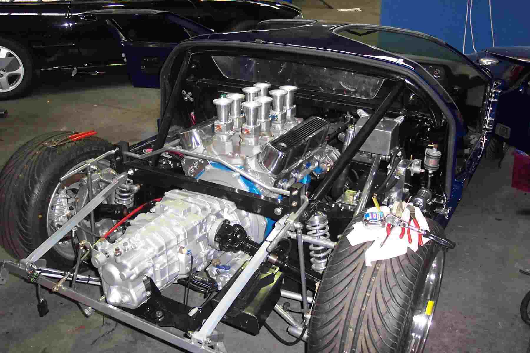

Not sure if it helps, but here in Oz we have to have one to meet the regs for rego. Mine is from a Holden Monaro (the new Pontiac GTO in the US) & is mounted under the rear RHS clip strut. It is the black box just behind the RHS driveshaft in the following pic & I just have the 2 lines from the tank filler necks t-connected to a common line going into the cannister. Purging the cannister is controlled by one of the ECU's aux outputs & initially set to purge if rpm's exceed 6000. This is ensure that the damn thing doesn't dump right in the middle of the dreaded RTA emissions test ! Later on, we'll pick some more sensible parameter / setting.
Kind Regards,
Peter D.
