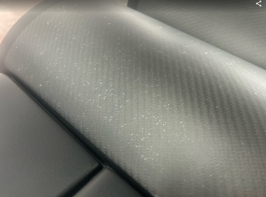

Carbon Dash - air pockets in gelcoat
Anyone else deal with this on these SLC carbon dash's? I am just curious if this is a common deal. This is after the dash has been painted and the soft touch coating applied. I noticed them when I first received the parts long ago, but when the parts are shiny they aren't as noticeable.

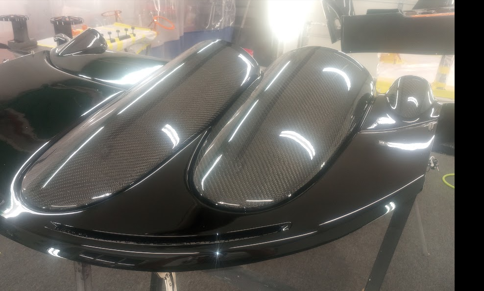

Here is a pic of the part cleared before the soft coatings was applied. They are noticeable, but the soft coating definitely magnifies them. Trust me they are there, but the gloss hides them much better.

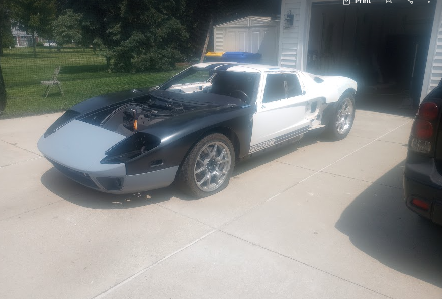

Ryan, which soft touch brand are you using and what is your experience with it? I’m debating doing my GT40 dash and possibly other interior surfaces in black.

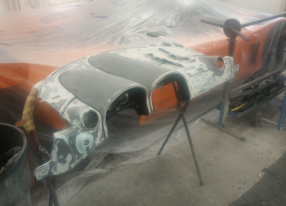

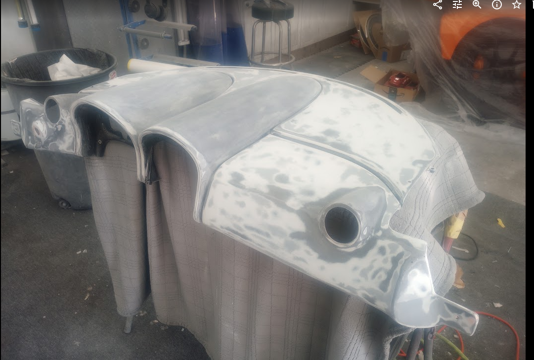

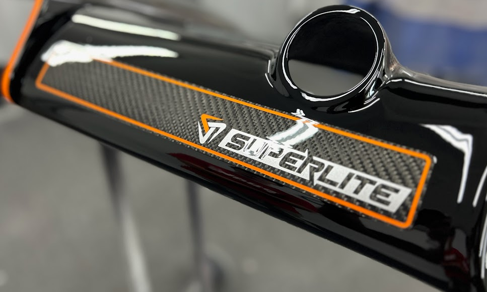

Figured I'd share this experience. Had to strip this gem down to nothing and redo it all, fun stuff.

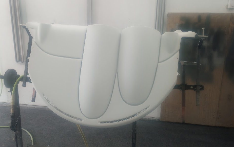

Re-did all of the bodywork and primed it.
Sanded and a final coat of black epoxy

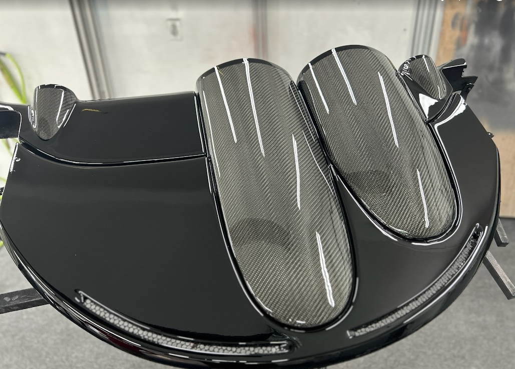

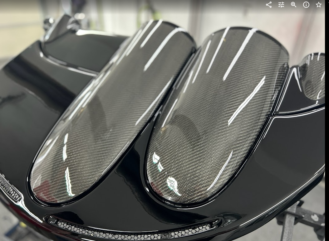

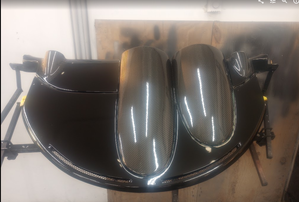

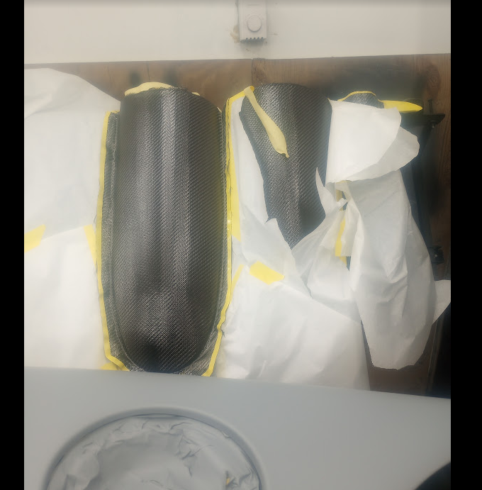

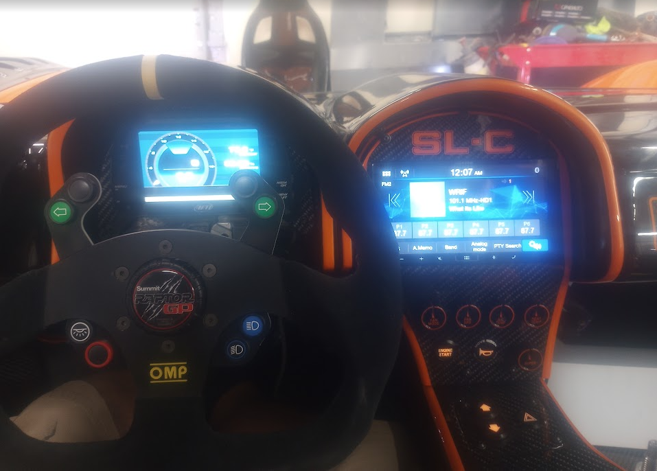

New carbon layer and a clear poly topcoat. Had to do it in sections so it took a few days.
Takes 2 rounds of clear poly, but its a nice product and fills great.
Agreed - you are going to hate life with the reflection - my 917 has a titanium hump for my digidash. I love it but the reflection is such a SOB to deal with. Dashes should be matt.
Also, to answer your original question, my carbon pieces (front splitter, side skirts, and rear window) have little pockets like in your first picture ... other than cosmetic the pieces have been fine for almost 20yrs
Hector
fantastic end result !! But I agree that the reflection is going to be a problem. I hate to see the hours and the price on that job!!!
I did it with one piece of leather and it was extremely difficult.
Looks fantastic, just beware that you will get a bad reflection in the front window with that gloss finish.
polarized sunglasses are essential in these situations, a good pair will erase that reflexion. not a great solution at night though...

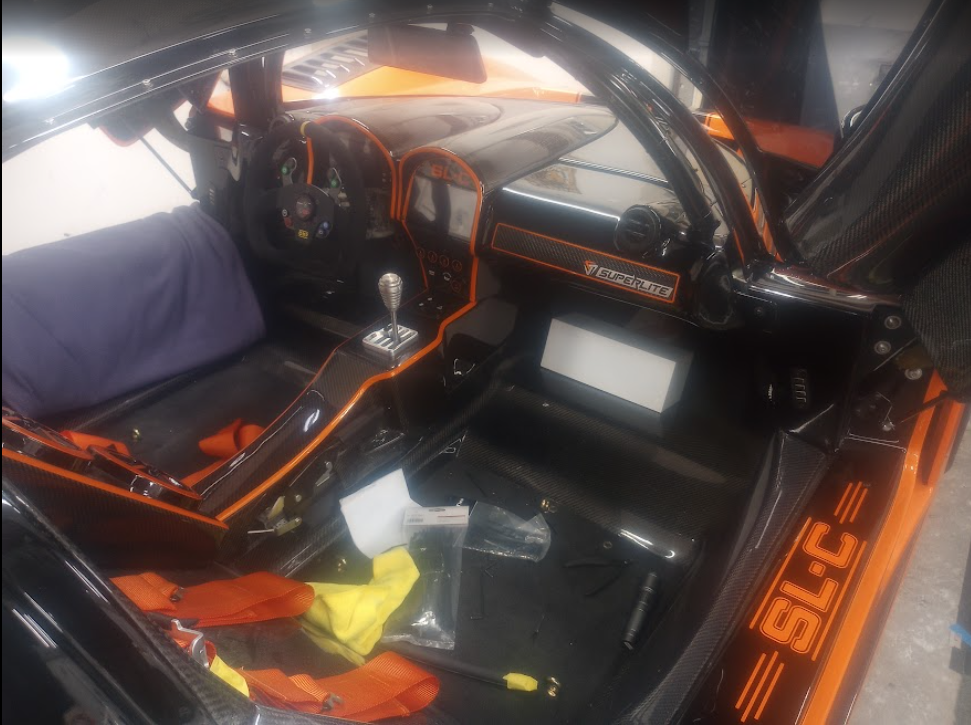

The customer is aware of the possible glare issue. Got it installed last night. A-pillar pieces aren't even in the realm of fitting. I am kind of shocked(well not really) since I was given those to paint years ago. Was hoping they would have been fit. Oh well, its only my time. That will be a project for another time. Right now this thing just needs to get some miles on it. I may suggest some matte finish PPF on the top of the dash in areas depending on the glare.

The A pillar covers will fit if you widen the front roll hope like many of us have done. The factory finally reprofiled the hoop a couple of years ago to address this problem.
That's hilarious!!!! Sorry, my frustrations with this car are finally boiling over.
I am just going to cut them up into little pieces, make them fit and re-do the carbon. Maybe next winter.

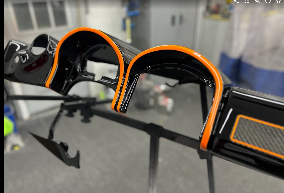

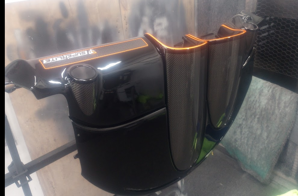

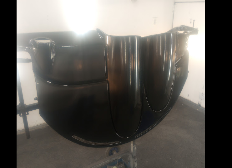

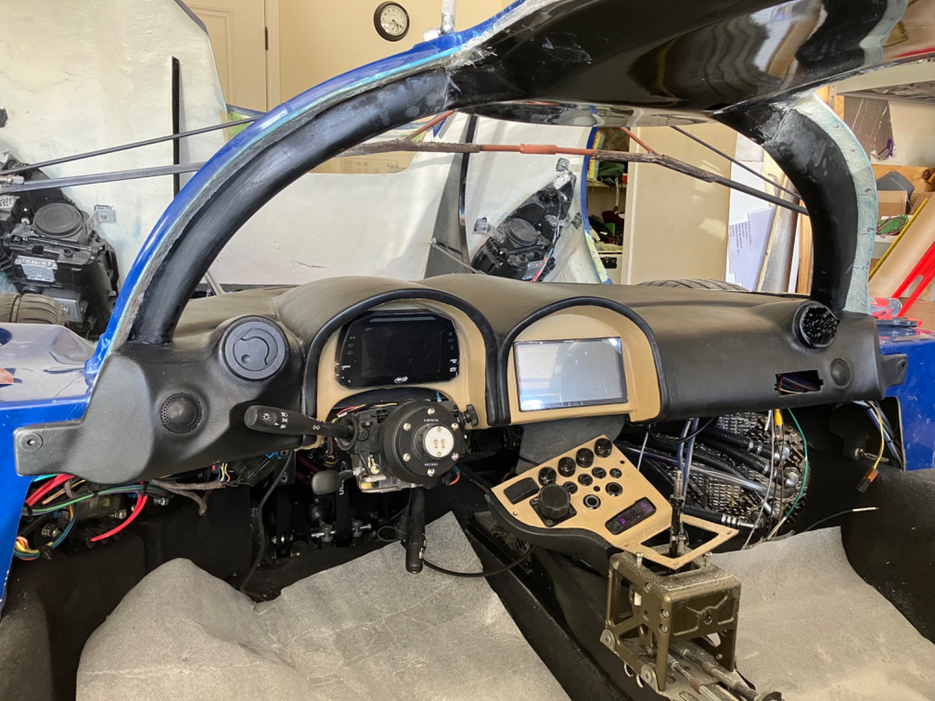

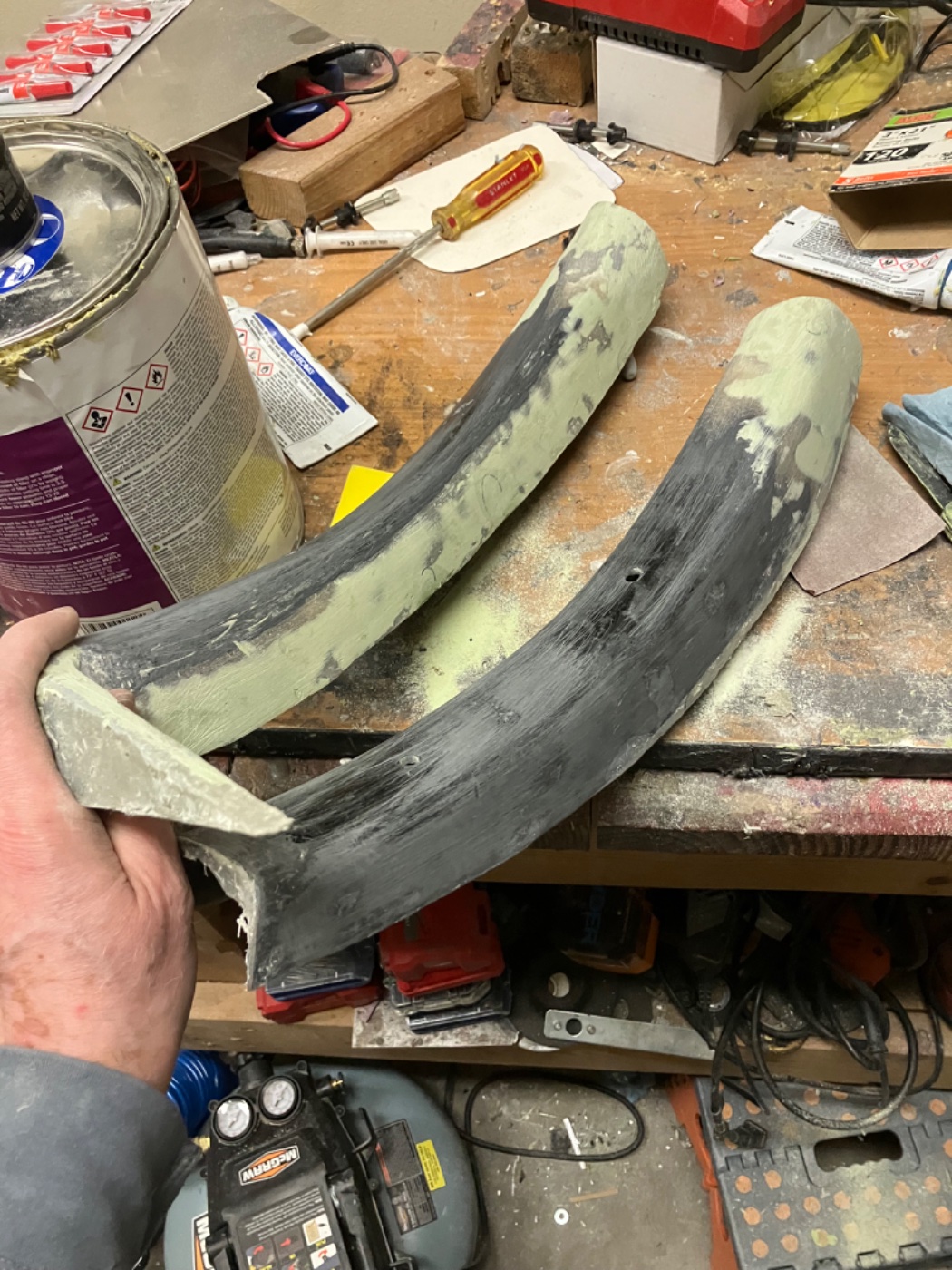

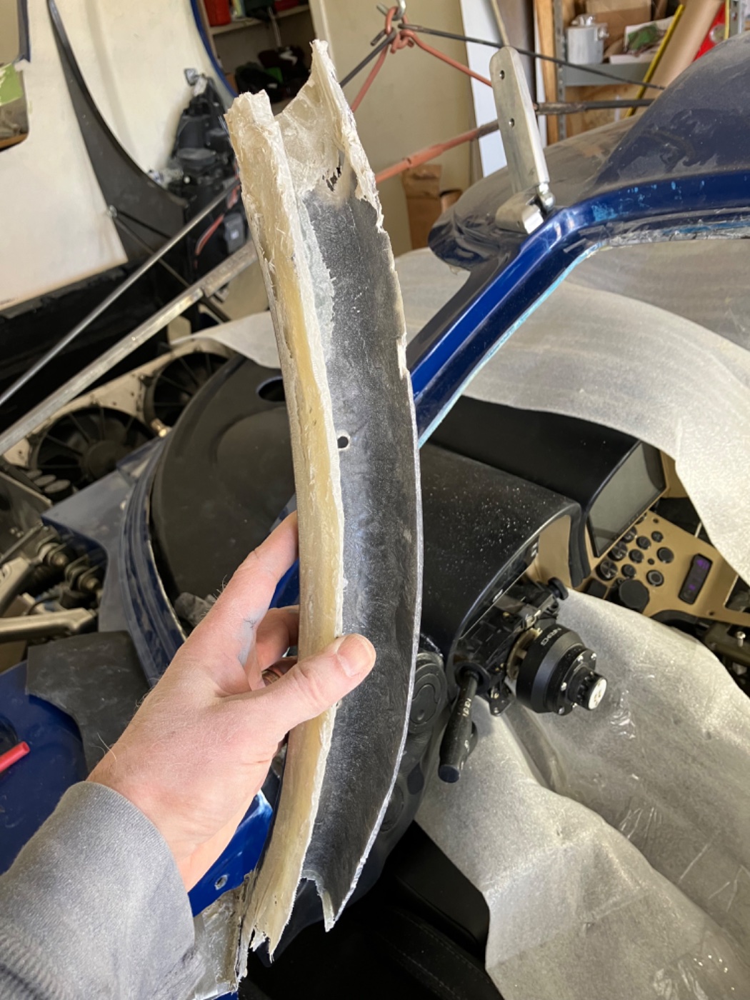

I bent and re welded the front hoop and completely re designed the A pilar covers. major job . Sorry to tell you . I absolutely hated the horrendoulsy wide A pilar covers. Nothing is easy or straight forward with this project, unfortunately. Hope this is helpful in the future when you are ready to tackle the project
