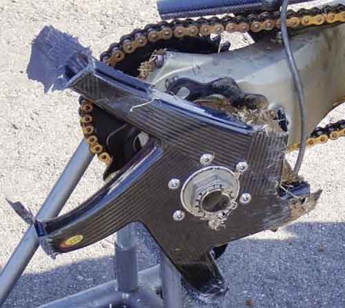

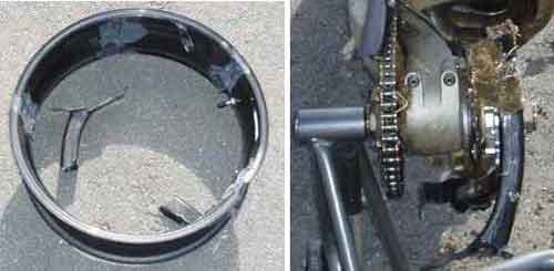

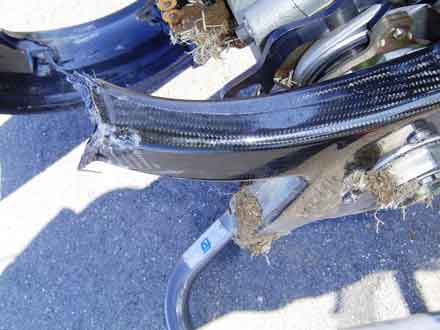

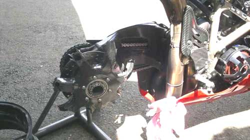

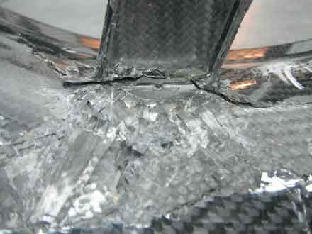

OK...here you go...absolutely no confusion here

BST has the best carbon wheels available for motorcycles. I raced for 12 years and had sold a few sets through my shop over the years. I have never seen a failure, but I'm sure its possible. I have personally seen dymag failures. I've seen forged magnesium wheels fail similarly to the pictures above. Single sided swingarm wheels seem to fail far more than standard swingarm wheels.

Interesting that the single siders seem to fail more when the design of a single side motorcycle wheel is almost identical to a car wheel.

That's a Dymag Carbon Barrel/Magnesium Centre car wheel, note that the carbon fibre hasn't failed at all.
Note that designing FULL carbon fibre wheels for bikes and for cars is a different engineering story.
There has been many people trying to claim that they are unsafe, well... despite the numerous pics above we never get the full story and it's not like normal aluminium or magnesium wheels don't fail...
One of the 'failures' people proclaimed was on a car (dymag)...which crashed...into a ditch.... and again the carbon barrel was still intact and yet, people still used it to proclaim that they unsafe!
