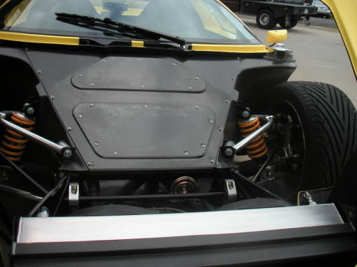

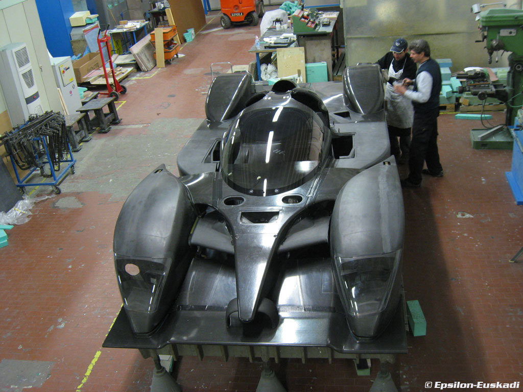

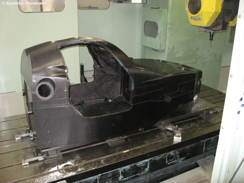

Actual Gt40 carbon one in the market have a good looking but they cannot be compared to these "real carbon tubs" due to the fact hard point and engine mounts are thru steel frames bolted to flat carbon pannels
These tubs are really nice and probaly very strong comparativly to a welded frame and the big interest is the interesting price compare to their nice look
