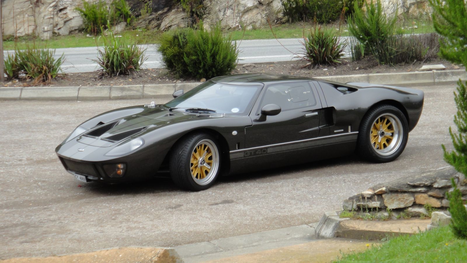

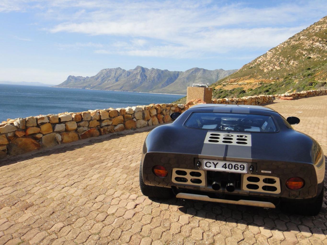

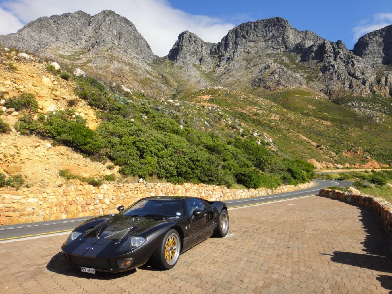

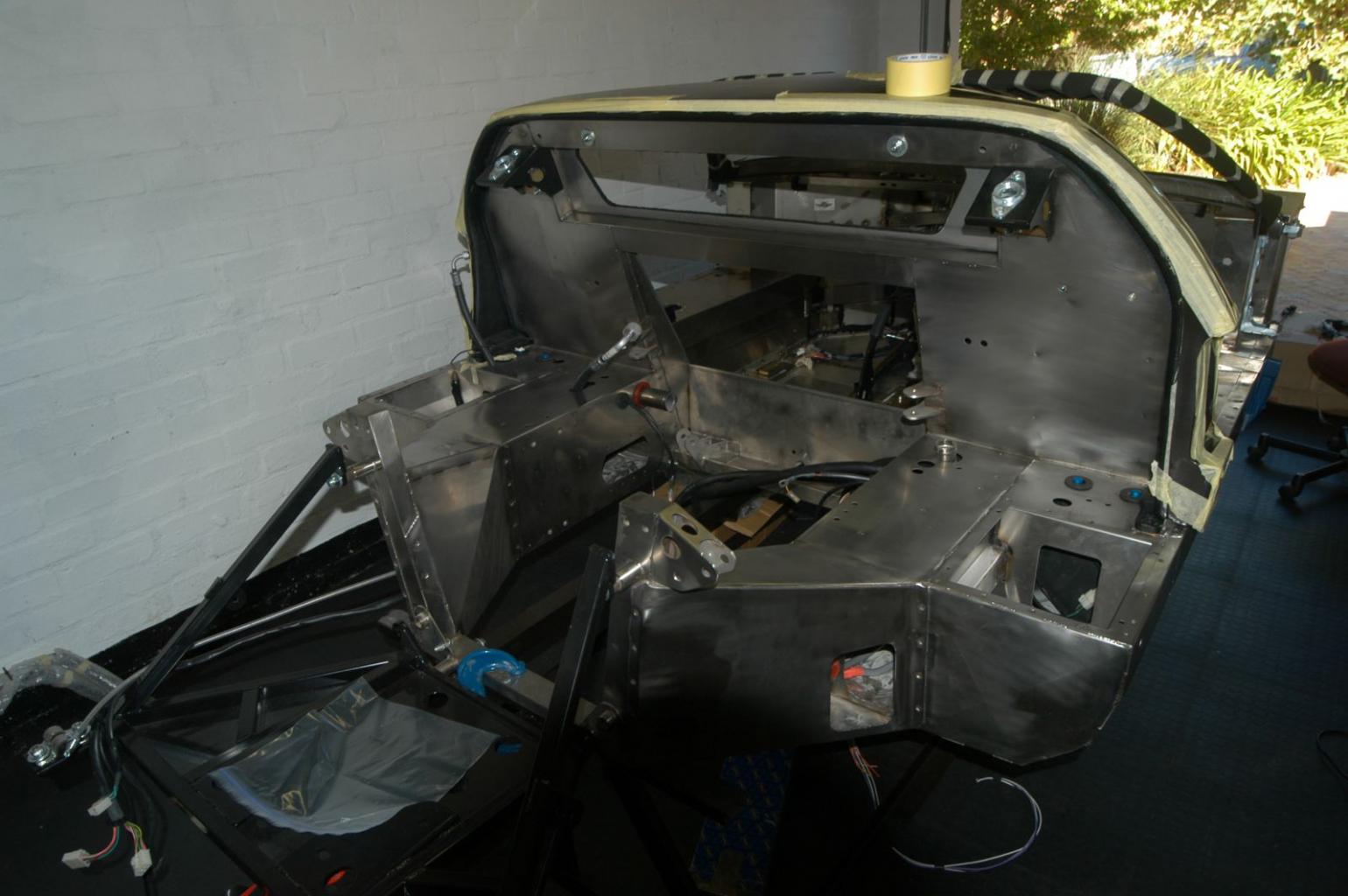

The thread under CAV went missing, so now I will post some of my pictures under General.
this is where it all started.
more.

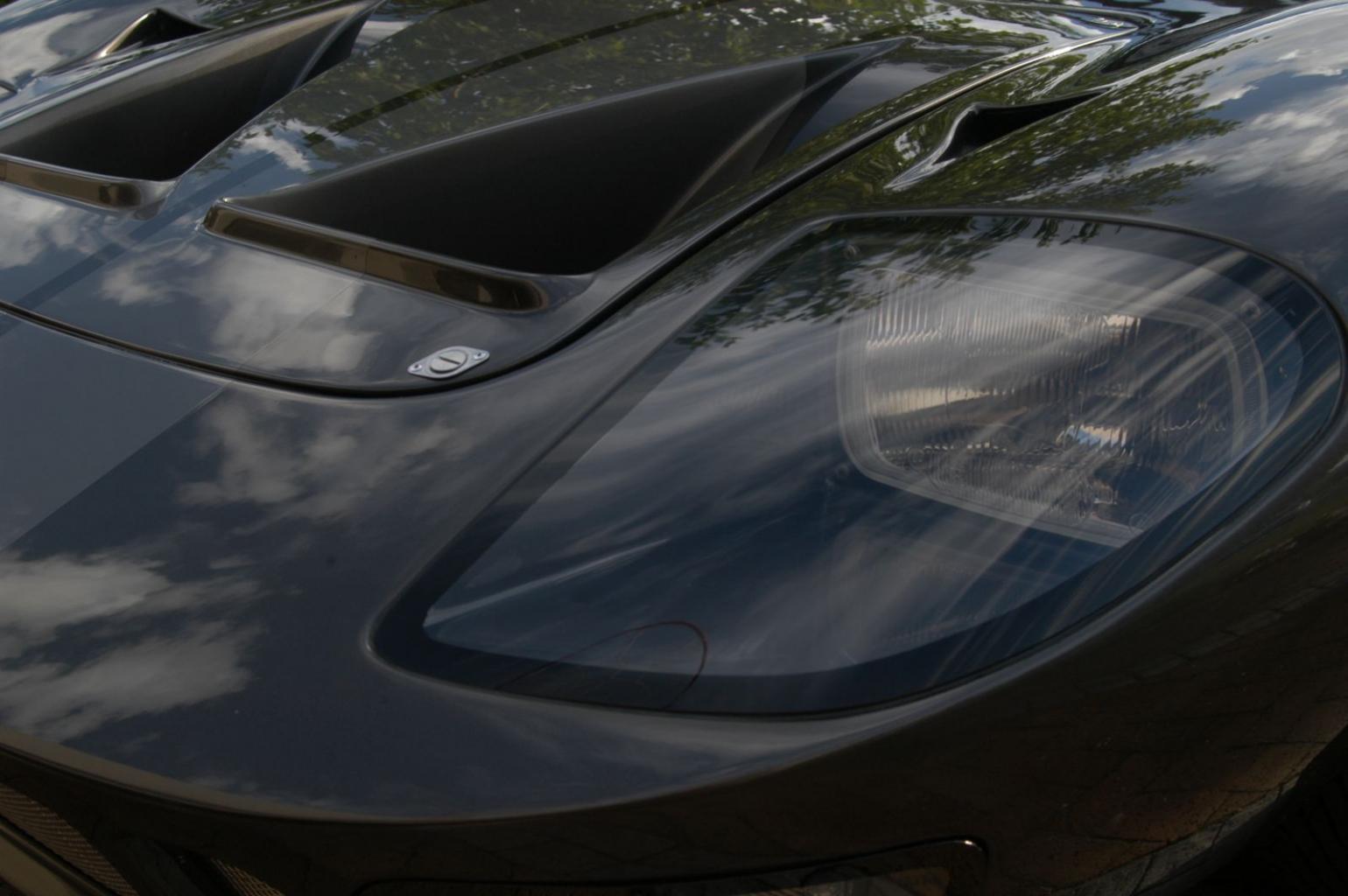

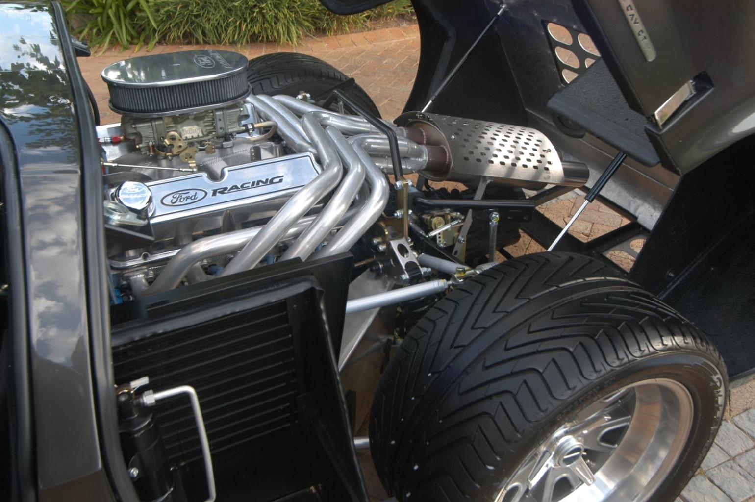

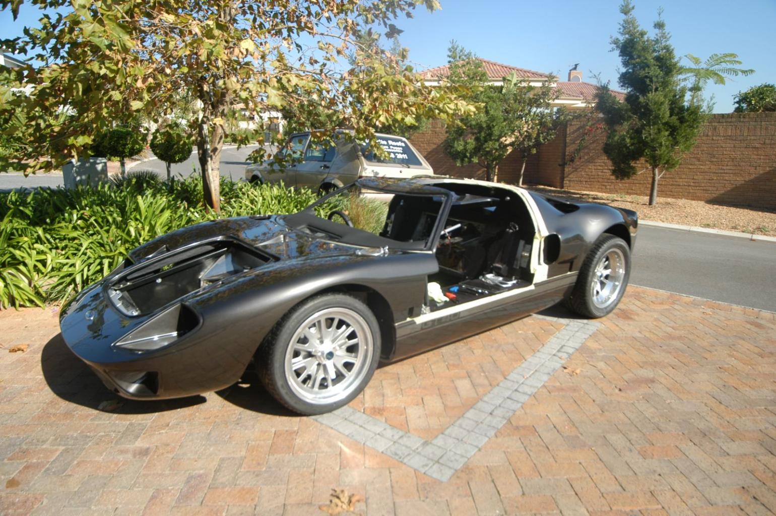

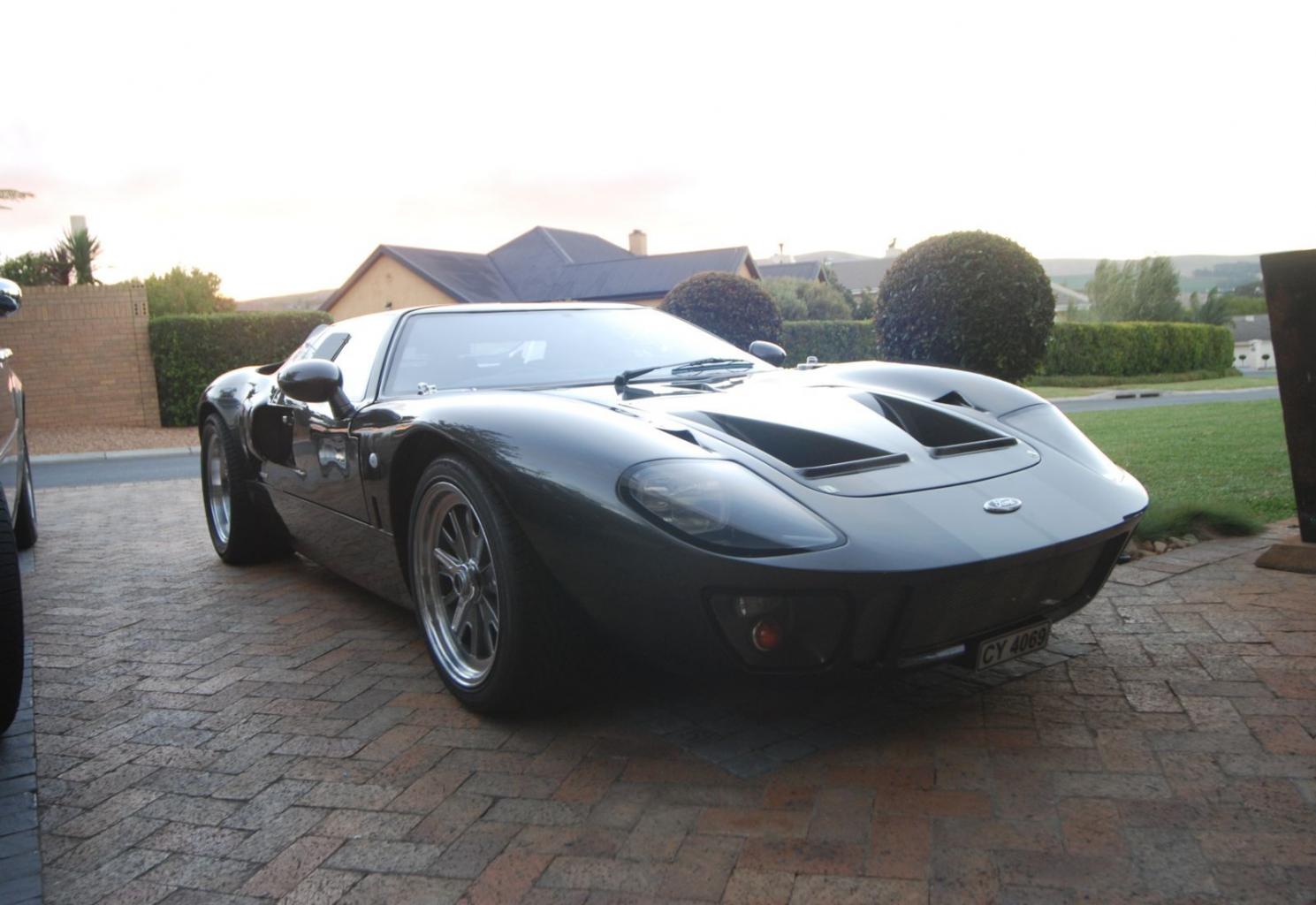

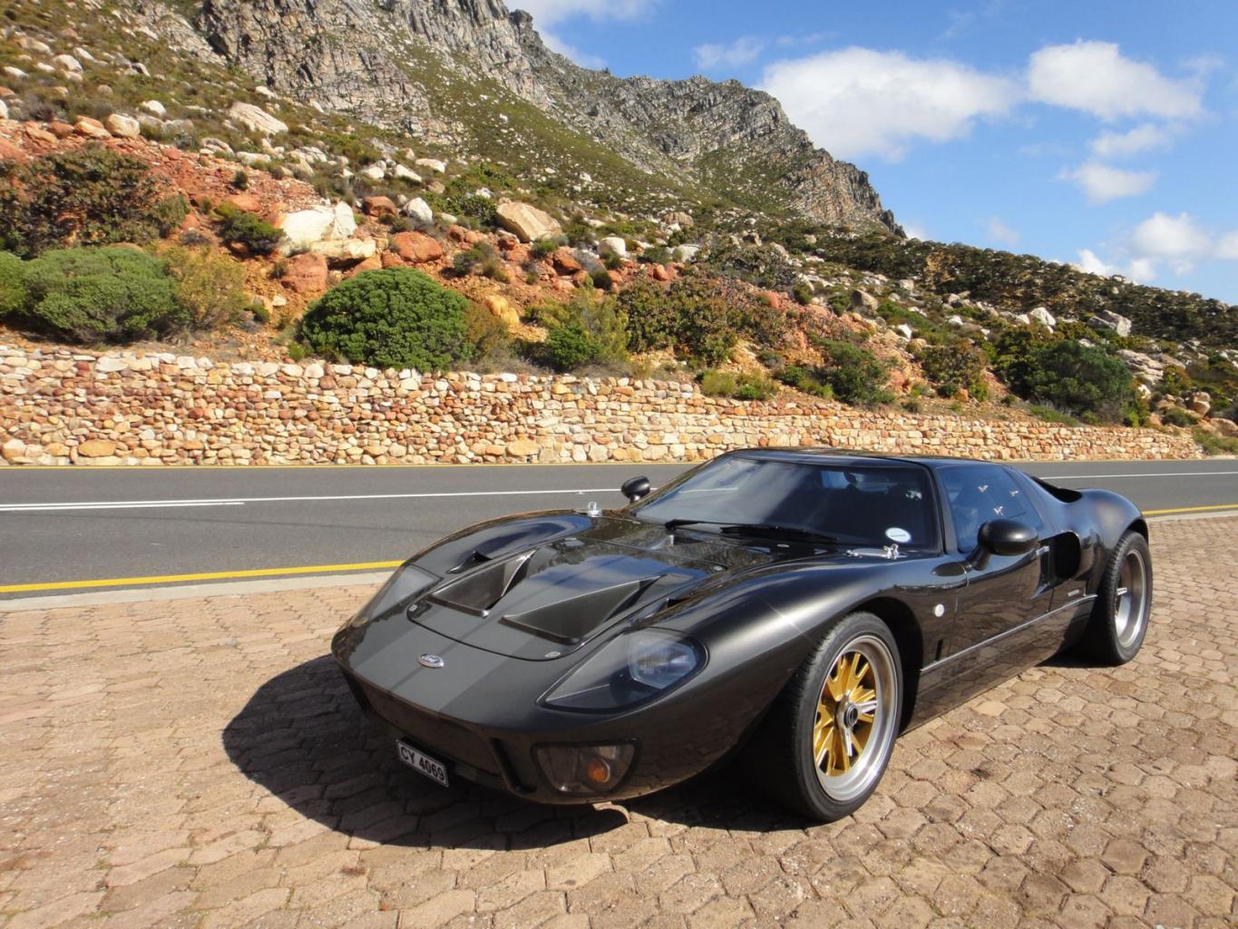

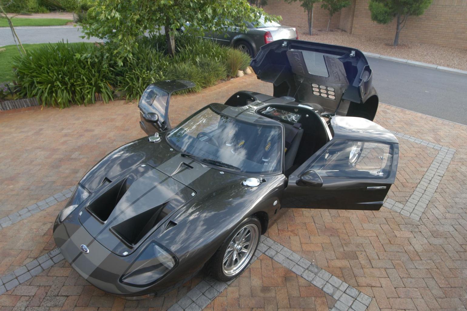

Your attention to detail on this car is phenomenal! I have a CAV #176 on order right now, it’s a full roller expecting Jan/Feb. How did you mount the windows and headlight covers? Looks like you painted a black trim (what kind of paint?) and used some kind of double sided tape??? How did you emboss the CAV GT on the heat shield?? This is great stuff the details are what makes this car special.
Thanks,
Alan
Hi Alan. I really tried to put some extra effort into the car. The side windows are all 6 mm aircraft acrylic windows that were routered and bonded. The same was done with the headlamp covers but that stayed 3mm. The embossing was done by putting cork sheeting under the heatshield. I did a lot more details and will post them. The black is Sikaflex primer.
