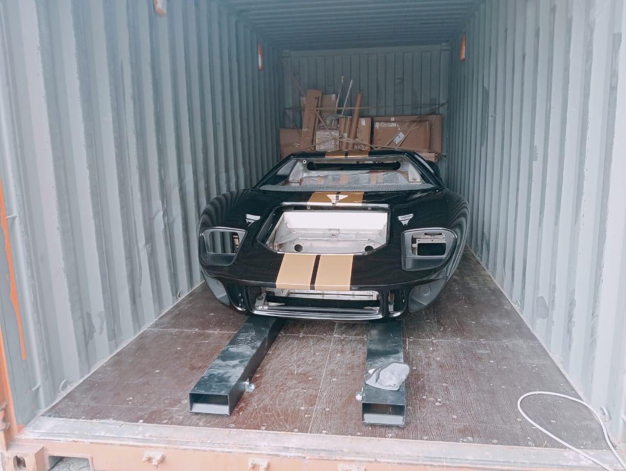

Hi, my CAV GT40 is now just 14 days from delivery.
Its on the way in the container from Cape Town to Norway.
I will share photos and progress of the build on my Facebook page.

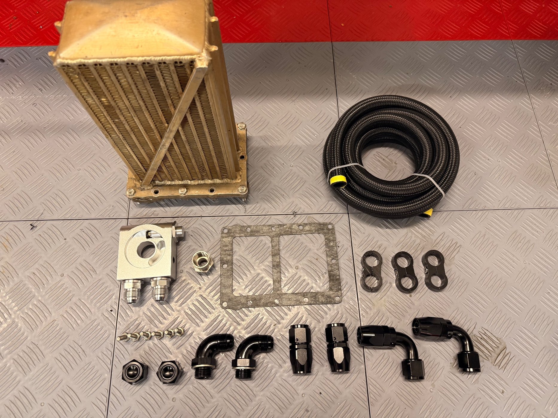

Continental oil cooler

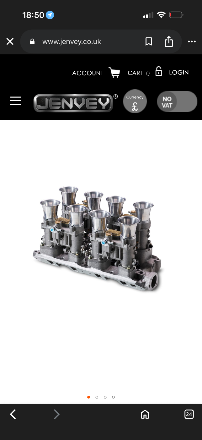

Jenvey 8 stack with Life Racing controller

And loading container Cape Town.

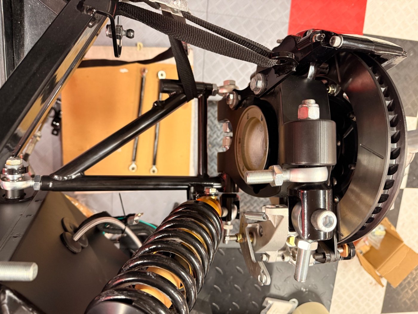

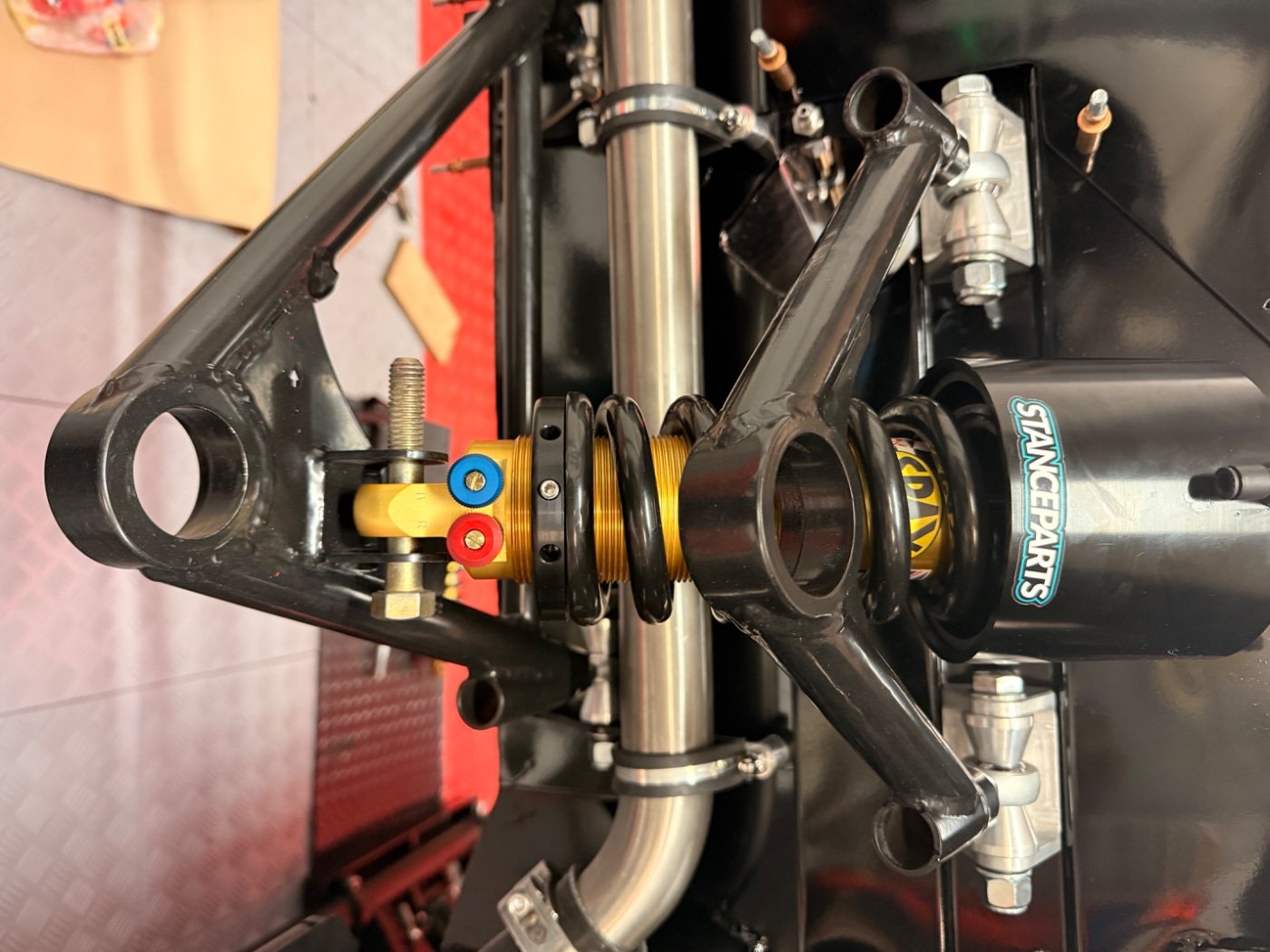

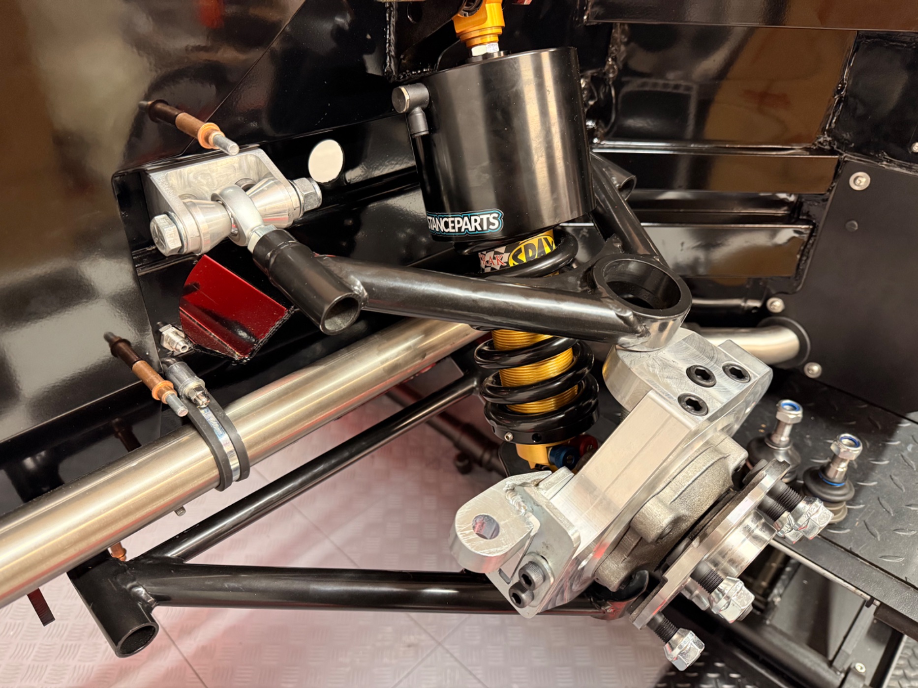

Stancepart front lift
Rose joint suspention

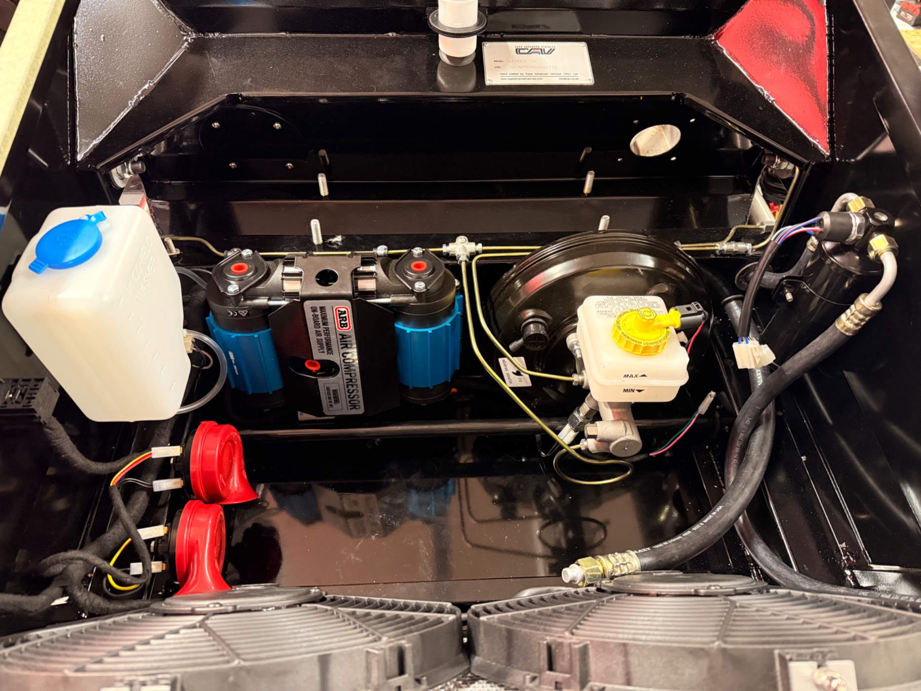

great to see another CAV with a Stancepart front lift.. I believe my CAV was the first one to be equipped with the system, did Jordy tell you about this or did you find it yourself? Love the color by the way!
Hi, i asked Jordy for a front lift system, a must in Norway. And he said they could fit Stancepart system. but had to rework upper Control arms.
Do you know if the system comes with the big airtank?
Hope i have the car in the garage in 7-8 days
I bought and installed the system myself on my CAV when it was back in The Netherlands. Let me know how I can help once you see the car 'in the flesh' when it arrives in Norway. I intentionally did not install an air tank, as there is very little (no) room for it. I instead installed a very fast double piston compressor. Without the airtank I lift the front in about 2 seconds, and didn't have to sacrifice any space for a tank.

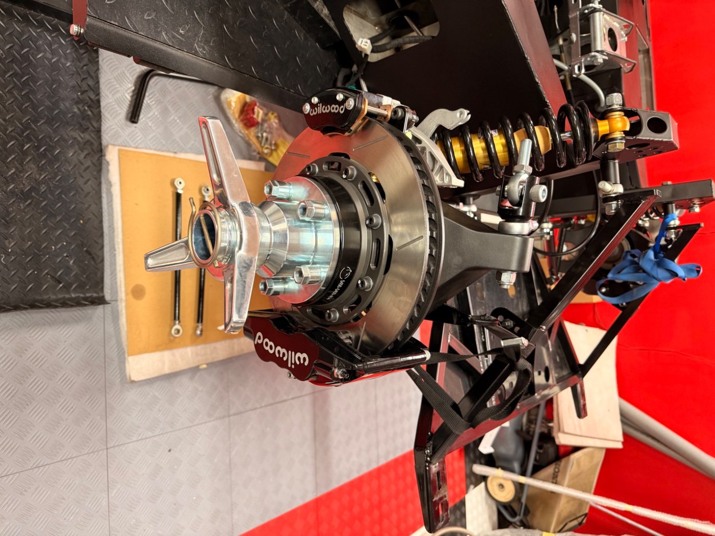

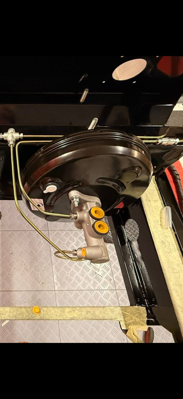

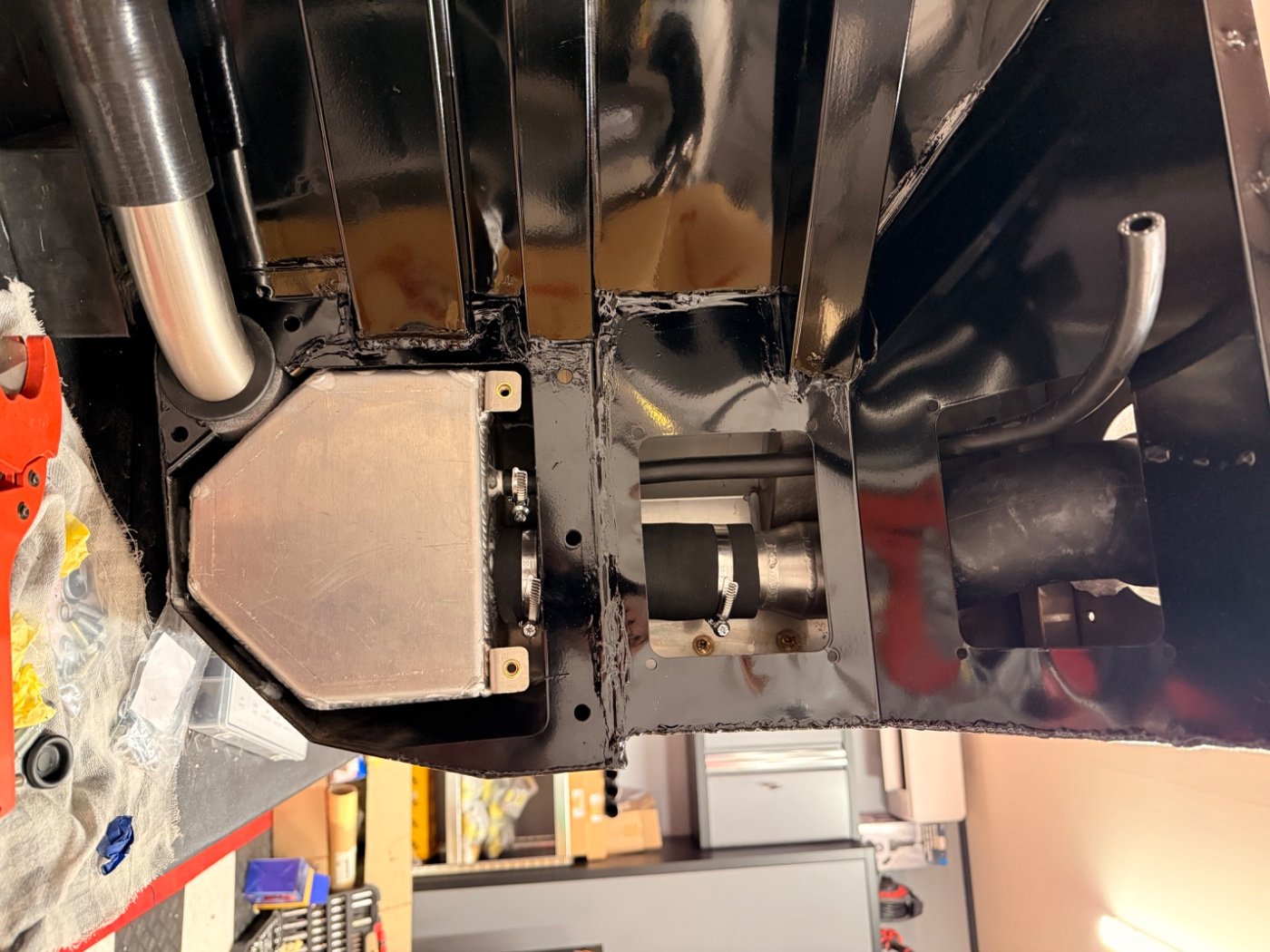

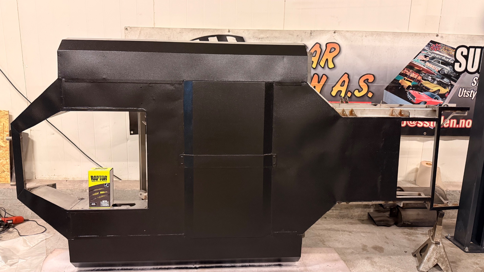

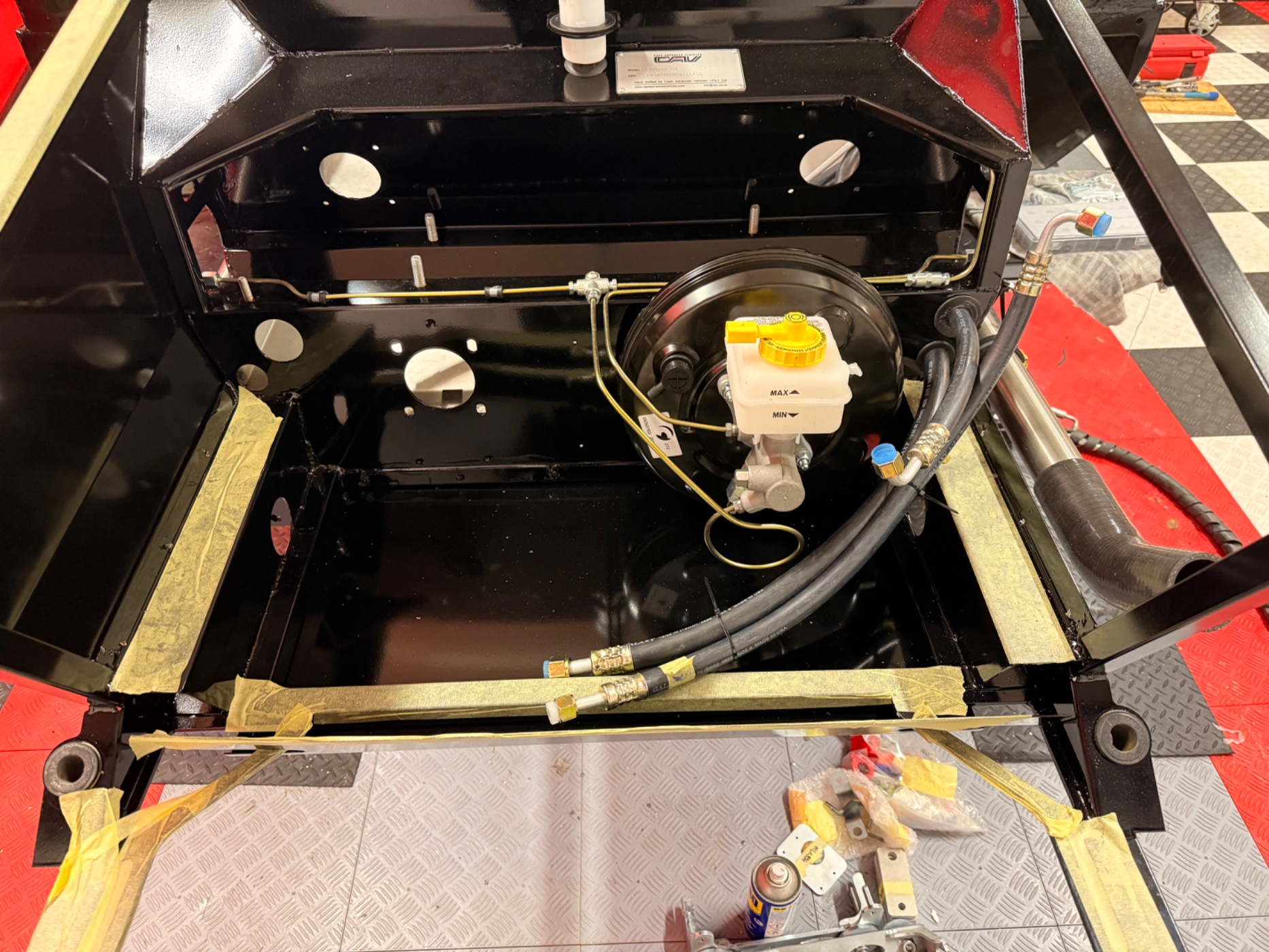

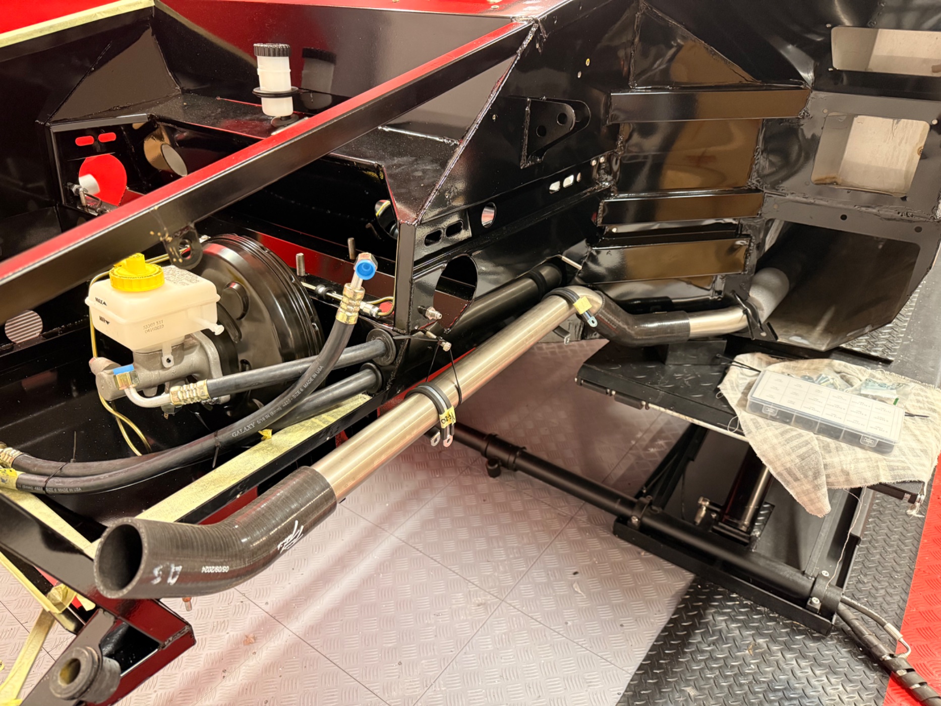

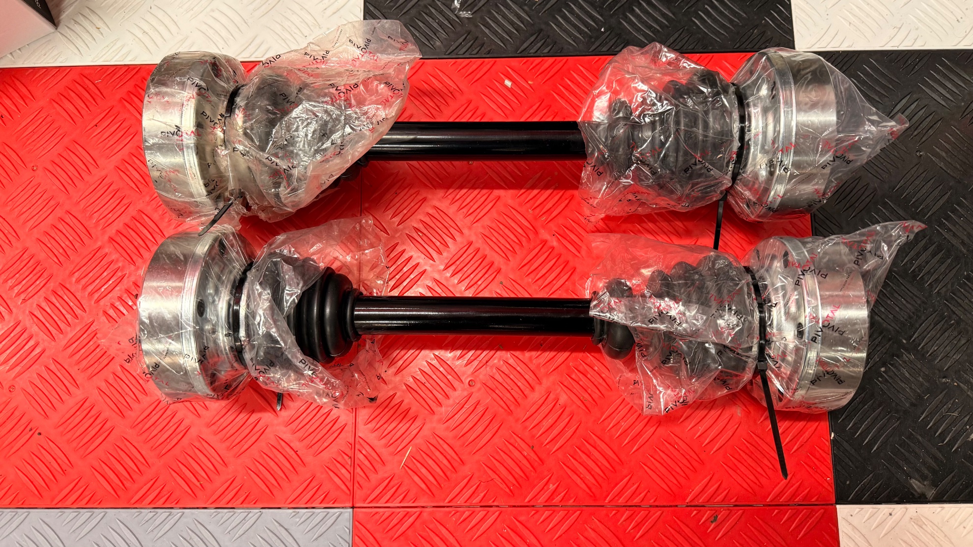

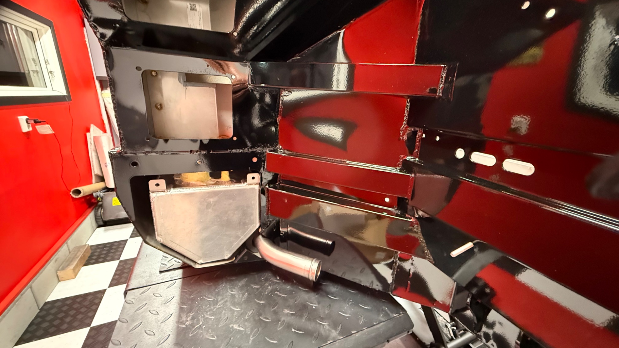

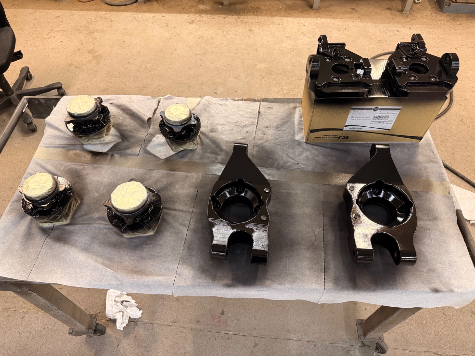

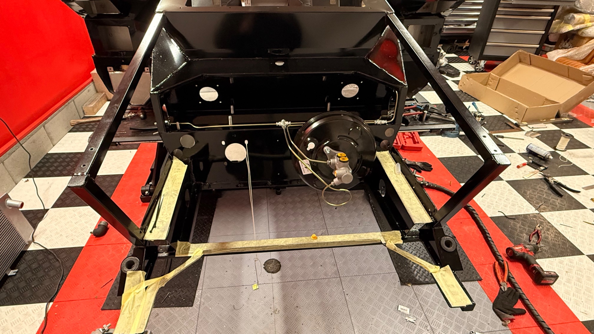

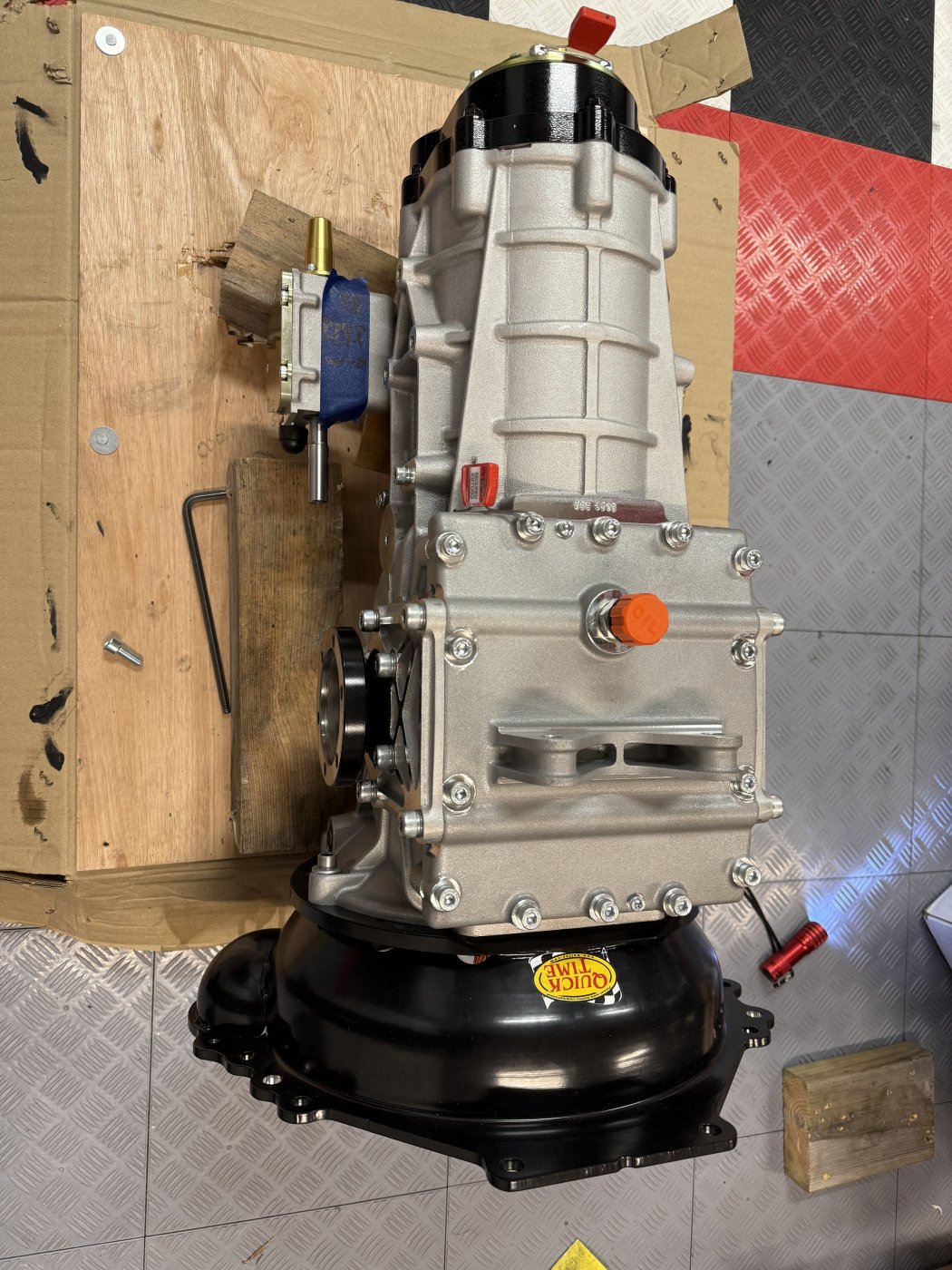

A little done every day. Waiting on some parts here and there.
