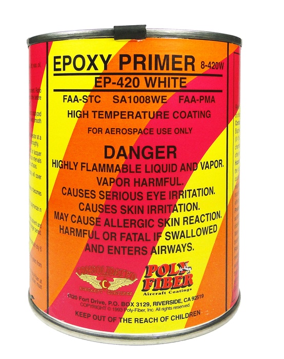

STITS EP-420 EPOXY PRIMER BASE WHITE This white heavy duty chemical and solvent resistant amine cured primer, the excellent primer from Stits is 0fast drying and corrosion inhibiting.

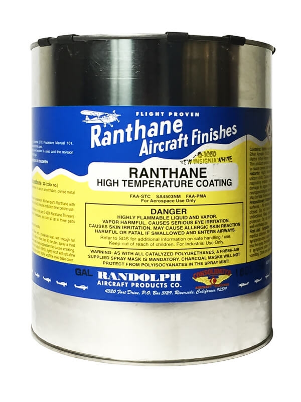

RANDOLPH RANTHANE AIRCRAFT COATING Ranthane Aircraft Coatings. Ranthane requires three separate components (which are separately) that are mixed before application. All three components are required and cannot be substituted: Ranthane polyu
