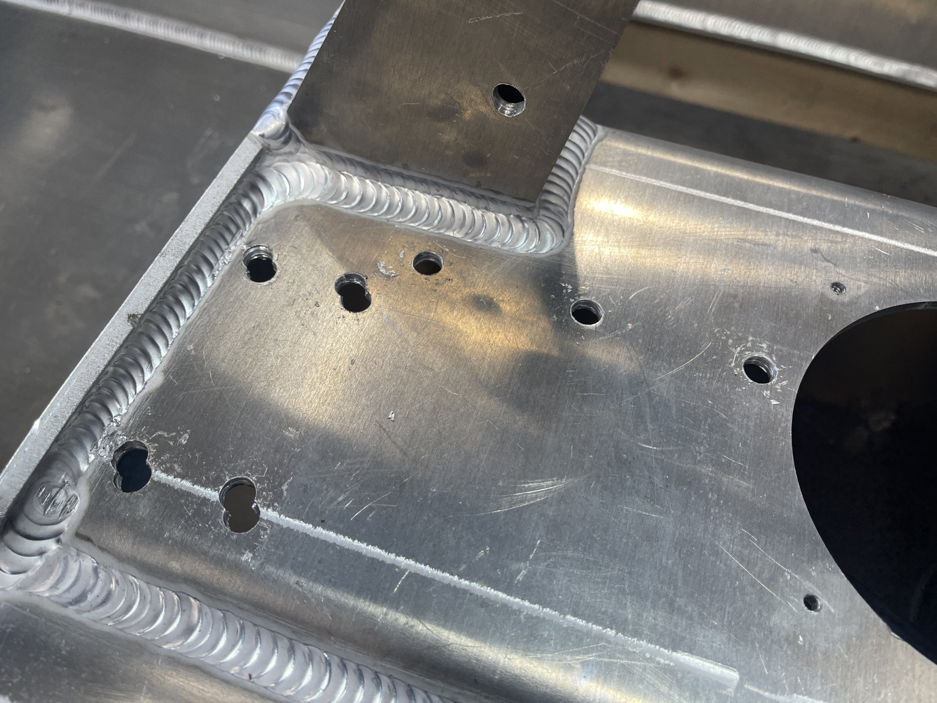

I ended up MIG Aluminum welding the holes. Not so hard. Some clean up to remove the excess but it came out looking pretty good. I used a paint and rust removal plastic wheel in an angle grinder to smooth. I backed up the holes with a piece 1/8” plate steel held in place with clamps. The aluminum filled the holes nicely without sticking to the steel.
Before
After
