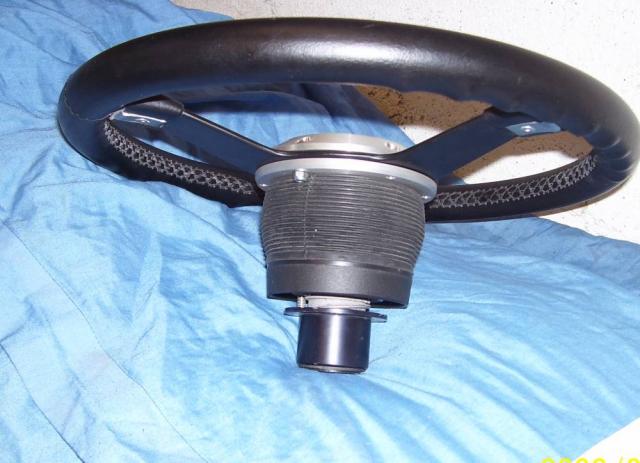

I have a removable boss system with a Mountney steering wheel that had no collapsable bit. Mountney do a collapsable boss ( I got mine from Merlin)

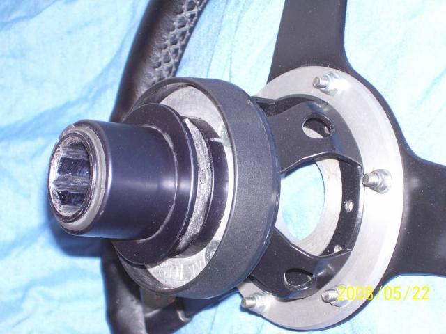

I made an adapter discs to mount the removable boss to the collapsable boss and the steering wheel, also a mechanical fix to prevent removal from the steering shaft for the SVA test
Steve
