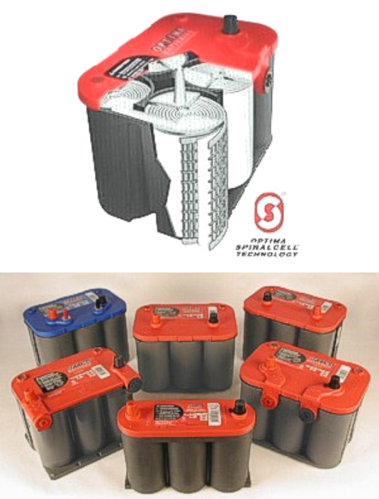

I've been looking for a compact size battery and came accross these guys - 1st Optima Battery Sales www.1st-optima-batteries.com
Little bit of info on them:
#Delivers higher peak amps faster than conventional batteries
# Provides up to twice the life of conventional batteries
# More consistent voltage across the discharge curve
# Superior cold and hot weather performance vs. conventional batteries
# Available in models with SAE posts, stainless threaded studs, or both
# Spill-proof, even if the case is physically ruptured
# Will not off-gas in normal operation, eliminating fumes, odor & corrosion
# Over 14x more shock and vibration resistant than conventional batteries
# Provides more power from a smaller package
# True zero maintenance
# Holds charge better during periods of nonuse
# Operates in any position without spilling
# Offers proven durability & performance (Read testimonials)
# Shipped out same-day if ordered by 2 p.m. Central Time
# Arrives charged and ready to use
# Free shipping in the U.S. 48 states

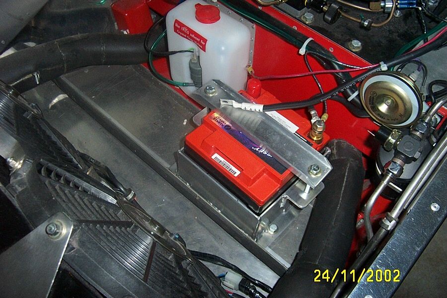

Howard - is the pic of your car? If so they I assume that it must work well?

Yes it is, I made the housing so that the battery drops right in. I got it from:
West Coast Batterys Inc.
P.O. Box332
Atwood Calif. 92811
888-379-2555
www.odysseybatteries.com
Mine is the 925T it's about 7" X 7" X 5" 23 pounds. 925 cranking amps for 5 seconds and 765 amps for 20 secs.
Starts my 302 just fine. Its 9.5 to 1. I could have gone with a smaller battery really the 680MJT would have worked well enough. Check out their webpage. The Holleys are the same thing as are others that look the same. The odyssey's are the least expensive.
I think I called it an optima in the first post it's not it's an odyssey.
You can see from the picture that it is three years old. Still works like new. I have never run it down and it has never need to be charged. I think the guy who sold it to me said they can hold 80% charge for 2 years if without load.
Orginally came form snowmobiles. Those guys needed a battery to sit for 7 months a year and then have plenty of life for two or three months a year without going bad from being unused. Mine was about 160 bucks I think. Worth the money.
