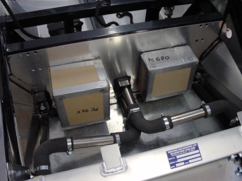

Hello,
I have built two dummy batteries to check the fit – boys are they small.The dummies actually came out a bit bigger than in real.
One is the Odyssey PC 680 and one is the Odyssey PC 925. On the first picture I have placed the batteries direct on the floor - this will be a tight fit for the 925.

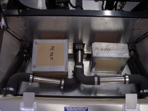

On the second picture they are placed on the rear rail and “mounted” to the rear panel. This makes a very nice installation even for the bigger PC 925.
