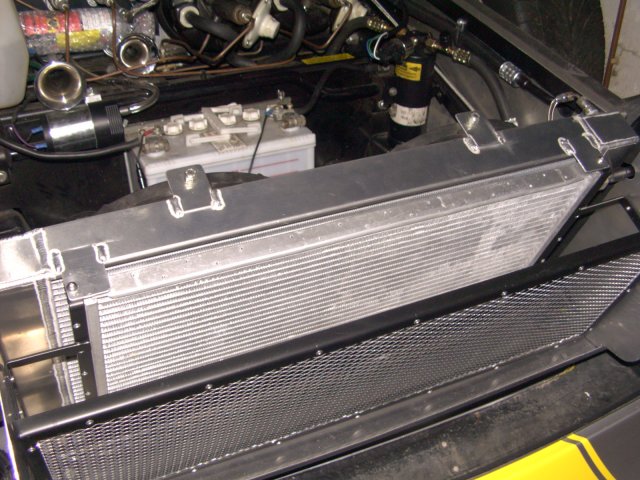

Hi, I want put in cowling to direct air from the front opening in the clip to the rad. Any pics or links to pics would be more than welcome so I can see how others have gone about it. I know there is probably more than a few already on here but I have not found them yet.

Something like this?
There's a baffle along the bottom of the rad and the side cheeks are shaped to fit inside the clip when it's lowered.
Very effective and more than compensates for the wire grille protecting the aircon condenser.

Thanks for those. Very much what I had in mind. I have heard that people fix some foam on the underside of the clip to block the gap at the top of the rad as well. Have you done that? cheers alan
