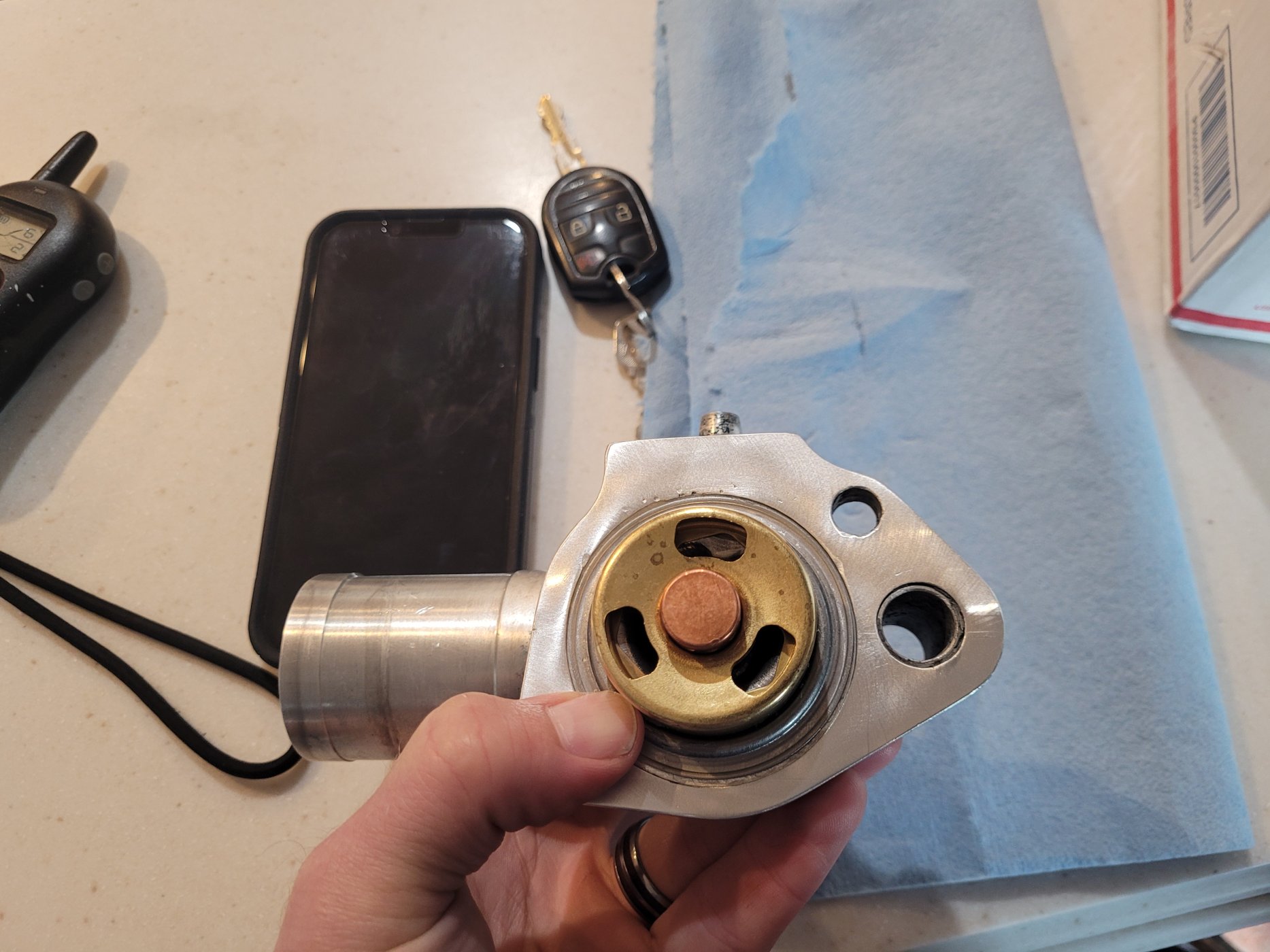

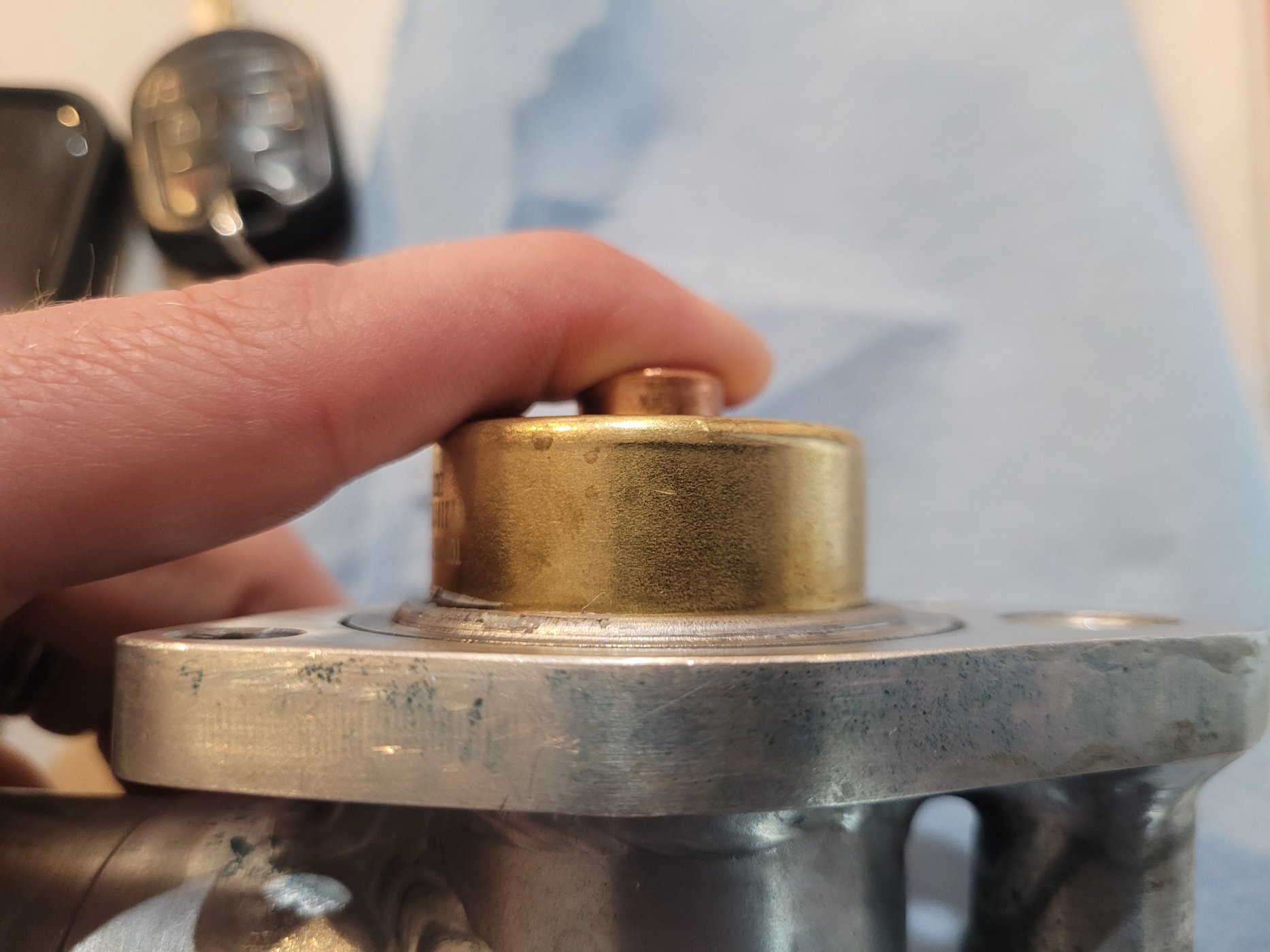

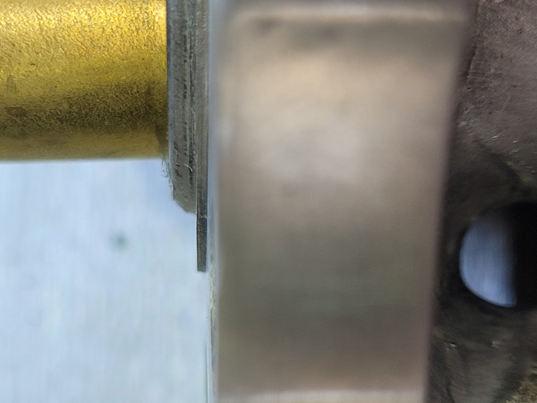

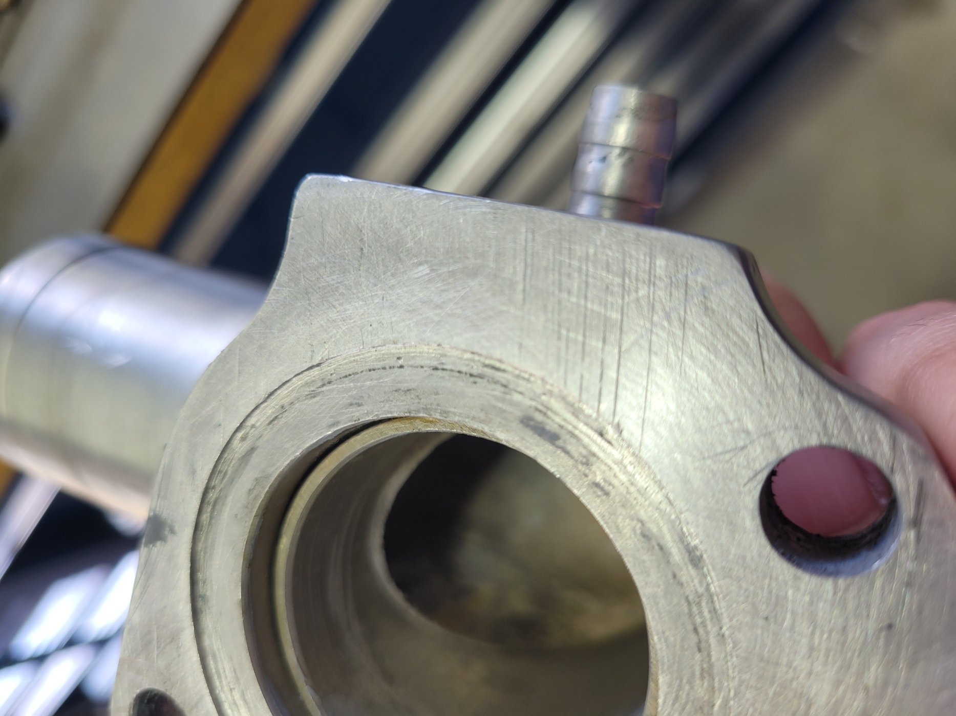

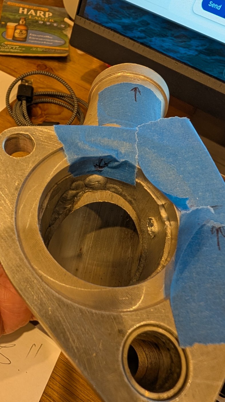

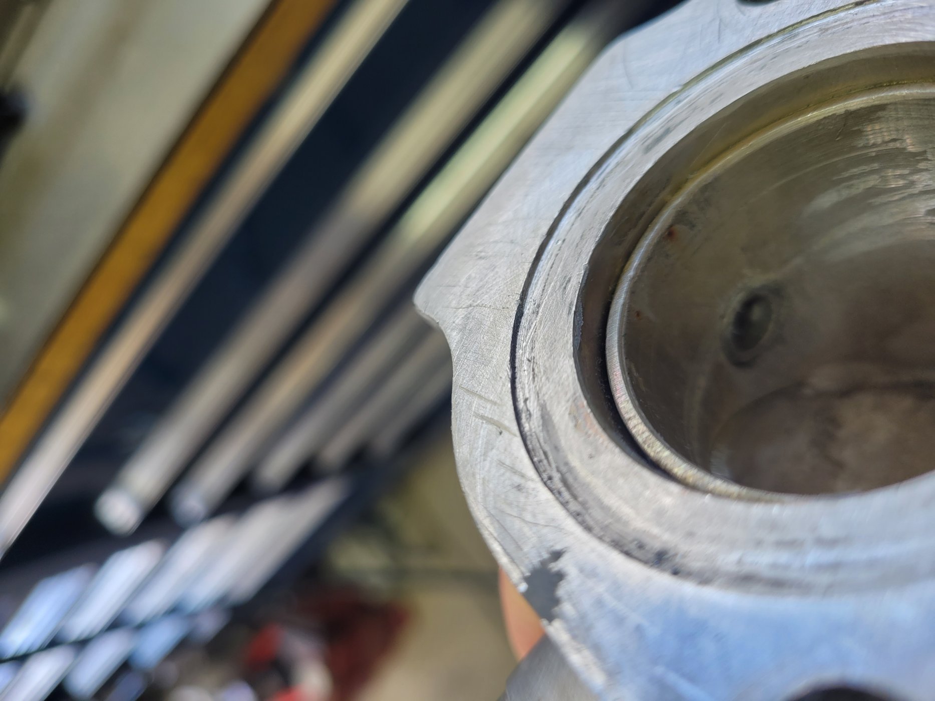

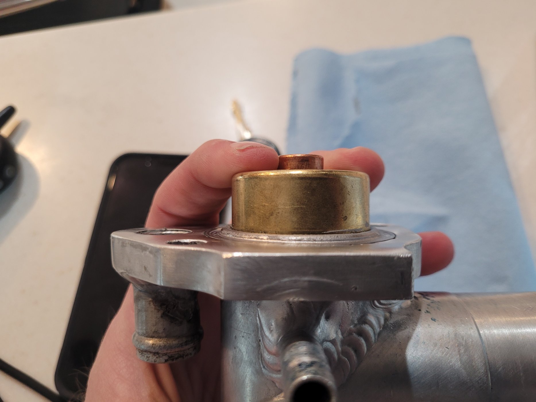

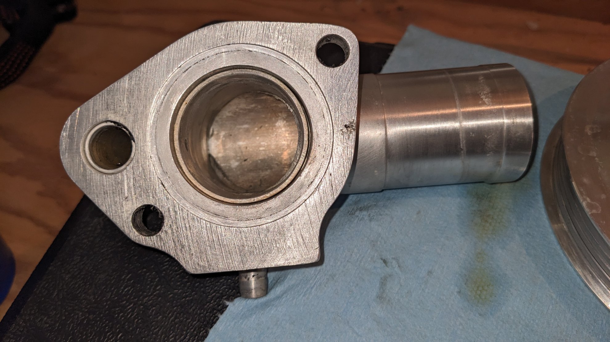

Mike, I found a few issues the the water neck after receiving it and I will dree is up for you. I have attached some pictures below. You will see why it leaked.

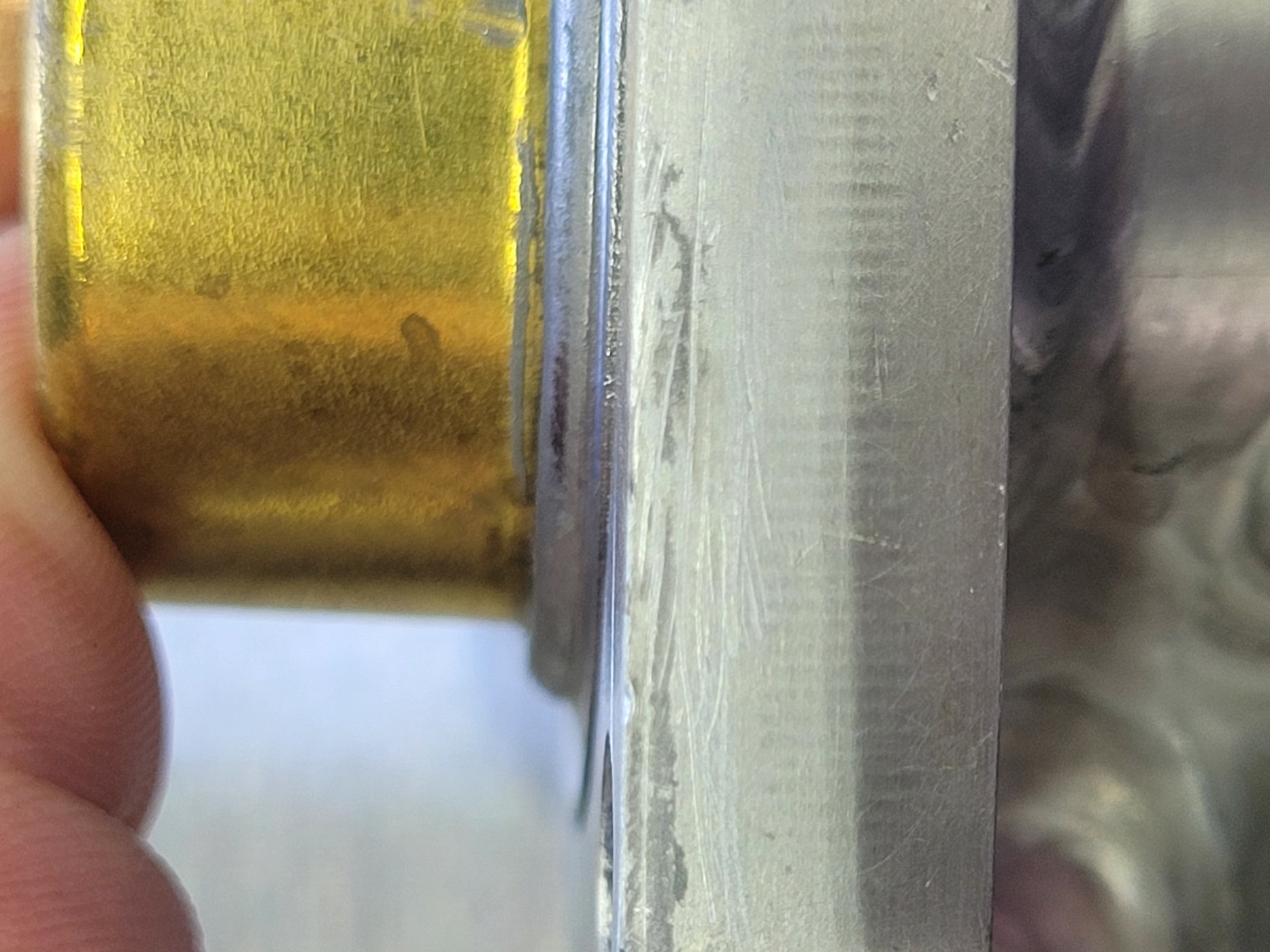

One side sits flush, where the other is not, it was machined out of true.
You can spin the thermostat and these points stay the same, so it is not the thermostat out of wack.
I also noted several deep / scratches on the surface, you could catch your finger nails in them, they ran from the thermostat ring to the perimeter of the part.

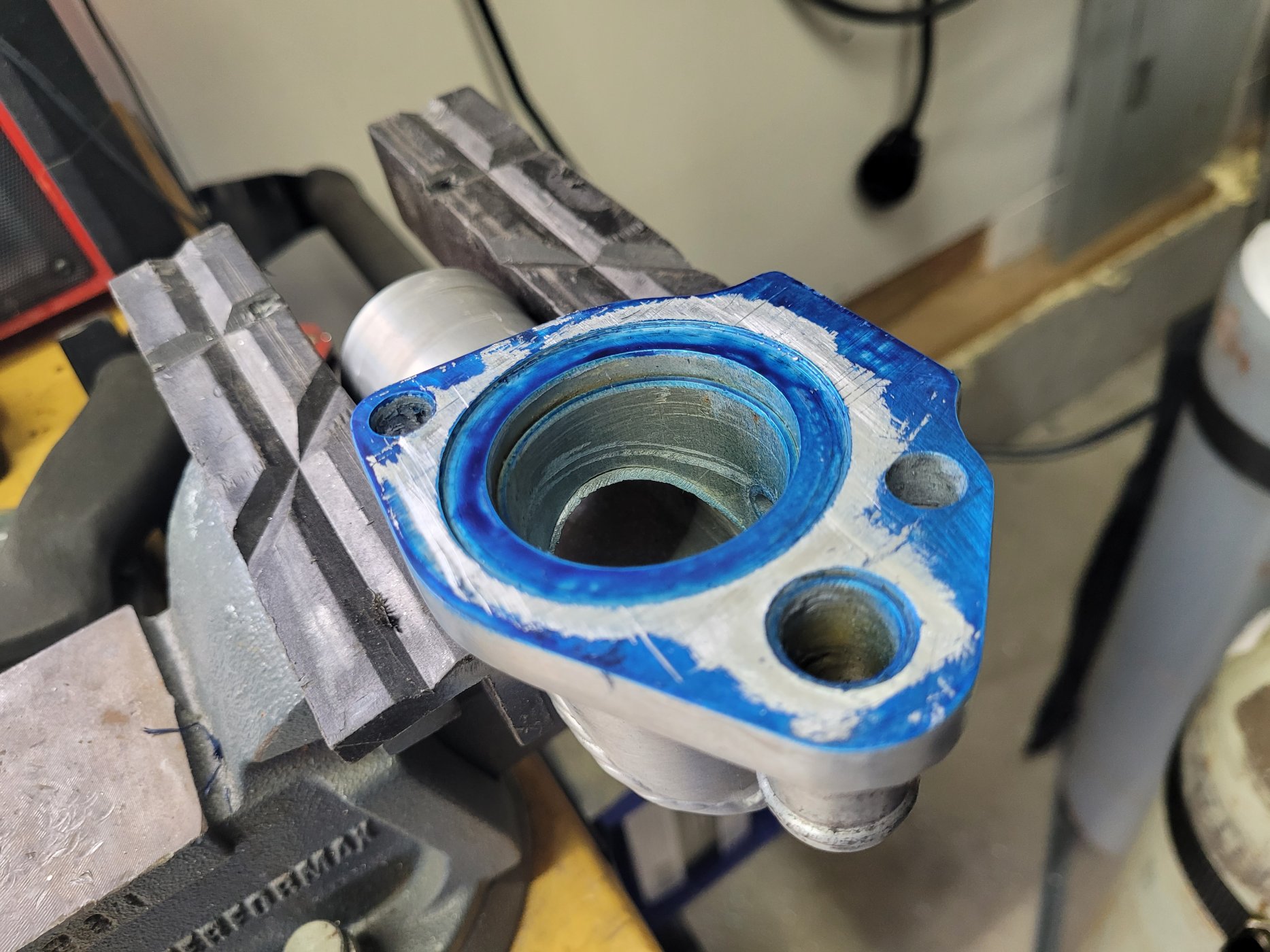

I also blued the part and lapped it on a surface block. It isnt flat. I will true that up with a few thousandths off it.
I should have it cleaned up this weekend.
Douglas
Wow, what great work Douglas. How do you plan to deepen the recess?
Once the surface is trued, I will manually do that on the cnc mill. I will just make a spiraling circle cut to ever so deepen the areas few thousandths at a time and test fit it till it is flush. The circle part I will program. The fun part will be stabilizing it on the mill. As it is awkward to support.

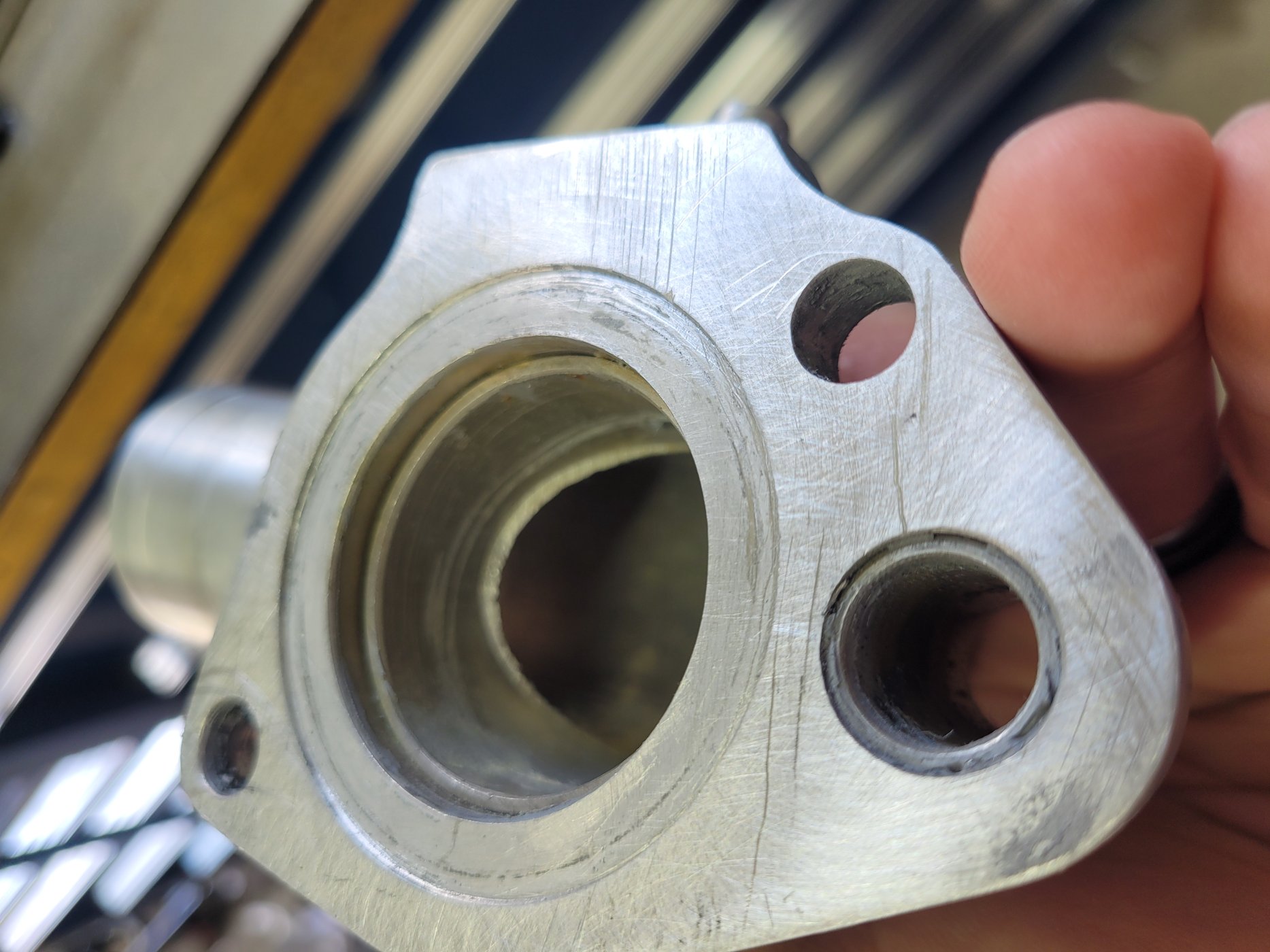

I opened up some pitting when i took a few thousandths off the surface, on the edge of the recessed area. Nothing I would worry about. There is about the same amount of a gap around the thermostat as before, I think that could be a good location to add a thin layer of RTV to act as an oring around it under the gasket.
Deburred and gave a light polish. Lol
Yours also has that sharp edge in the bend from yhe two tubes welded together. Not anywhere near as bad as the one you posted, but I would file it down when you get it back to help clean up the flow of fluids.

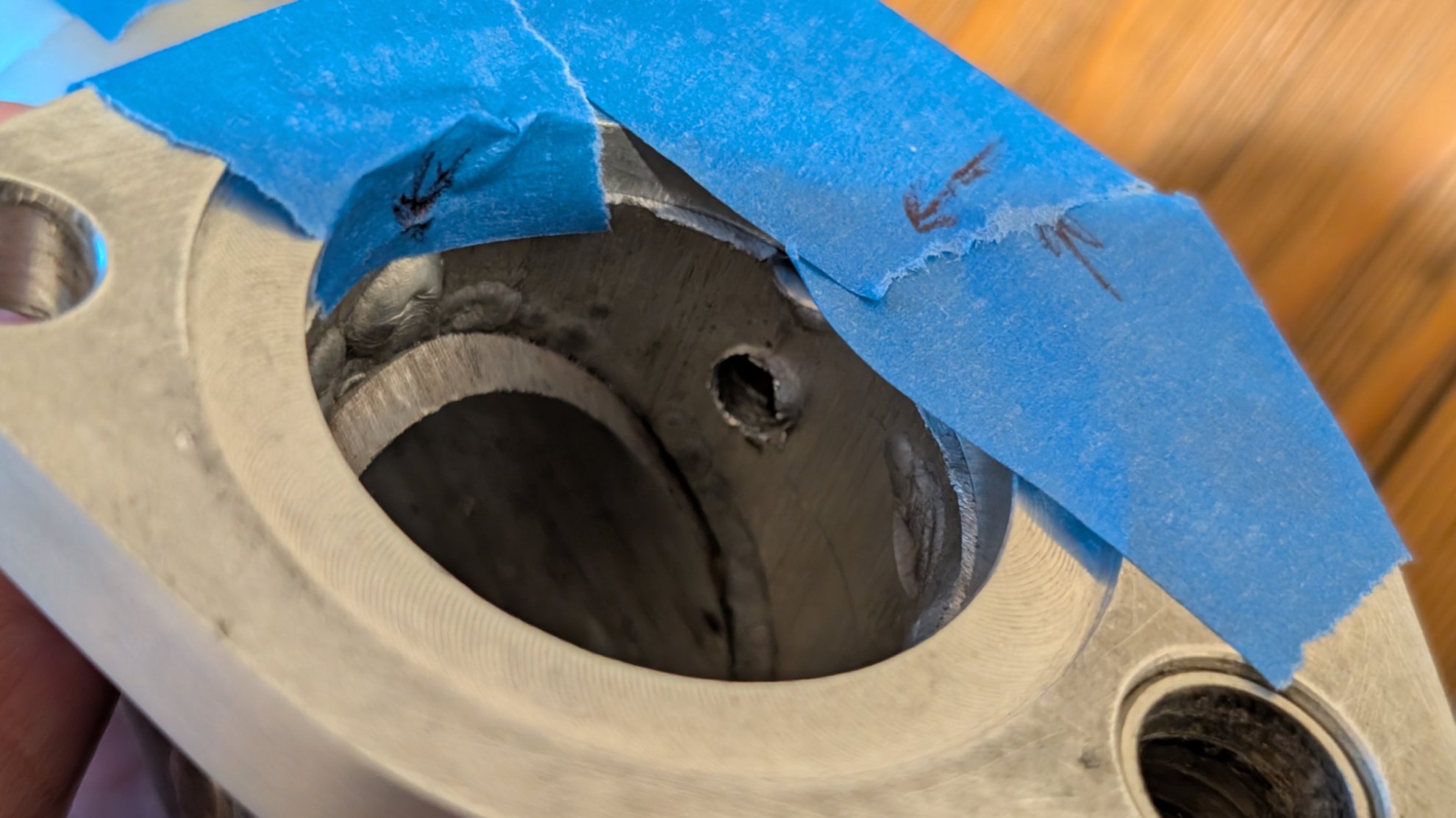

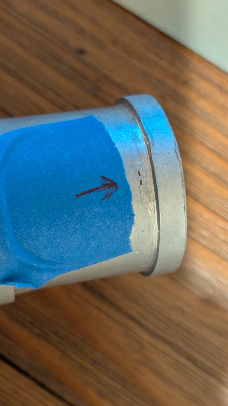

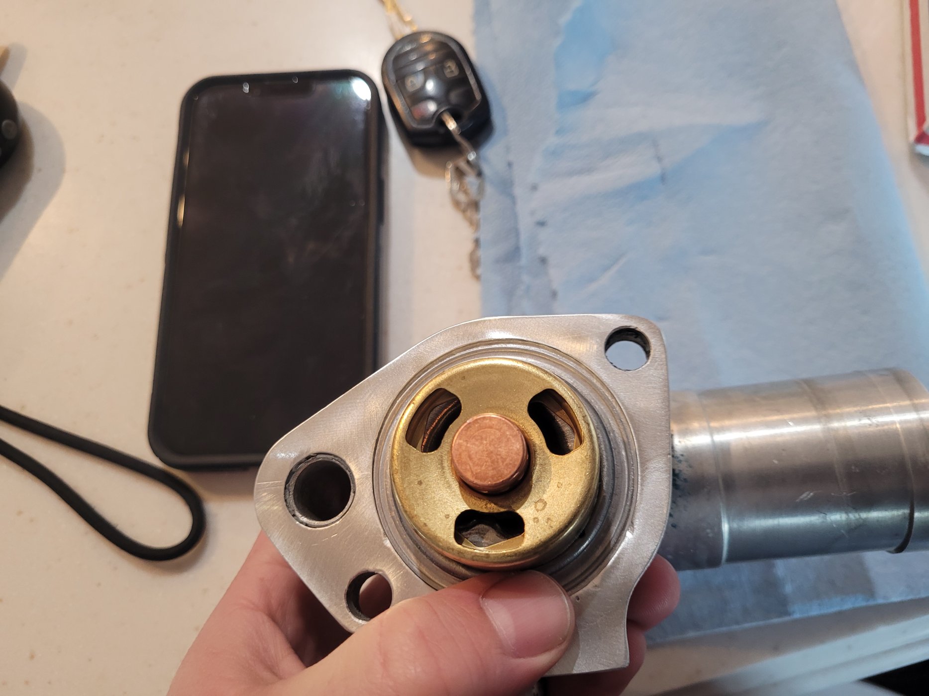

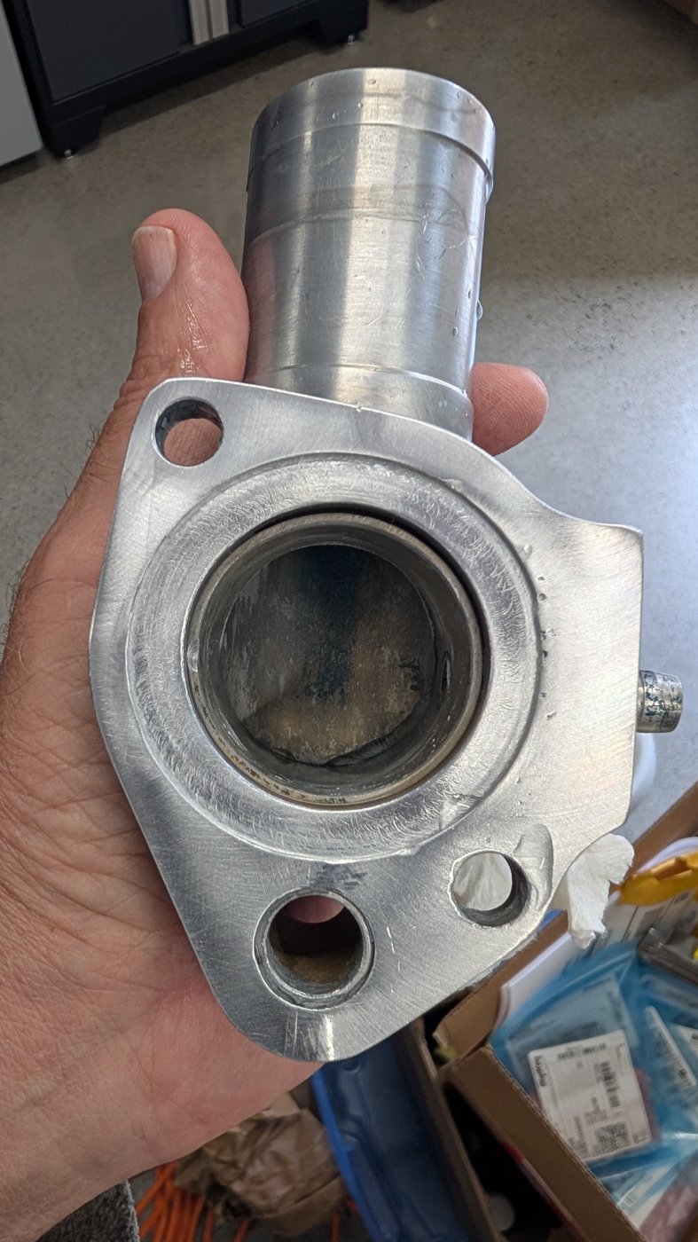

I received my housing back from Douglas and am looking forward to trying it in two weeks. In the meantime, I used a sanding bit in my drill to remove the edges inside that restricted smoother flow. The area cleaned up is the right side interior perimeter of the intersection of the two pipes. A before picture:
And an after picture:
You can see how smooth the gasket surface is, and the increased depth of the thermostat recess.
