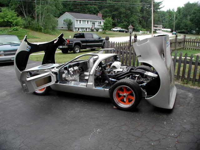

I got mine used from the UK, and that's pretty much how I built my whole car, used stuff from the UK. I would suppose at this point that the GTD club guys can source just about anything required if you can' get it over here. I have attached a pic of my crossover and there is plenty of clearance.

Brian,
Thanks. Scott Calabro and Tornado can help me out I believe, but thought if I can get some units here , it would be better with the exchange rate and all.
By the way your car is looking great. That baby really shines!
For sur the CAV would have fitting problems. If you look at a CAV compared to a GTD there is a big difference in the height of the rear deck panel surrounding the carbs. It is at least an inch higher on the CAV. Tornado,GTD and RF should all be pretty similar.
