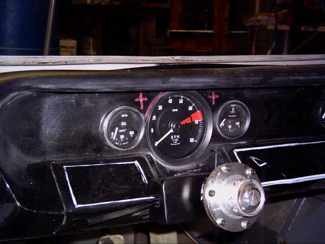

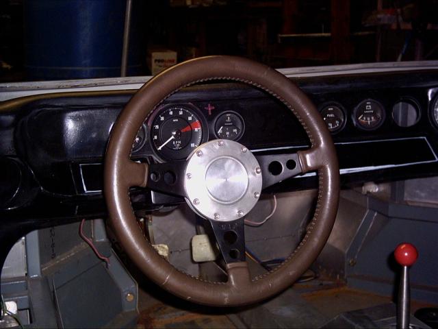

Jim:
The unit from NRG that Lynn mentioned is really nice. I am using it on my build. It features connections if you care for a horn, also the wheel always finds the same spot in rotation, and has ZERO play. A really nice unit. They run around $139 but I got one on Ebay for $35.
Here's a couple of photos.
Phil
