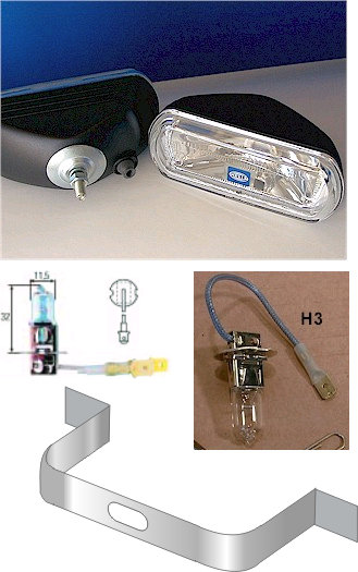

I would prefer to use a newer type halo spot/driving light. I've looked around for similar size/shape lights used back then (Marchal's) and most come in at only 55W and don't have a rear mounting option. The Hella H 300 units I found are compact, would fit well, can be rear mounted with a small bracket and you can purchase different W bulbs.
My only concern is the heat the higher W bulbs will generate, especially over 100W. At least these will light up the road, which I think is the whole purpose.
Hella Model 300 Driving Lamps and Fog Lamps
