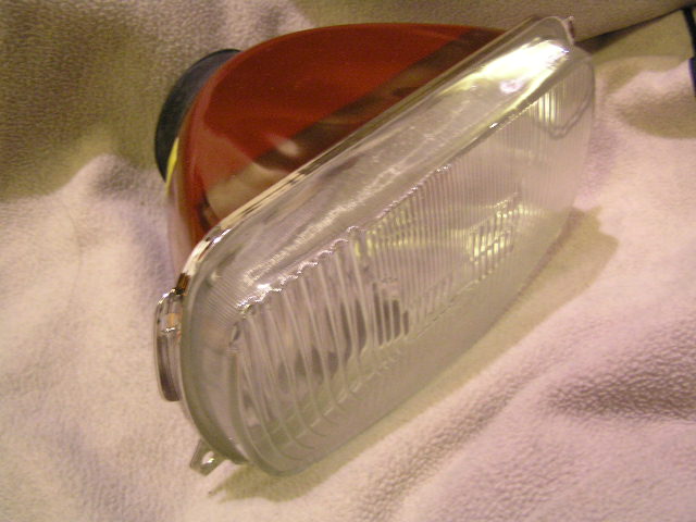

I am using these lamps...hard to find with the convex radius, but I have them now. They use a P45T lamp, not available here in the U.S.. I am looking at some now with a concave lens that use an H-4 lamp, which I believe is available in both Europe and the U.S.. My lamps are Cibie units which came in a Valeo carton, but I have been unable to locate these on the internet even with the part number.
Phil -
It is no problem getting the P45T's here. I think this is where I got them, very inexpensive have the halogen versions with correct base to.
www.Bulbs.com P45T Lamps
HTH
Sandy
Sandy
Thanks you.
I took the bulb, In a Sylvania box no less, to one of my suppliers and hsi comment was that it didn't exist...funny thing I had it in my hand at the time.
I am currently looking at getting some lamps with H-4 bulbs now and I will post them if and when they arrive. Thanks again for the link.
Phil

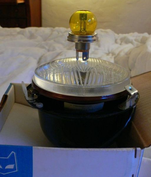

I was looking for the non-halogen versions like below so I can have a couple of spares for the Simca 1000 lights that I got. They came with a couple that were hidden in the boxes.
The round bulbs in the head lamps give them an cool looking yellow glow even when the bulb is off.
I have seen them on Ebay, I think about $25 for the pair so likely they are about $5 each somewhere.

I found the halogen version on a few motorcycle/snowmobile parts places. Getting a the non-halogen in yellow seems to be harder. Not such a big deal. Also for other folks, check out some of the sites in the UK they make a ring that you place in the P45T housing and you can use other more modern bulbs. I think about 15 bucks for the ring.
