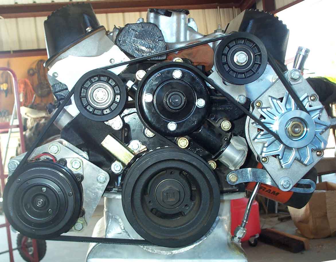

I will get this for you tomorrow and take some close pictures. RF did a nice job with their brackets and is as tidy as I've seen, and very short. I used a different cover and water pump than RF specifics and think I got it even tighter as I had to turn down all of Robert's spacers to get everything to line up.
The pump is approx 4 1/4" from the timing cover to the tip of the pump, or 3 1/4 to the pully mount.
Ron is correct RF did /does a really nice job for the front dress.
