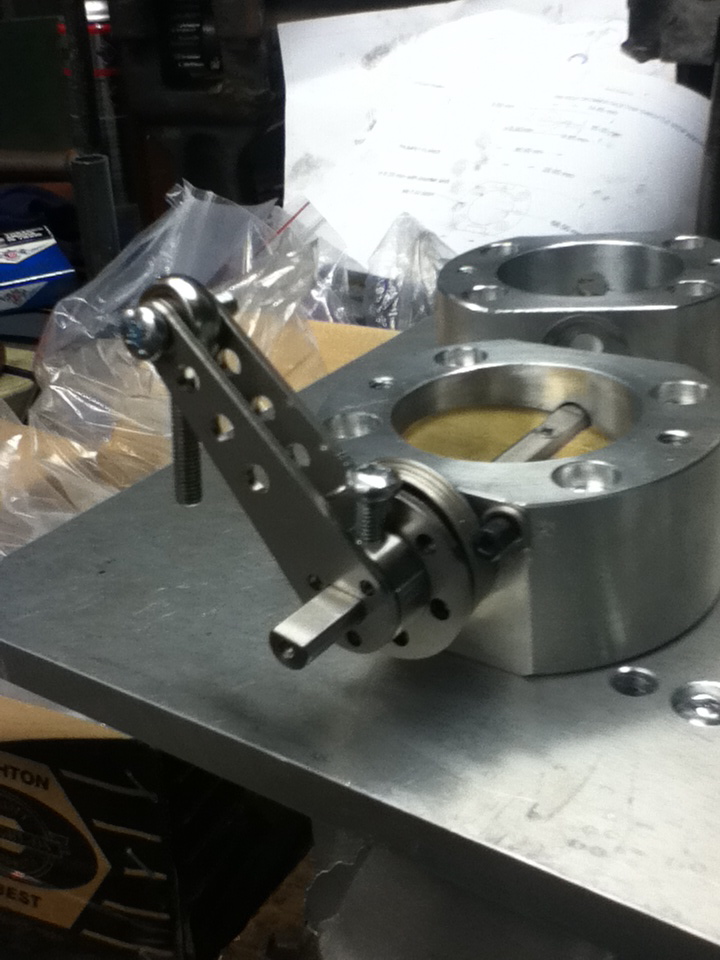

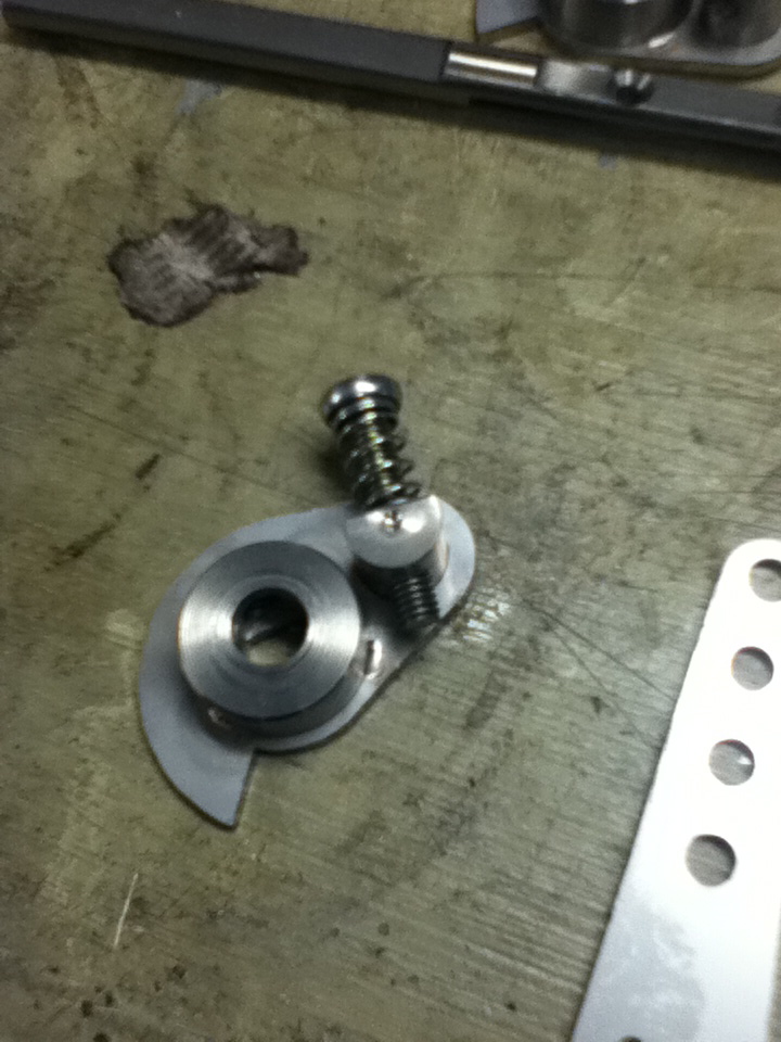

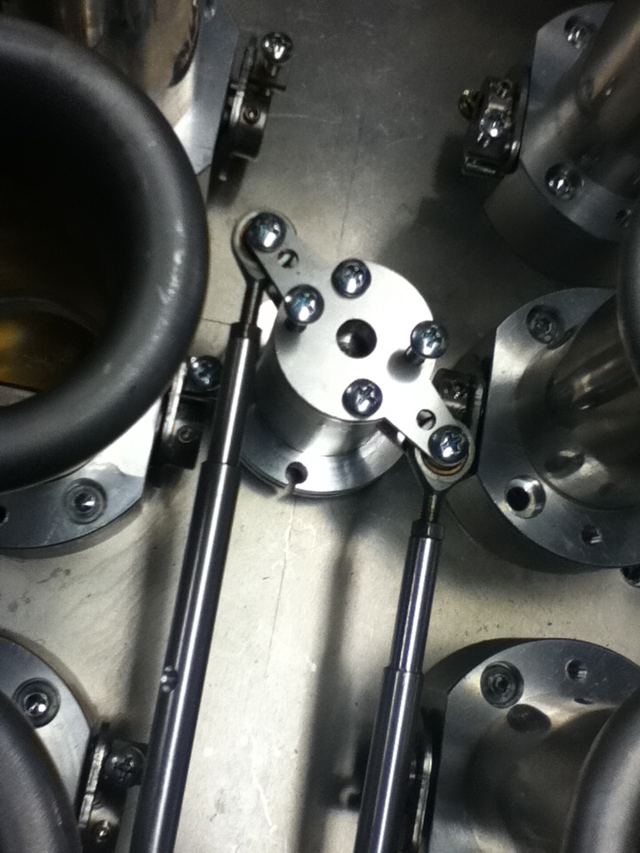

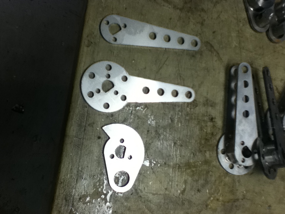

The bellcrank sits on a post via a roller bearing
Down the centre of the bellcrank and fixed to the post I will be attaching the TPS shaft (that is stationary), the switch mount will on the top of the bellcrank under the 4 screws.

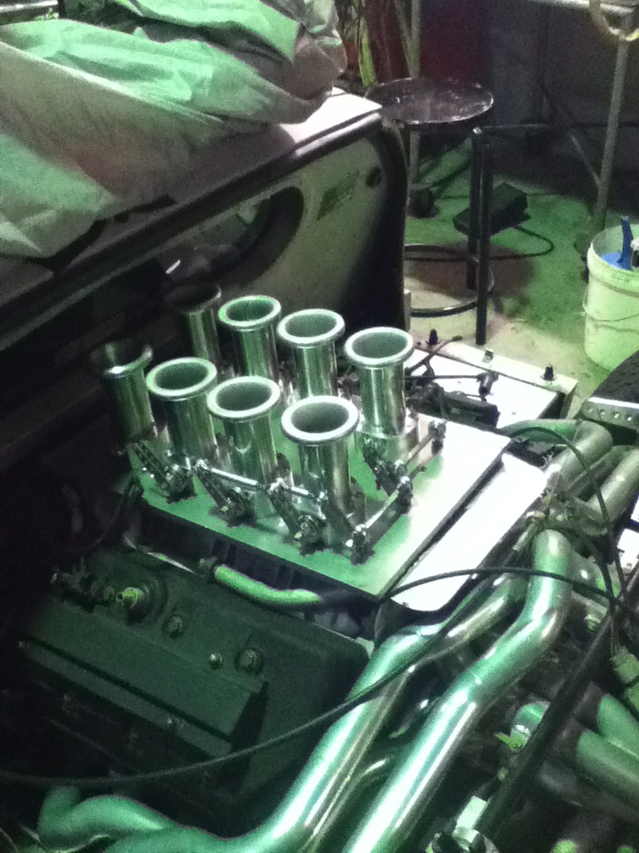

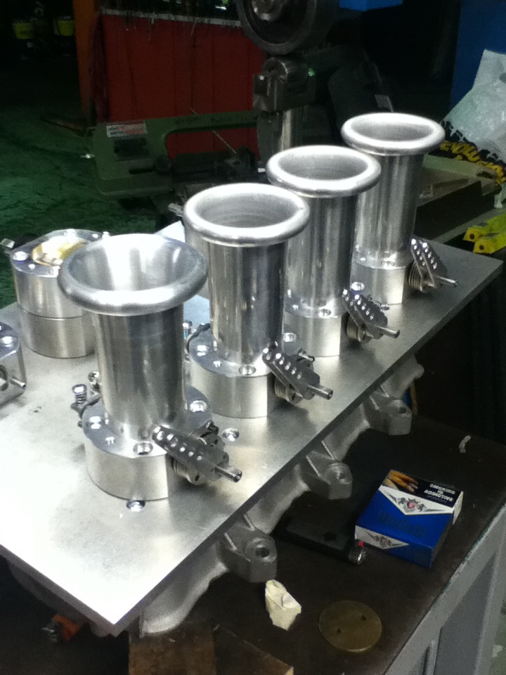

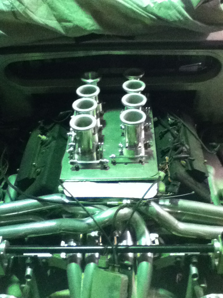

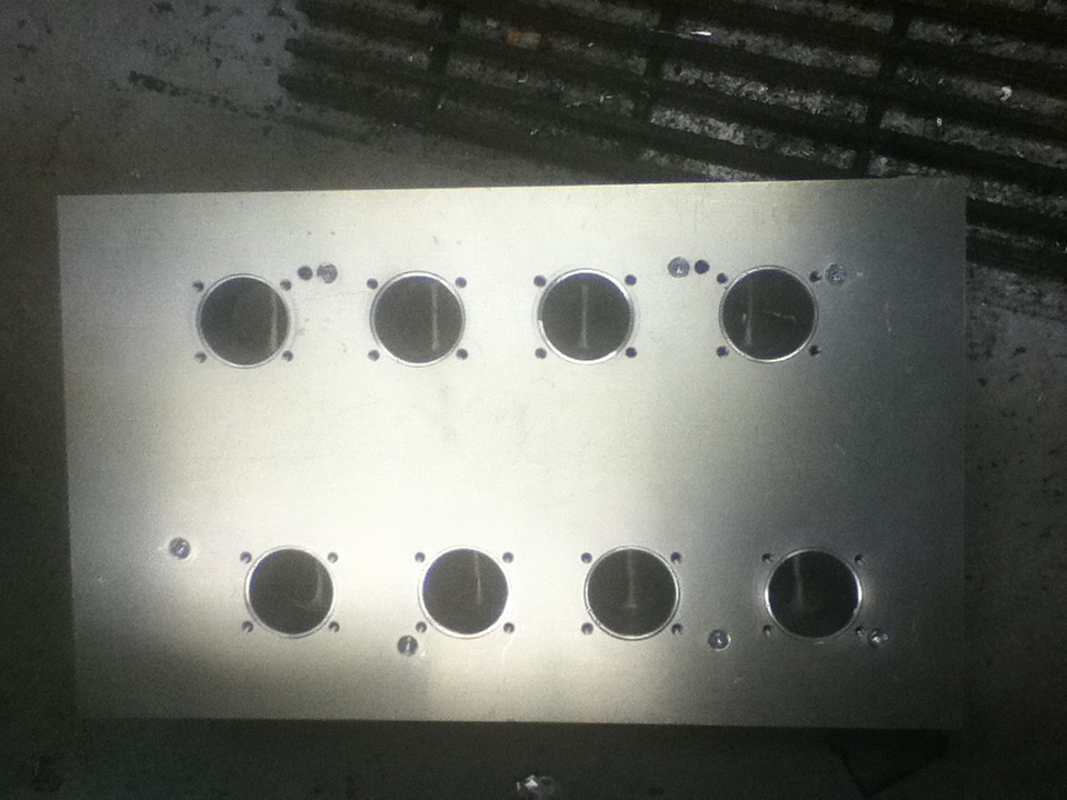

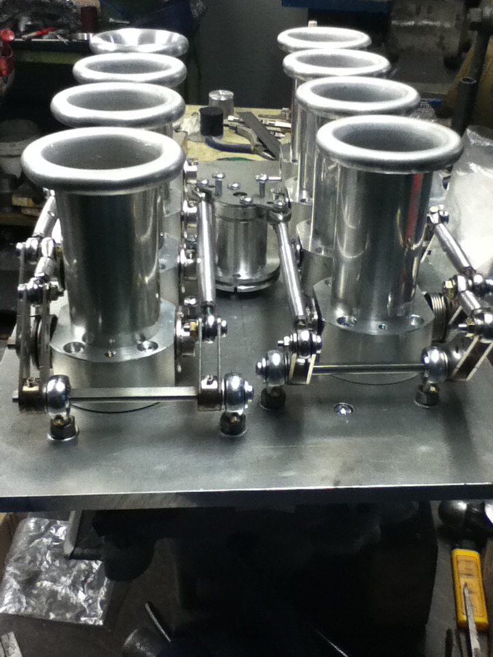

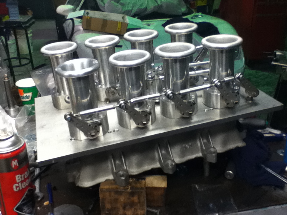

More progress
Put the trumpets on the flanges.
Welded them on the inside to keep them tidy.
Put a radius on the base plate and riveted a flange plate from underneath to mount the air box onto.
Did the final assembly.

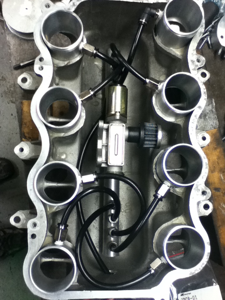

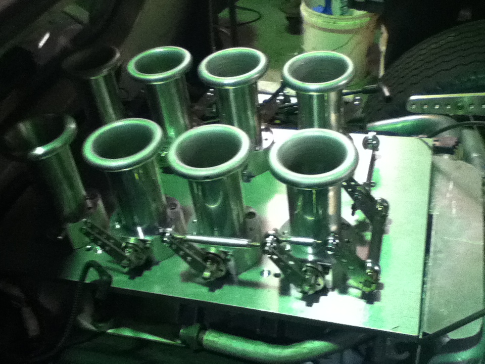

Made the air box ,I still have about another days work on this then it is ready for a start up and retune.
The lid is polycarbonate and the box and the lid are held down on the base via torno cover straps.
I am waiting for mesh to go on the inside of the filters to stop them sucking in.

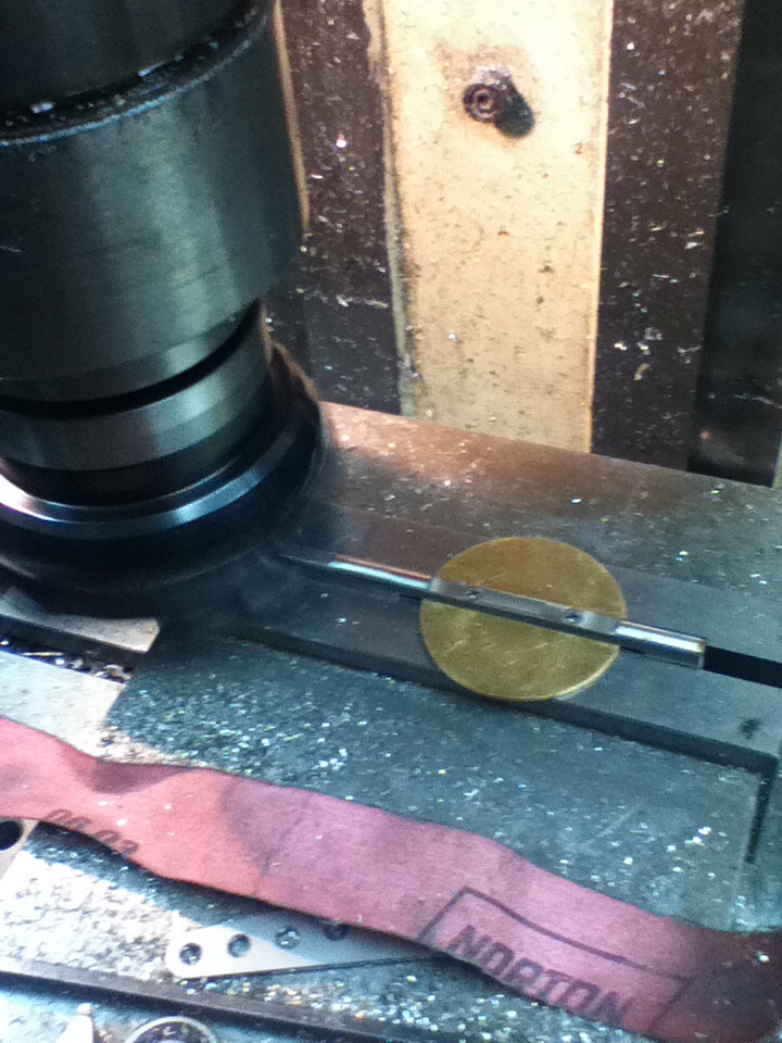

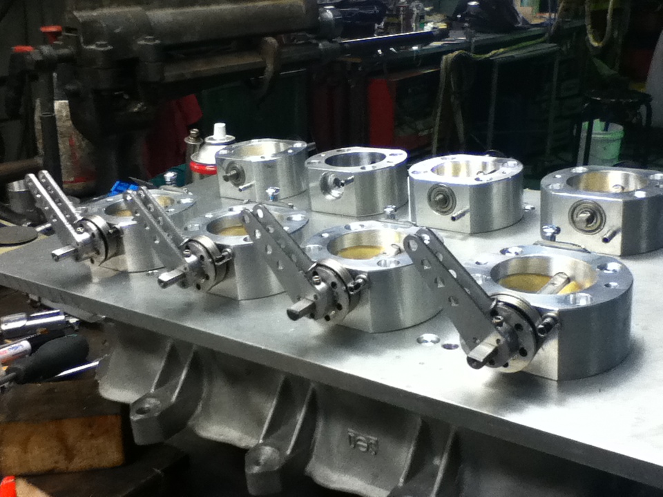

The shafts and butterflies are from a company called Injection perfection here in Sydney.
The rear shafts connected to the centre pivot in the middle photo on post #23 I made out of 5/16 316 SS rod and milled the flats on them.
