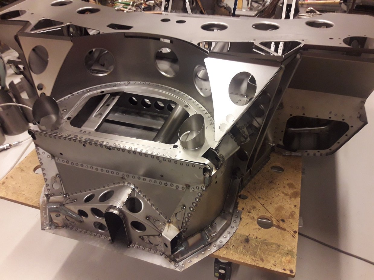

does anyone have the drawings of the floor and the whole front of the gt40?
good to all I am busy assembling my monocoque and it turns out that I have some problem I have the drawings of grabcad, and in those drawings especially mind the drawing of the floor are very blurry and I can not distinguish the measures or see as real mind the drawing, and then I look for the drawings of the entire front of the monocoque, someone knows something?
Well, what you are looking for is drawing 2260, 2275 and 2281. But i am afraid you wont find those drawings anywhere. You will find 2281 without the titlefield in a thread here for monocoque dimensions.
