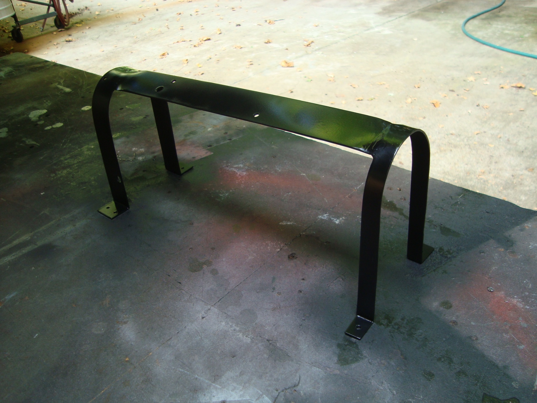

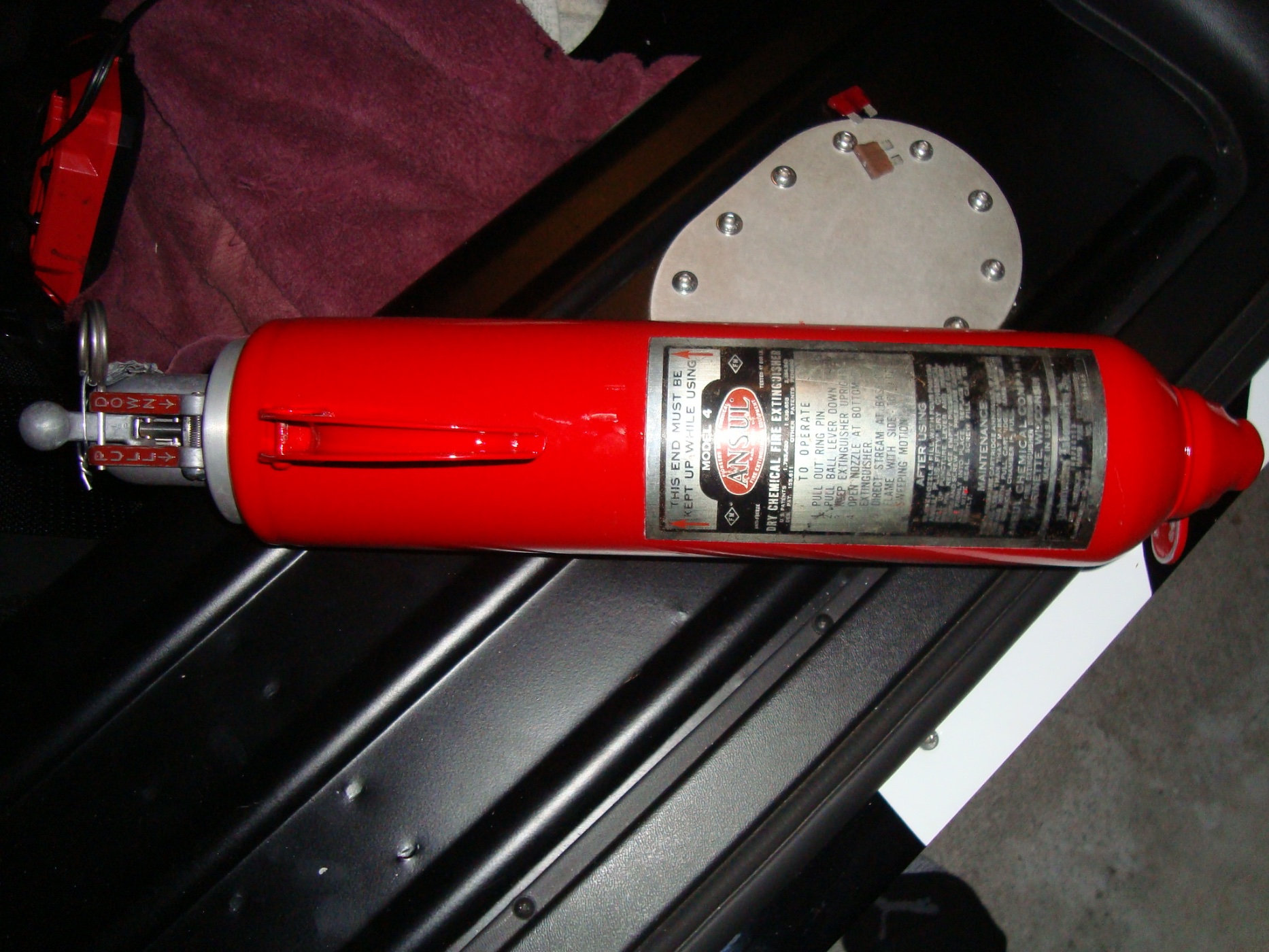

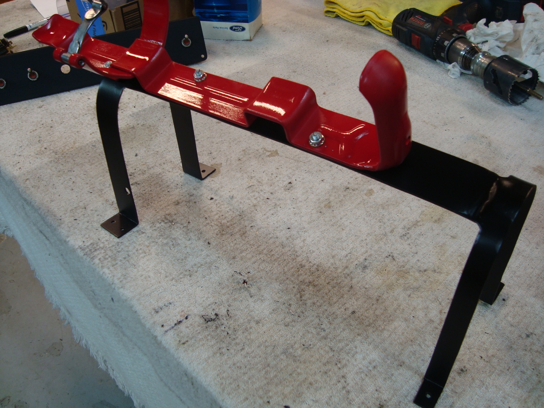

Mark H.
Thanks Randy for the suggestion on the bracket. Made me think outside the box! Made pictured bracket, attaches to the floor crossbraces, extinguisher mount bolted to the bracket. DaveM, I have an original Ansul so that's what needed mounting.

Blas
That extinguisher will become a cabin projectile with that simple hold-down latch on its frame should you have a bad shunt.
Blas
Mark H.
Yep, you are correct! There will be another clamp on the potential projectile's mounting bracket at the rear relief, which will provide a pretty stout affixment.
