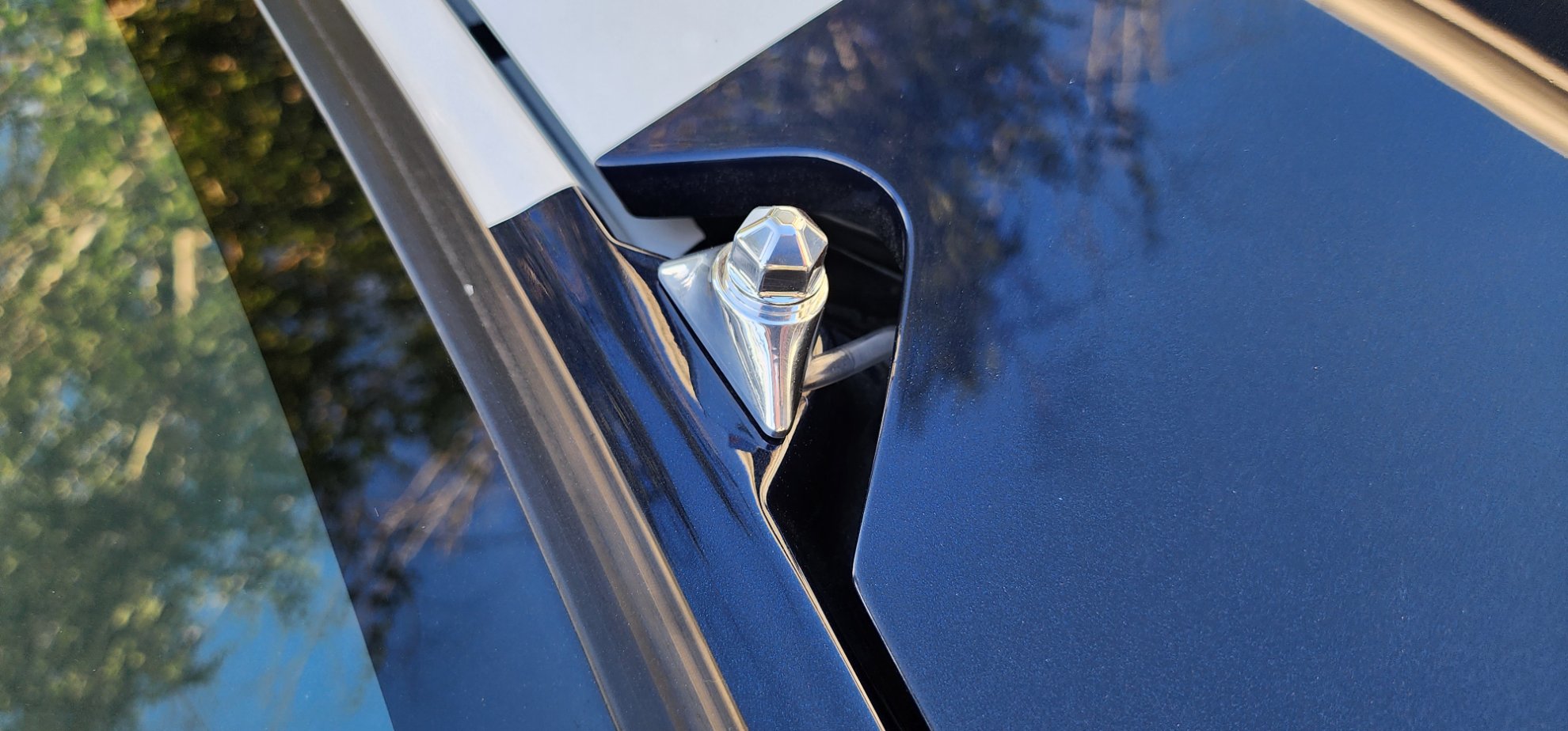

I'm at that point where I'm trying to decide on side mirrors and I'm waffling. I don't dislike the look of the radots mounted on the front corner of the side windows, but I had thought that they could be mounted perhaps using a plate and the original screw holes (altering nothing) but it looks like the tensioner nut on the back will prohibit mounting without drilling some hole in the lexan for the tension nut.
Understanding that side mirrors are small and not fantastic on these cars, is there anyone who has this sort of setup and finds that they never use them? I sat in a SPF yesterday with this sort of arrangement and the passenger side was partially obsured by the A pillar but was a bit more visible moving my head. Still not great though.

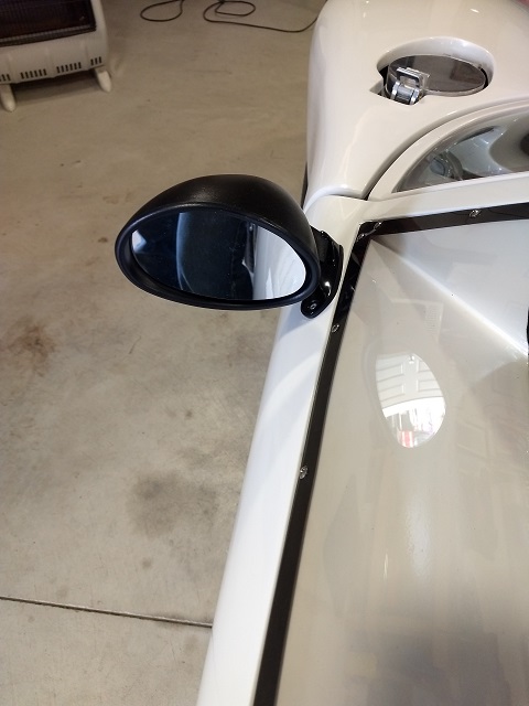

I have the set up you describe, with the mirrors mounted in the corners of the windows. And I too like the aesthetics of that location. They were able to install them, without drilling the Lexan. I found that the passenger side mirror is totally useless, the driver side mirror is better, but not much. I recently had a rear view camera installed to help with the situation. I think I am going to move the mirrors to a location farther out on the door. I will also probably change the mirrors to the same style but with convex lenses, this will improve the field of view.
Neil

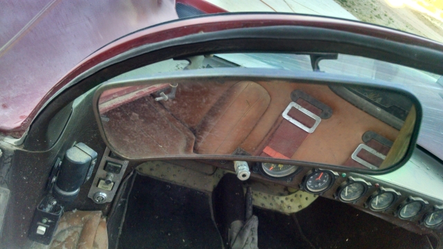

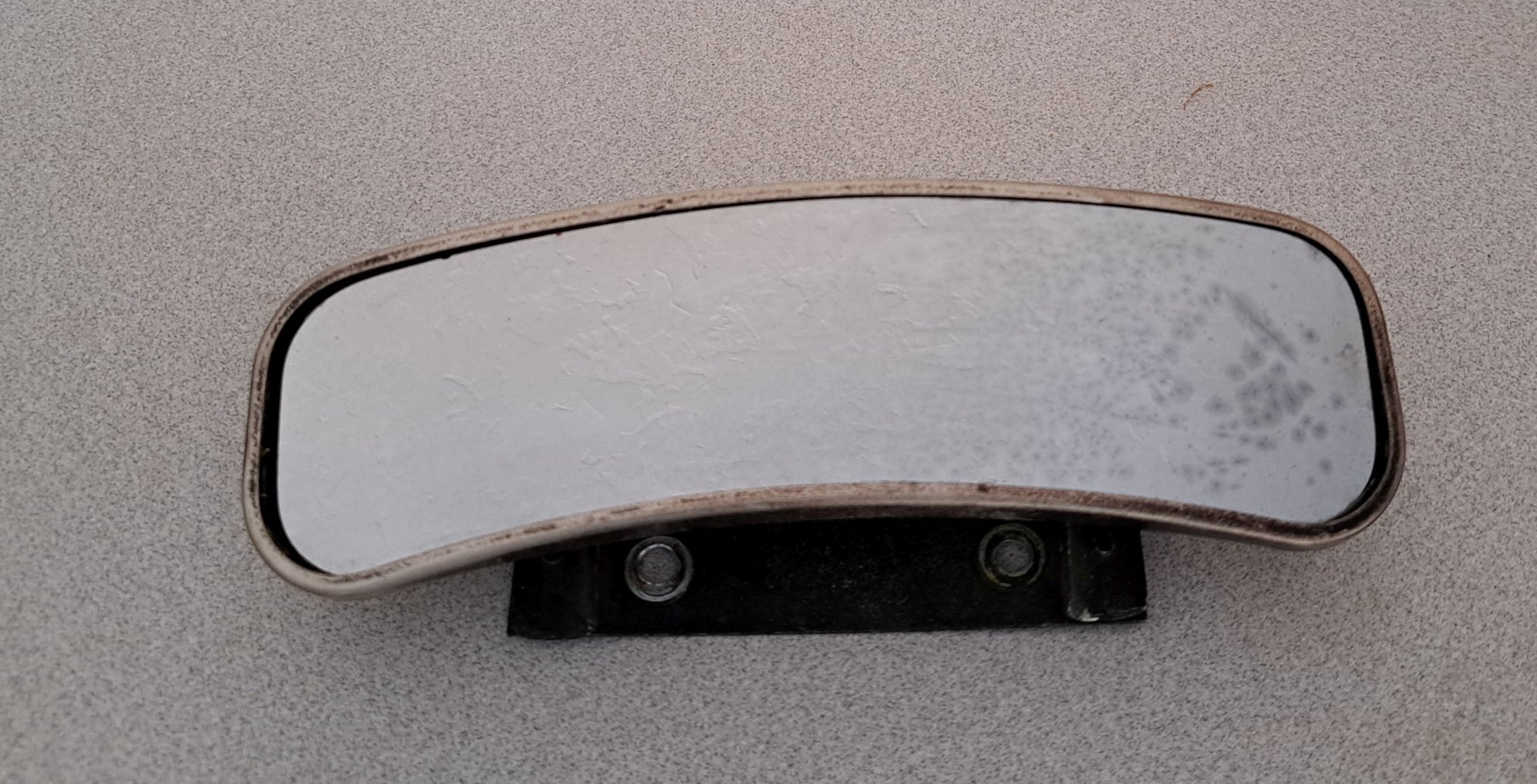

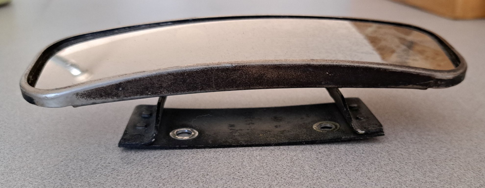

My car originally had a Raydot mirror mounted on the top of each front fender. The view to the rear was totally worthless so I replaced them with two curved convex metal mirrors that I removed from the cockpit of an F-86 jet fighter here in a Tucson aircraft salvage yard. The curvature is close to the windshield hoop and, being much closer to my eye, it gives a very good view to the rear, both left and right. These days a camera might be better but I prefer to keep things as simple as possible. "More complexity, less reliability!"

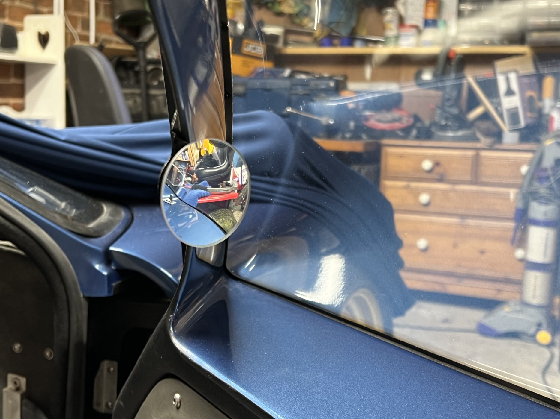

I recently moved from electric side mirrors (SVA) to fixed ‘bullet’ mirrors mounted on the front wheel arches. Pro’s are a period look and better rearward vision around Mk2 rear air scoops. Con’s are a nasty blind spot over both shoulders. Addition of cheap convex mirror mounted on a discreet aluminium bracket stuck with a 3M adhesive pad half way up the A pillar shut of each door skin has plugged the gap and some. Now have 360 visibility of traffic which feels a lot safer if I have ‘clingons’ lurking either side taking videos on their i-phones. The mirror is on a gimbal and so can be tweaked for parking too.

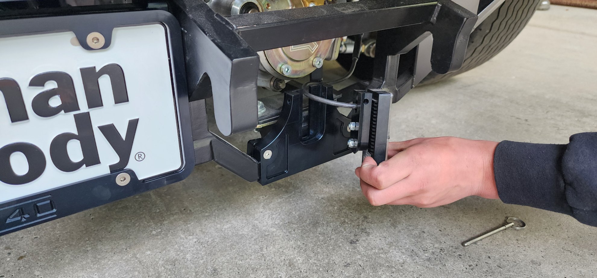

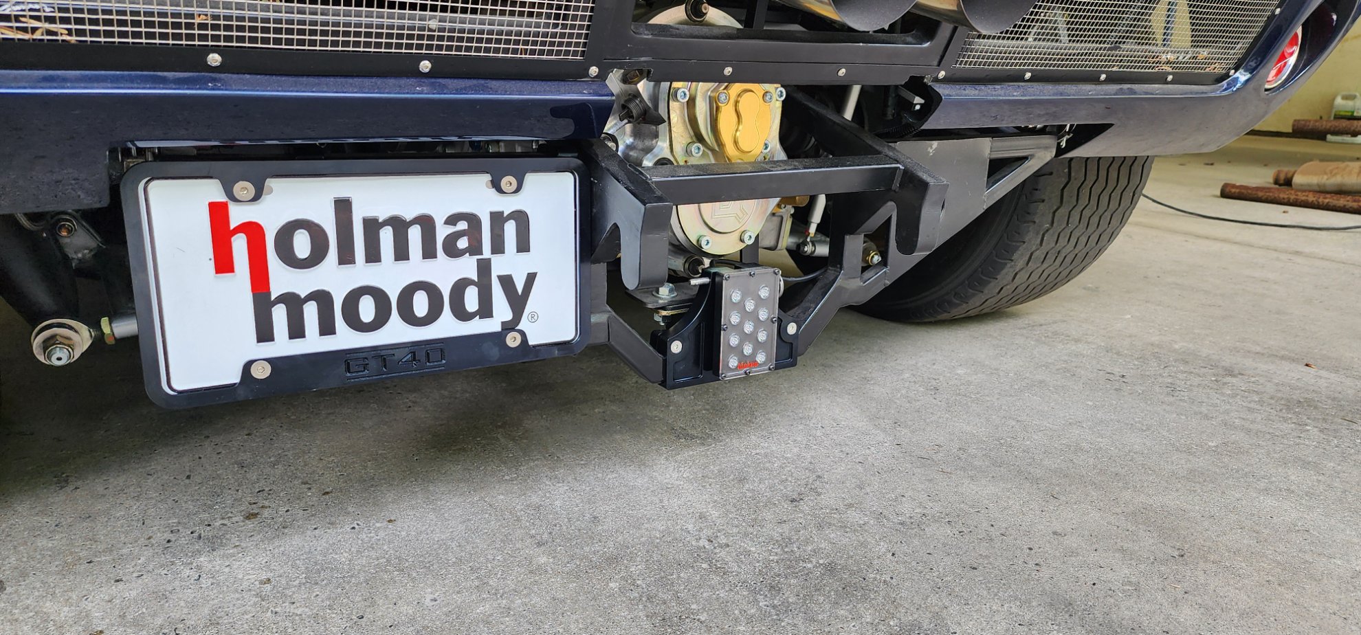

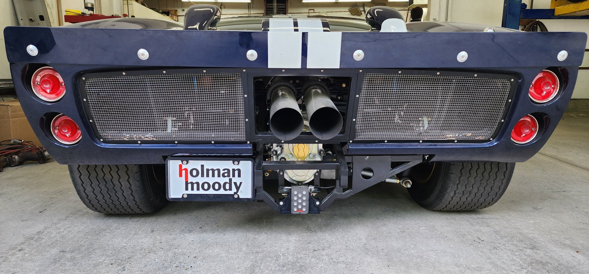

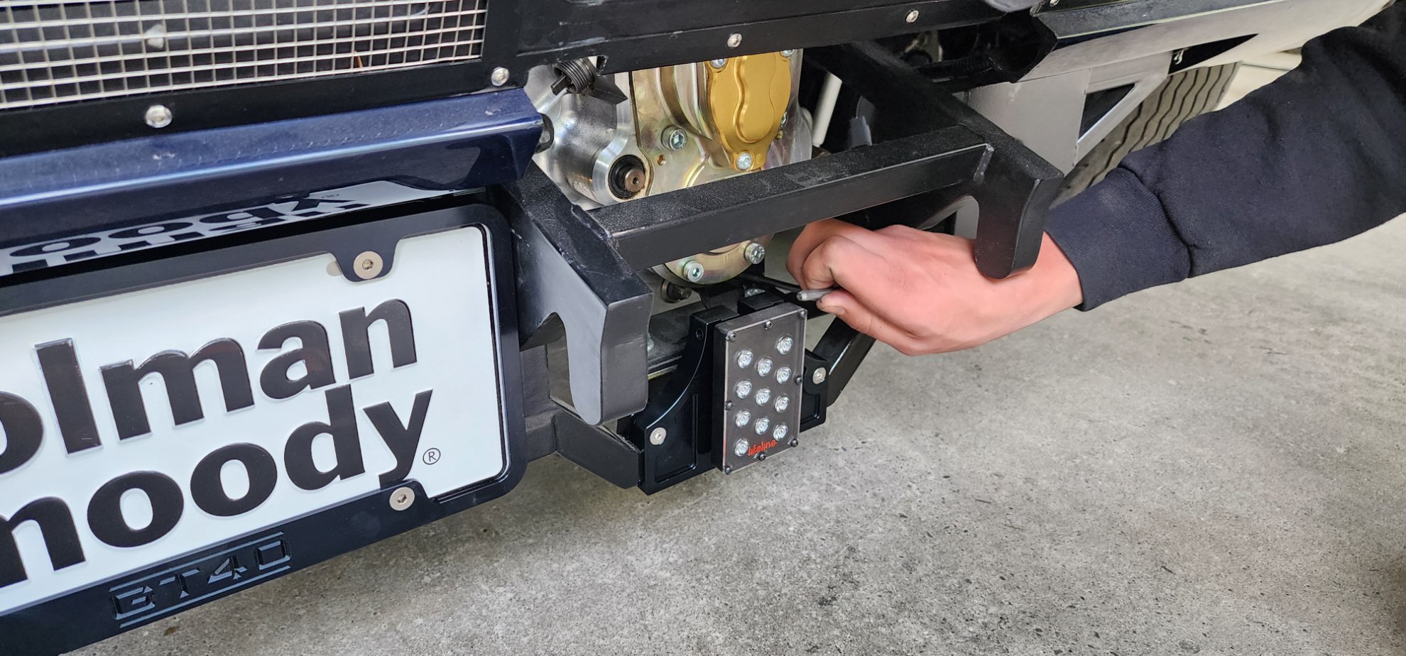

Had these GT40 mirror deletes made then just went to a back up camera system with camera mounted in the license plate quick change mounting system within the GT40 licence frames.
The camera monitor is in my rear veiw mirror with 180 degrees view and just leave it switched to on while driving works great. I can easily just pop the Vitoli mirrors back on and off as I choose.
