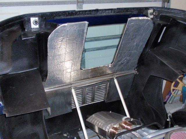

For the rear deck, I have bed liner over the rear wheels with Dynomat extreme under the plenum around the carb topped with reflective heat shielding under the front of the engine clamshell and Dynomat under-hood over the collector to and around the exit vent. (See photo)
Hoodliner
As for the flammability of the bed liner, some are, and some aren't so check with the manufacturer of whatever you're considering. Mine was listed as non-flammable but only when cured/dried. Before they cure they'll burn like a flashbulb though. My suggestion would be thin bedliner for the wheel wells and regular high heat primer and flat black for the remainder. Then cover that with the insulation I cited earlier.
