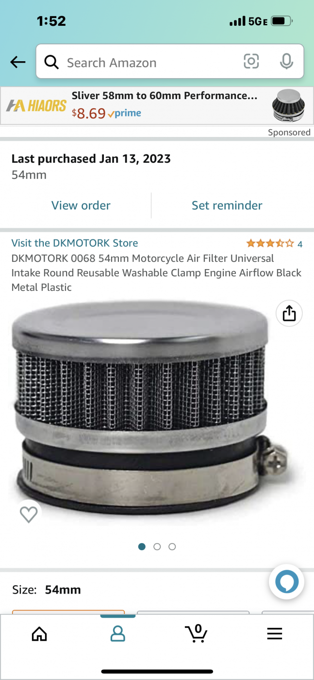

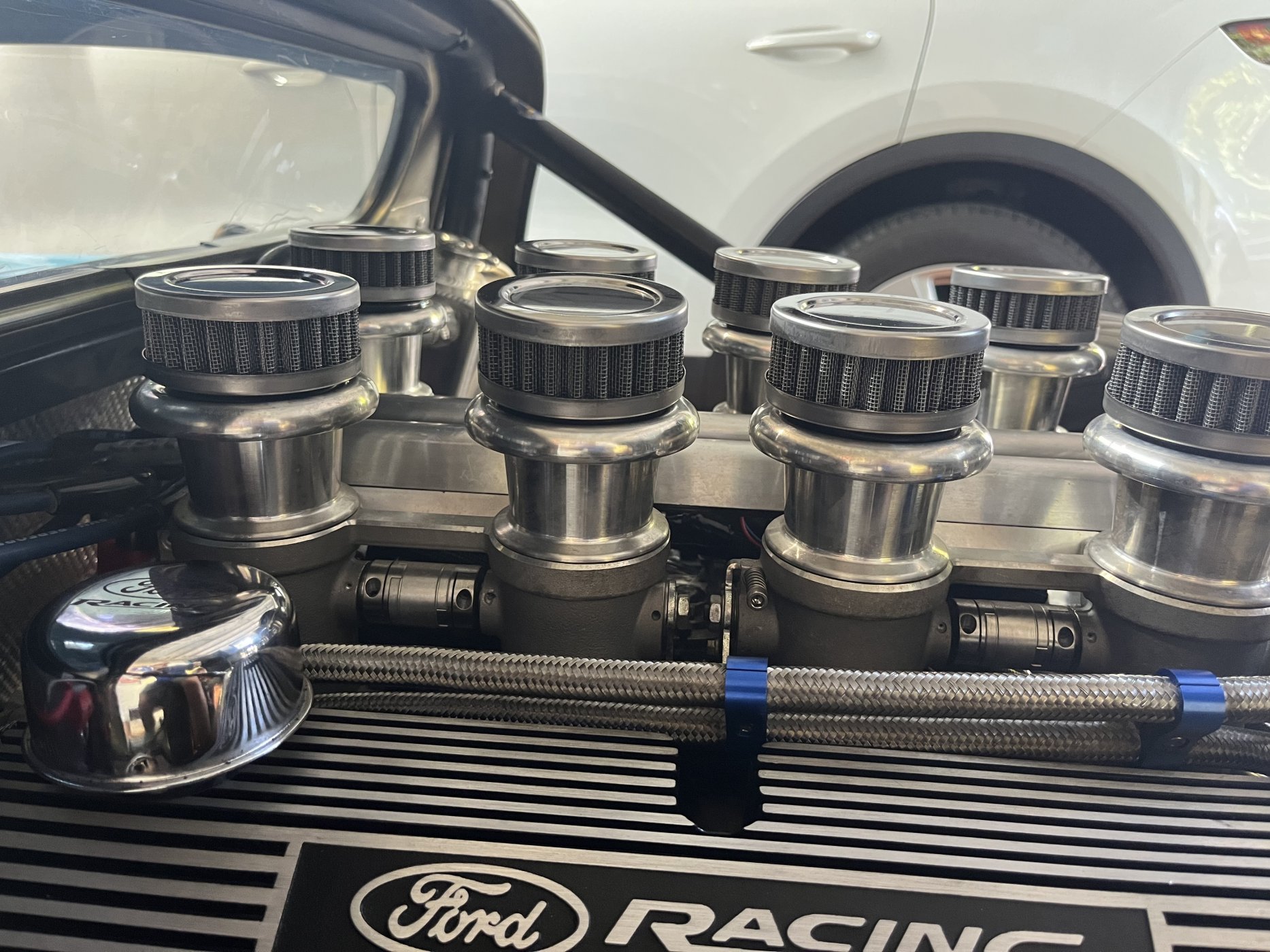

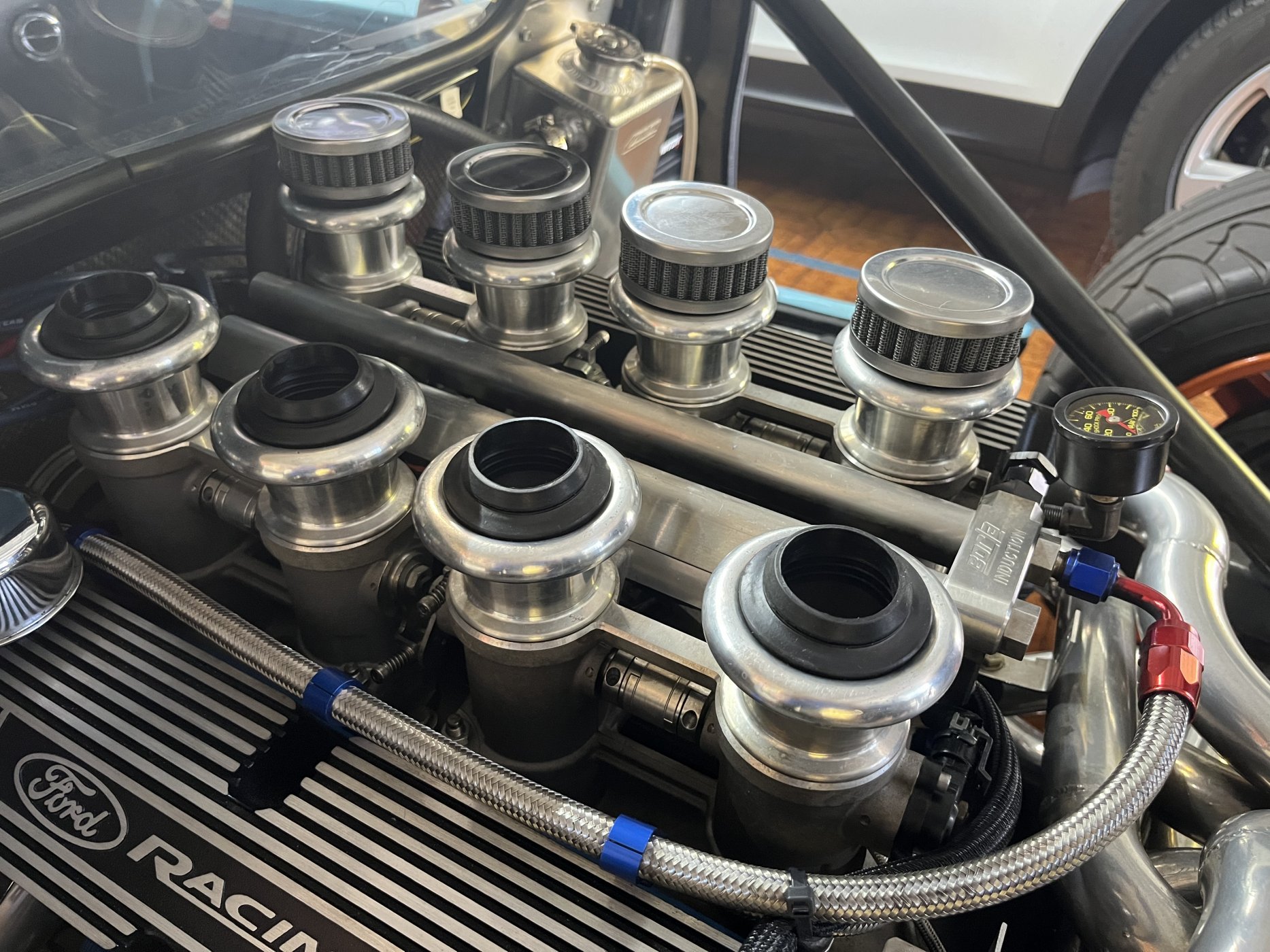

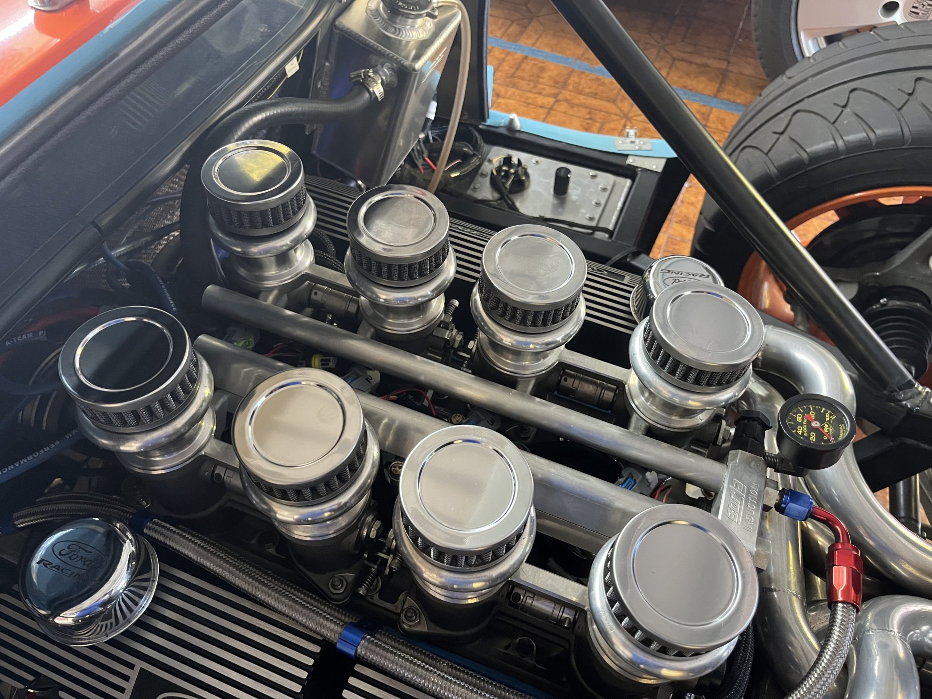

I have a Borla EFI eight stack with 50mm throttle bodies. I have been on a waiting list trying to purchase the K&N filters with no production or delivery date. The price for all eight filters is $357. I just bought these from Amazon and they fit great and look good. They also have different diameters and the cost was $100 for all eight. I thought I pass this information since many are waiting for the K&Ns. I am in no way a vendor or sponsor and just wanted others to know.

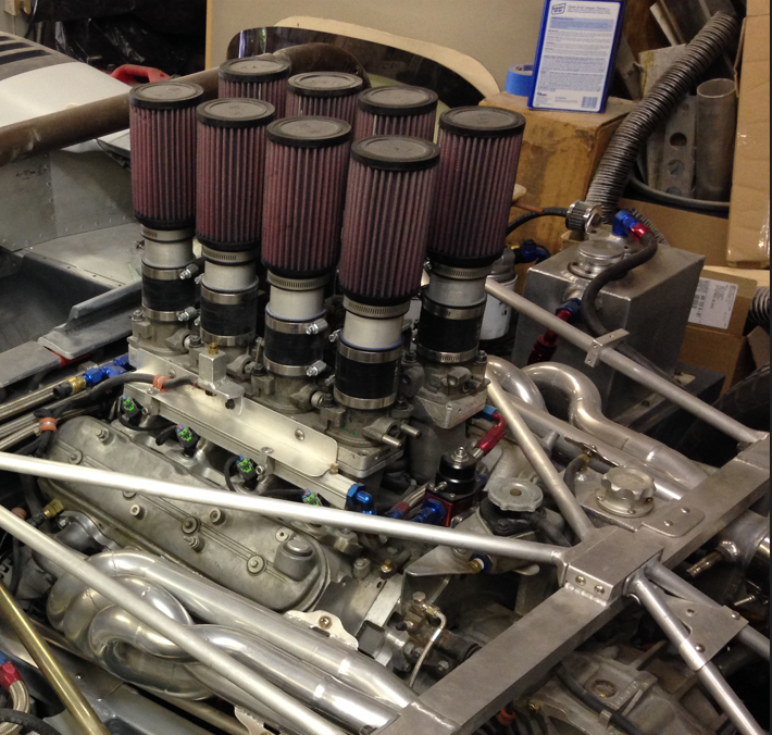

Their small size looks like they will be rather restrictive.
Brian Kissel
I’d much rather have a little restriction than stones and sand in my engine. If he was running flat out all the time I would be more concerned.
The efi should self correct any air fuel demands due to the filters.
Regards Brian
Regards Brian
It should not be a question of restrictive filters or no filters at all. Instead, a larger, less restrictive air filter would be a better choice. An EFI system could only compensate to maintain a correct air/fuel ratio, not for the reduction in power due to low air flow.
I ran my car with screens, switched to the Amazon filters and can’t tell the difference. I don’t track my car and maybe there could be a difference.

Hi, small filters of that nature (in the top post) can really kill performance. You could lose 30-50hp on a 400hp engine, and get something that looks cool but would get smoked by a 4 barrel on a dual plane intake. The ideal filter flow requirement for one cylinder is not that far below what the whole engine requires. One approach is to use two of the filter types (ITG, Pipercross, etc) that normally get used on a 4 cylinder engine with twin side-drafts. They are available with blank backing plates that can be water-jet cut to suit, with the backing plate sandwiched under the trumpets, or fixed to the underside of the return lip on the trumpets.
Cheers, Andrew

I haven't read all the thread but you can buy the K&N filters from Borla. K&N wont sell them to jo blow so Borla can gouge people who want them like me.
