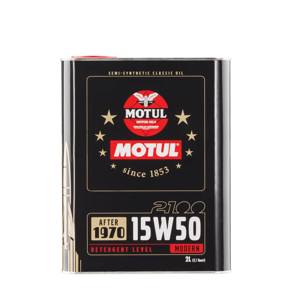

The best 10 or 15-50 or 10, 15 or 20-60 Motul 300V. Its what any race machine of the sixtees is using in Europ.
15W50 as its now widely available as a beter option to the 20W50 which is quite thick on cold starts.
Motul Classic has 1800+ppm of ZDDP to protect any oldskool engine.
I use their 20W50 for beak in, (3 times. 25minuts 2500rpm, then 350miles & again 350miles) and after 700 miles I switch to 15W50 on all my engine builds.
