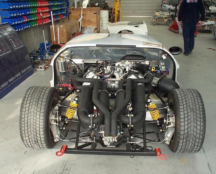

Has anyone had the exhaust pipes coming out where the rear lemans panels are for the 40? Similar to how Iain with RF 117 has done for his Group 2 car...

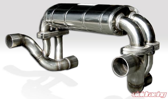

Maybe a modified arrangement from a late model ferrari / porsche. This F430 unit runs east-west, so may fit above the trans?

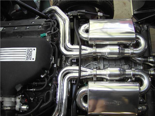

Thanks Troy. From what I can see there is no need for anything complicated....it would be simple to add cats to Iain's RF 117 setup as follows. It would mean the tips come out of the leman's panel cutout...
One could use standard quieter offset mufflers and 180 bends...
