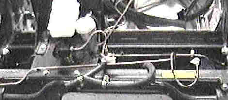

Hi Simon,
My GTD has an extended pedal box – though I don’t need it - however its not something I can give away!

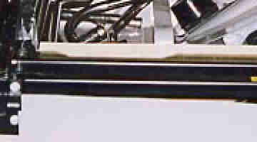

I attach a rather grainy photo of the relevant area. The mod consisted of an extra tube being welded to the front of the rearmost rail crossing at the front bulkhead. This simply allows the standard pedal box to be mounted further forward. The original rear rail was then cut at an angle in front of the pedals to allow free movement.
On the second photo (next post) you can just see where the rear tube was cut out. I would have thought you could make this mod in situ relatively easily if you bolt and then weld an extra tube.
