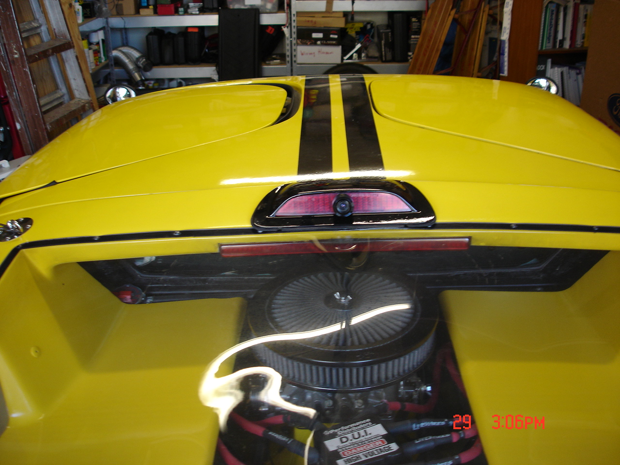

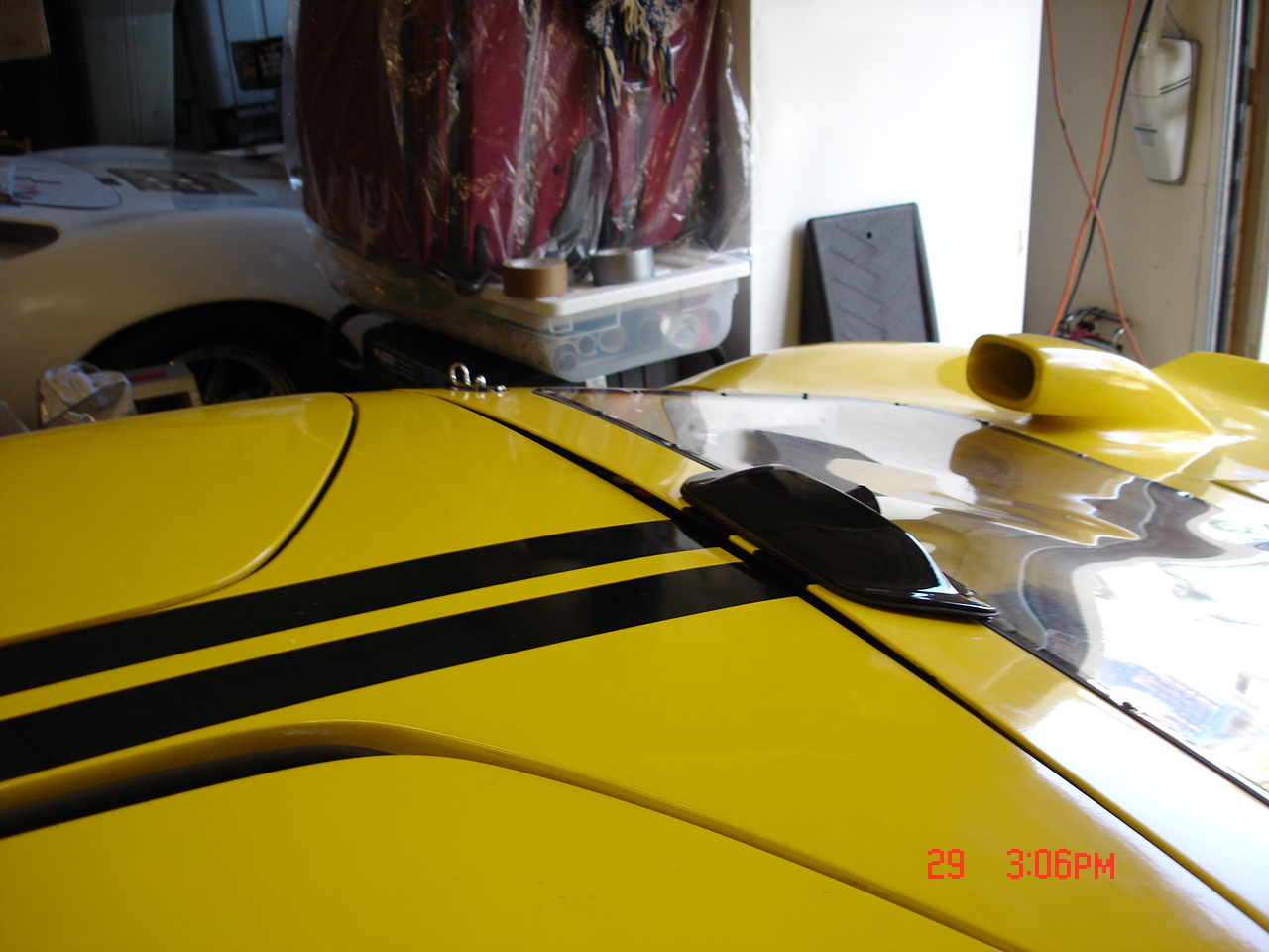

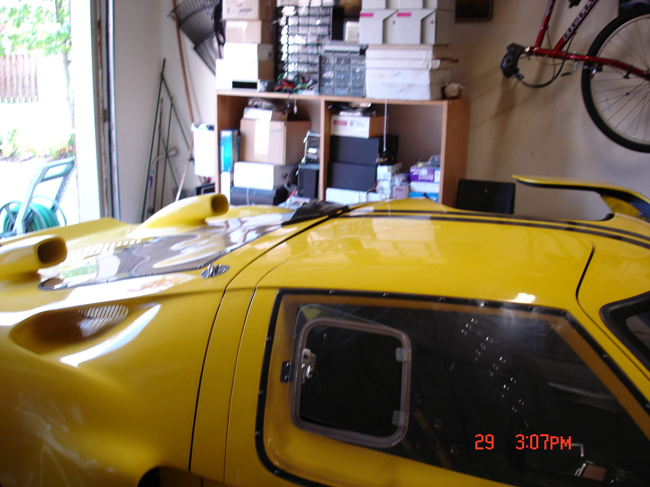

I mounted mine on the rear deck using a third break housing from another car!
John

Thanks so much for sharing. Nice looking install. I tried mounting my camera there and it gave a great rear view of the the cars around me but for me it gave a very strange perspective while backing up which is how I like to park the car in my shop. A turntable would be nice but pigs don't fly either. Thanks again.
