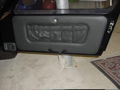

Dave,
The inside of the door compartment is carpeted. The panel
has a simple piano hinge across the bottom,a satin
finish, stainless catch at the top, and a pull handle near
the bottom.
For you guys with two contrasting colors, you might consider painting the sill the same color as the rest or the interior (black), extending it into the area of the seal of the window, but doing it in a matte finish to cut down on reflection. That is what I'm considering.
