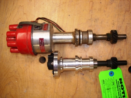

I have now found following informatinon;
The Windsor 351 and Cleveland 351 have almost the same distributor. The Windsor is a little taller and the the gear is different. So I would go for a Cleveland distributor and in my Fontana block it fits right in.
Skog

This list is familiar and most valuable!
I have now found following informatinon; The Windsor 351 and Cleveland 351 have almost the same distributor. The Windsor is a little taller and the the gear is different. So I would go for a Cleveland distributor and in my Fontana block it fits right in.
Skog
Glad that was ueful. FWIW, the housing features that actually interface with the block on either 351c/429/460 or 351w distributor are the same. The gear and position on the shaft differ between the two. The installed height, diameter of cap, and external features vary depending upon make. Be advised, there can be subtle differences in shaft diameter that affect fit of the gear as well as the pilot bearing clearance on the end of the distributor shaft. You'll need to measure to be sure. Here's a picture of a 351c Mallory and an MSD "351w" Cam Sync. -Interface dimensions are identical accept for gear.

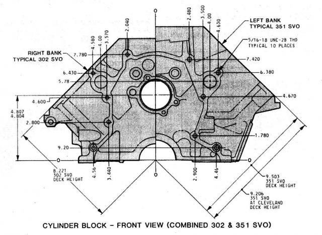

Have one of each in shop at moment so decided to measure/check info. Cam / Crank Centerline distance on 351c is around 5.125", Windsor is around 4.875".
I had to go look. W is 4.804/4.807" crank to cam; see picture below. Will get precise C dimension and post later.
Lifter bore angle ( from left to right bank ) on 351c is 90°, Windsor less @ around the 83° mentioned above...
Yes
Seems odd to me that Fontana chose to use the Windsor cam location with the Cleveland cam & going to the trouble of making a dedicated front cover etc, when using the cleveland cam location would have allowed more room for a stroker crank and kept the lifters/pushrods further away from the water jackets in the valley. That info sheet would appear to have some errors in it.
I agree. Very odd. Have a look at the page extracted from the Fontana Clevor brochure. So how can a W crank/cam centerline be less and afford more clearance? Granted, it's a brochure and hype but wouldn't seem to be an error that could be made by such a knowlegable source.
Kelly

I measured my Fontana block and the centre to centre distance from cam to crank is 4.8025. slightly under but it has had an align hone. Which ties in with Kellys chart.
