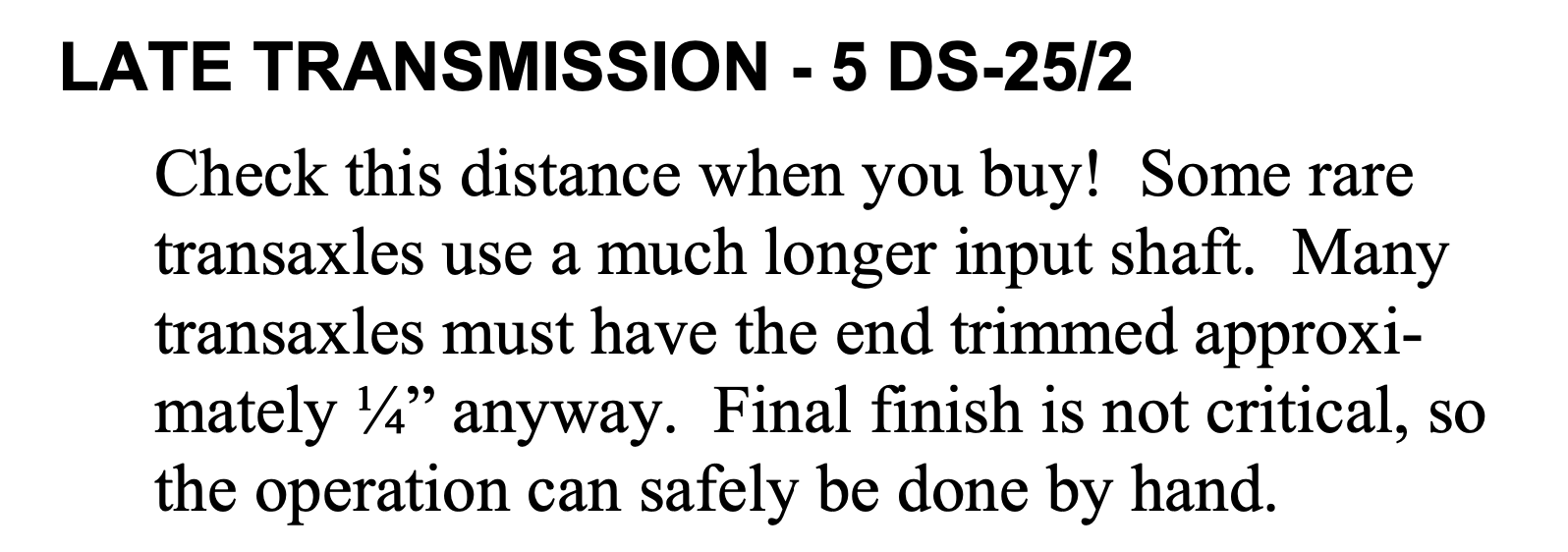

For what it's worth, the ERA build manual says the bellhousing must measure 4.0" face to face. It also says this about the -2 ZF:

Does the ERA manual give the actual length of the shaft? It looks like we have the same length rare shafts Lee…..how fortunate of us!!!

Found it. Right under that statement that Lee posted in the ERA manual about the rare -2 with longer input shafts they show a picture with how to measure the input shaft and show 4.7”. Well I measured mine. Anyone want to guess how long it is?????
