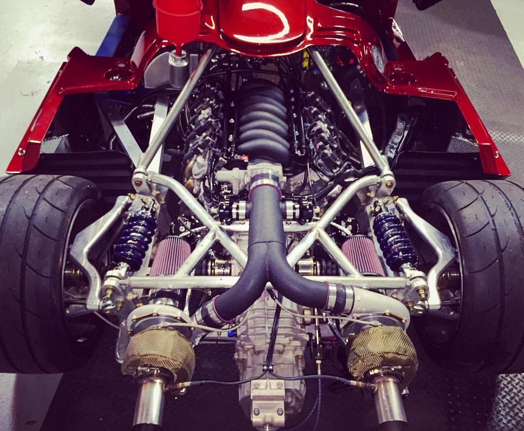

So what has been built for SL-C LS based turbo systems? To the best of my knowledge, the Gearz car didn't come to fruition/completion. I heard Fran has built or is building one or more (???), and I know the guys at Horsepower Solutions built the system from the 1320 1/2 mile video. In fact, what they built is almost exactly what I was considering doing, but with the race tail configuration.

Light on details, but here are a couple shots I snapped back in Jan '16 of a turbo SL-C while visiting RCR.

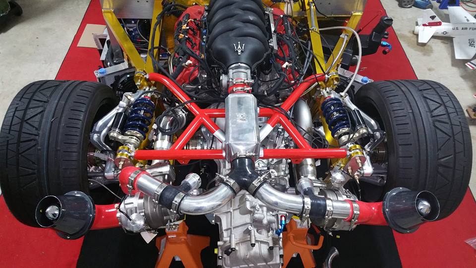

Twin turbo 1UZ. Water/air intercoolers and handmade intake.
Alas, I will probably be switching it out for the M275 Mercedes 5.5L V12 Biturbo motor that has down right nasty bottom end torque, and of course the sound.
I suppose I have a thing for turbos. Out of 5 cars/trucks, only one doesn't have twin turbos. Lol.
Here’s a pic of the Maserati you’re referring to..

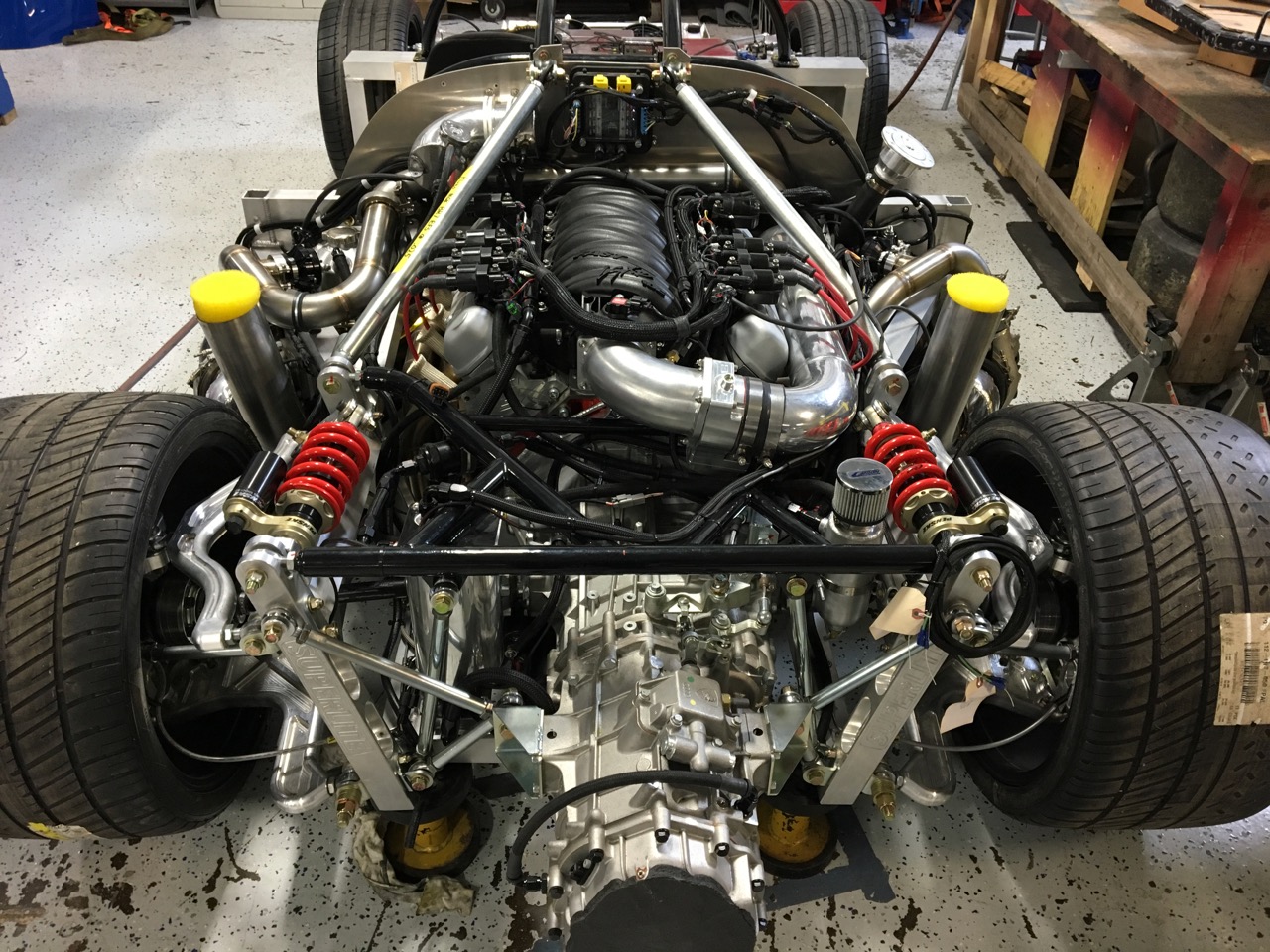

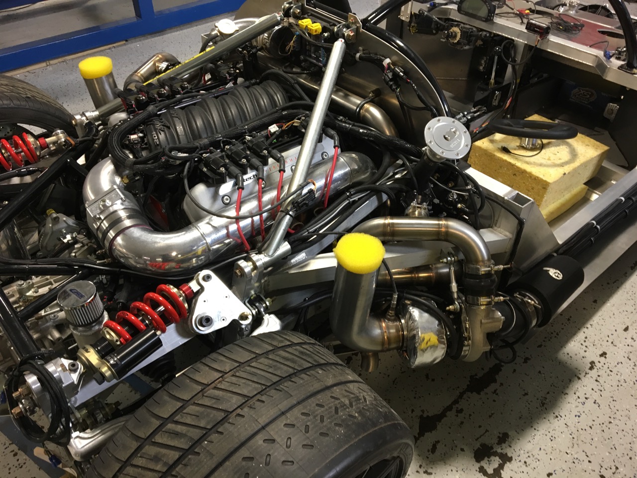

I'm switching my SLC from LS to 1UZ VVTi with a single turbo. Turbo is getting mounted at the back (ala Porsche 917). Plan is 900 RWHP. Not far enough along for pics...
