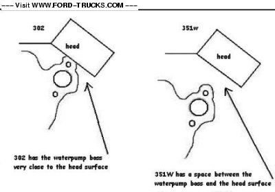

There can be confusion over numbers John, not everything goes by the book with Ford numbers. If you have the heads off just get a piston to the bottom of the bore. A 302 piston will go down the bore 3" and a 351w will go down 3.5"
Bob
