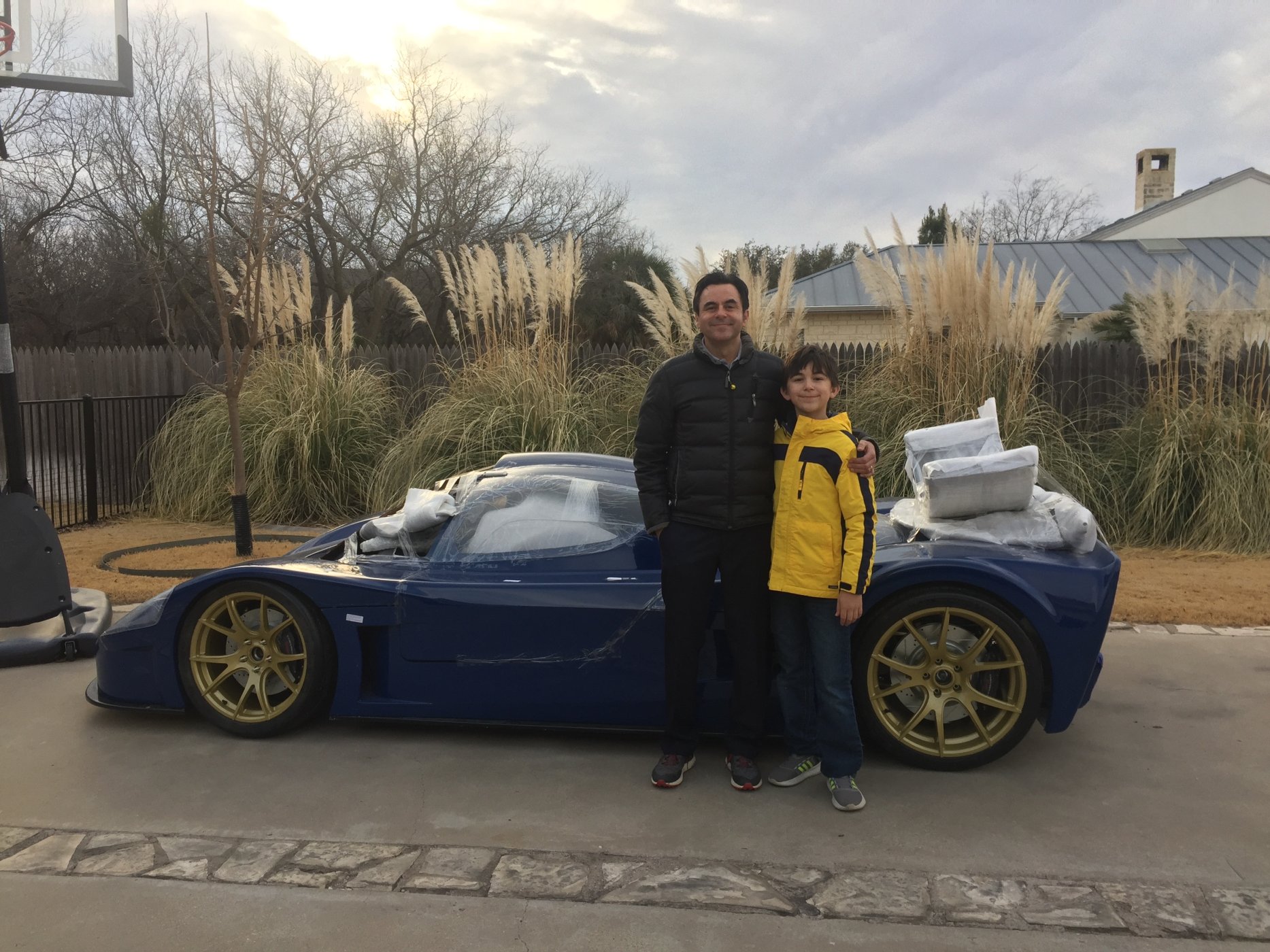

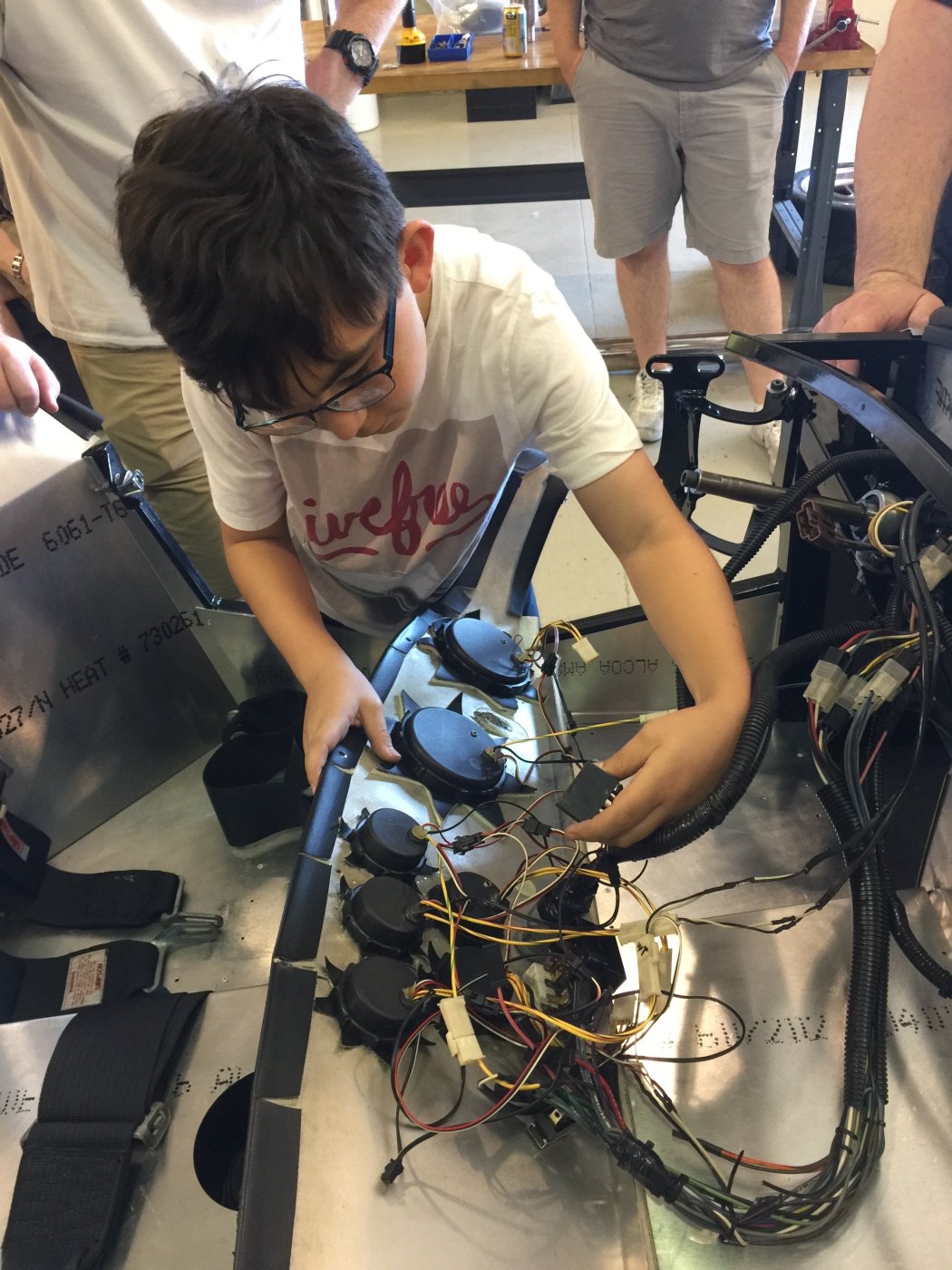

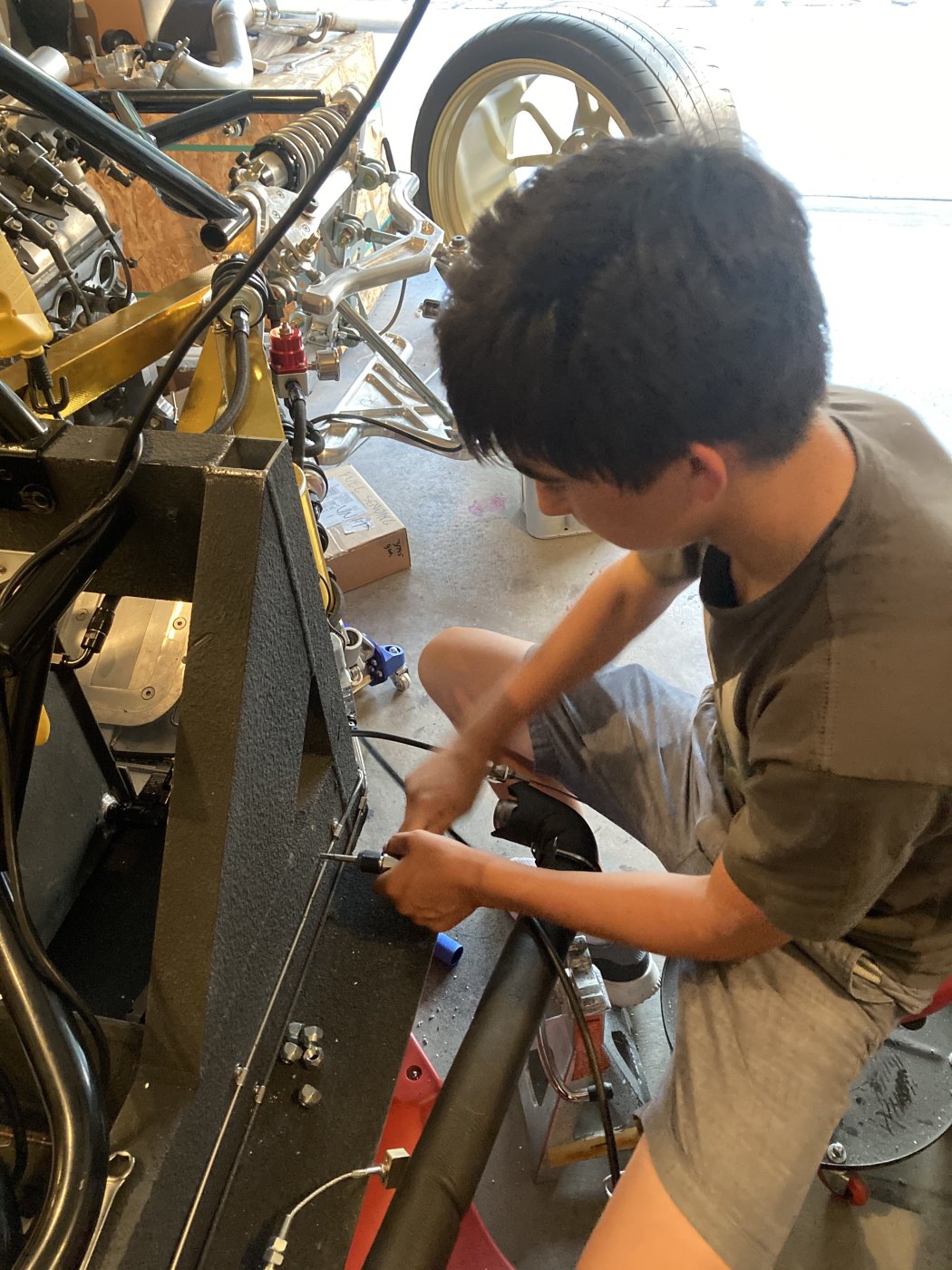

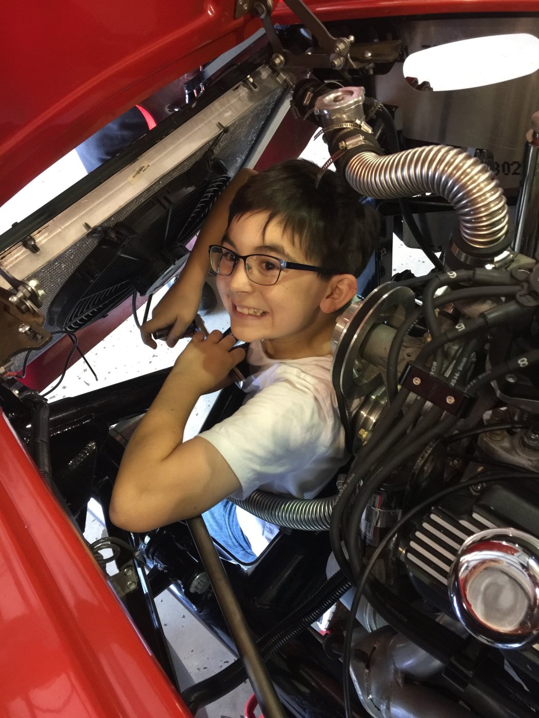

My son and I went to the factory V build school at Motts college in Michigan and build a factory V cobra over a weekend class, he was 11 then, I told him that if he enjoyed the experience we would buy a kit, (not a Cobra which I don't like that much) . After much research we settled on the Superlite SLC over the Ultima and the factory V GTM. We had a great time over the years , he was always busy but was always willing to help, and he did a lot of the electric stuff for me including all the custom wiring harnesses, custom horn noises, air horn and a bunch of other stuff. I was hoping to finish before he went off to college but did not make it, He just finished his freshman year at MIT, he is coming Thursday and we will go for his first drive on the SLC .
Enjoy the journey with your son, that's what's all about . Good luck with your build. I hope you find my story inspiring to you and your son. Happy to answer any questions or provide any advice.
Hector
