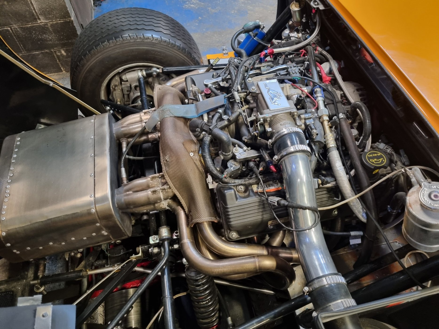

I have a Ford Mustang Modular 4.6 but the 16 Valve engine fitted to my GT. It required the chassis to be special built by Southern GT so it would fit, but it fills the engine compartment and looks very impressive.

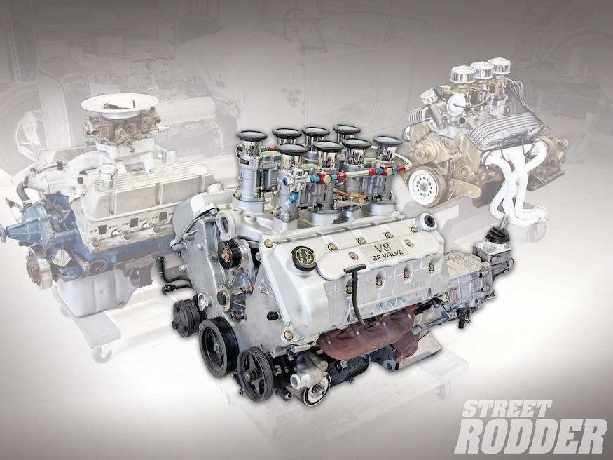

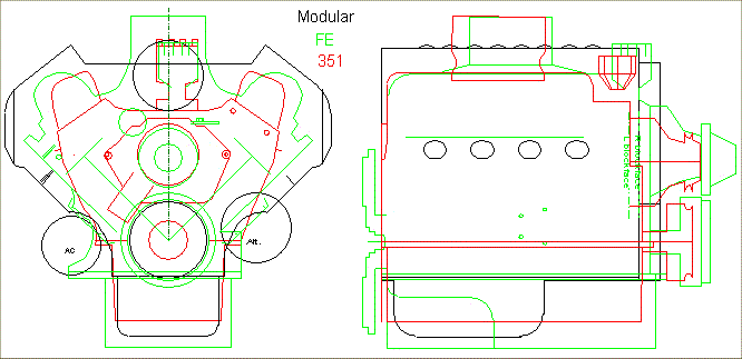

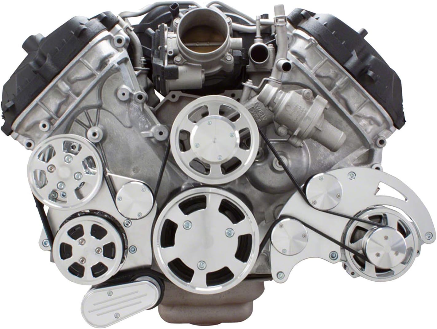

Here are a couple of pictures one of a coyote and the other of a SBF. I also include a drawing on an SBF, FE, the other 4-valve Ford. There is also pictures I have seen posted on GT40S that is a very good one showing the difference in size of an SBF and a 4 valve motor. I think it was taken at a car show Ford Performance display.

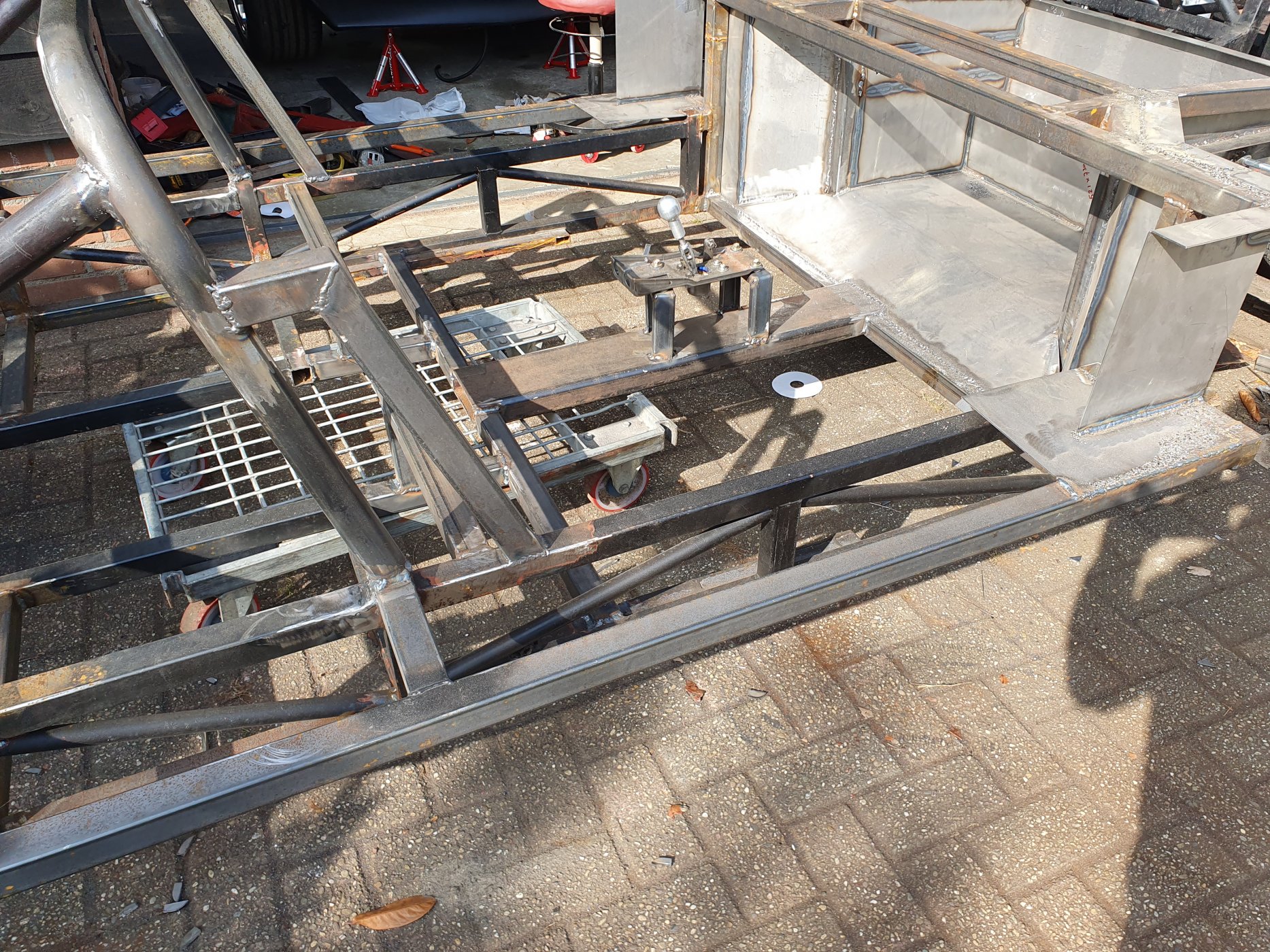

I am going for the Lincoln Continental 4.6 32v Intec 2001 with 275 hp engine. I allready found someone that drilled holes where the mounts should go.
I cut and put the pieces wider that go from the rollbar to the rear chassis, so the width of the 4.6 DOHC will fit the frame. Now i am waiting to order the engine. When i have it here, i will look if i need any more structual changes. Maybe a few diagional strengthening pieces, and i will have to make the brackets for the motor mounts. Also had someone here that made a dry sump system. I will be looking in to that too if i cant make it fit as it is.
I am really looking forward to start with fitting the engine.
Today i made the brackets for the front lower suspension, and finished the lower part of the rear suspension. Also made brackets for the shifter unit and welded it on to the frame.

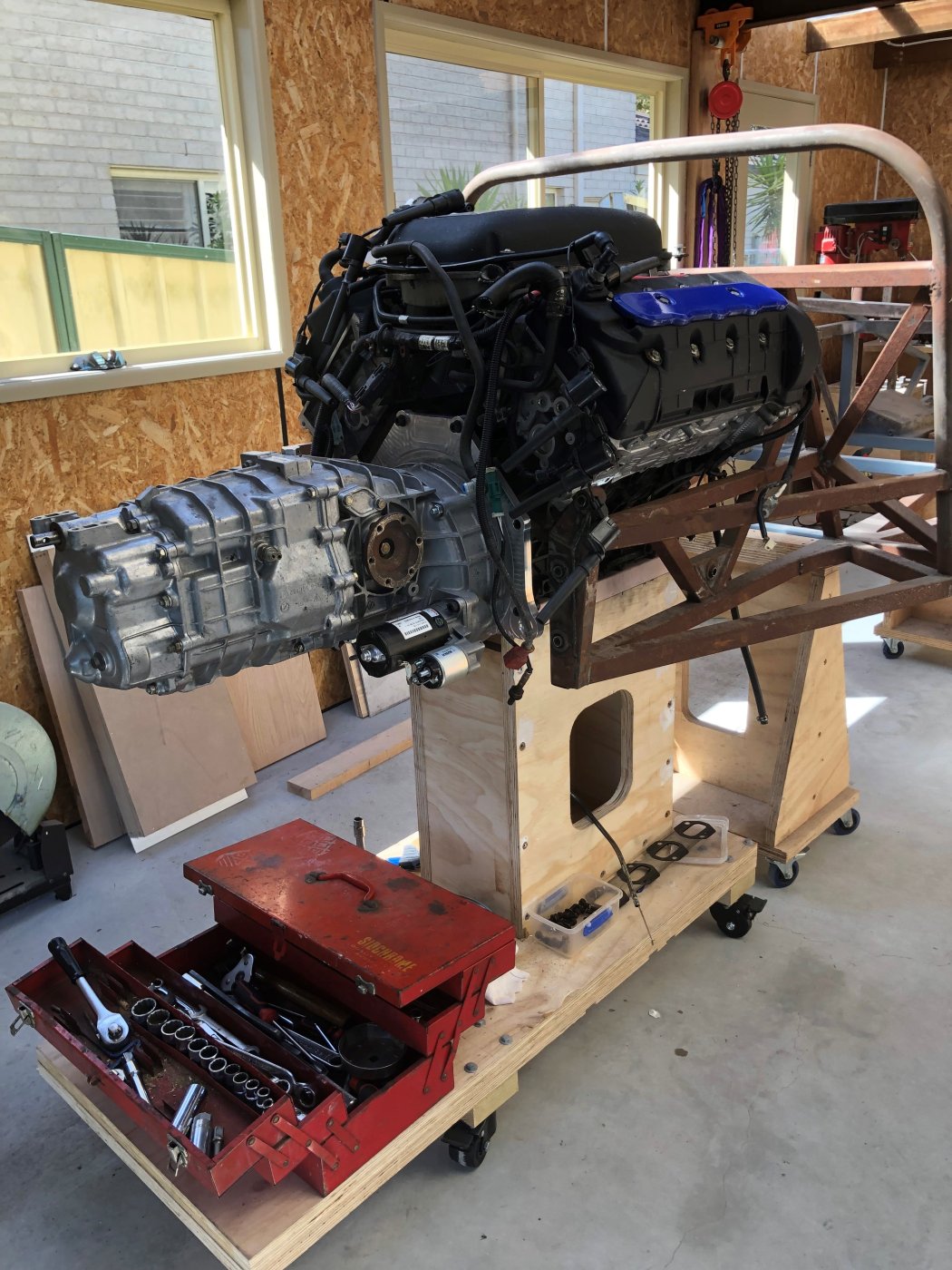

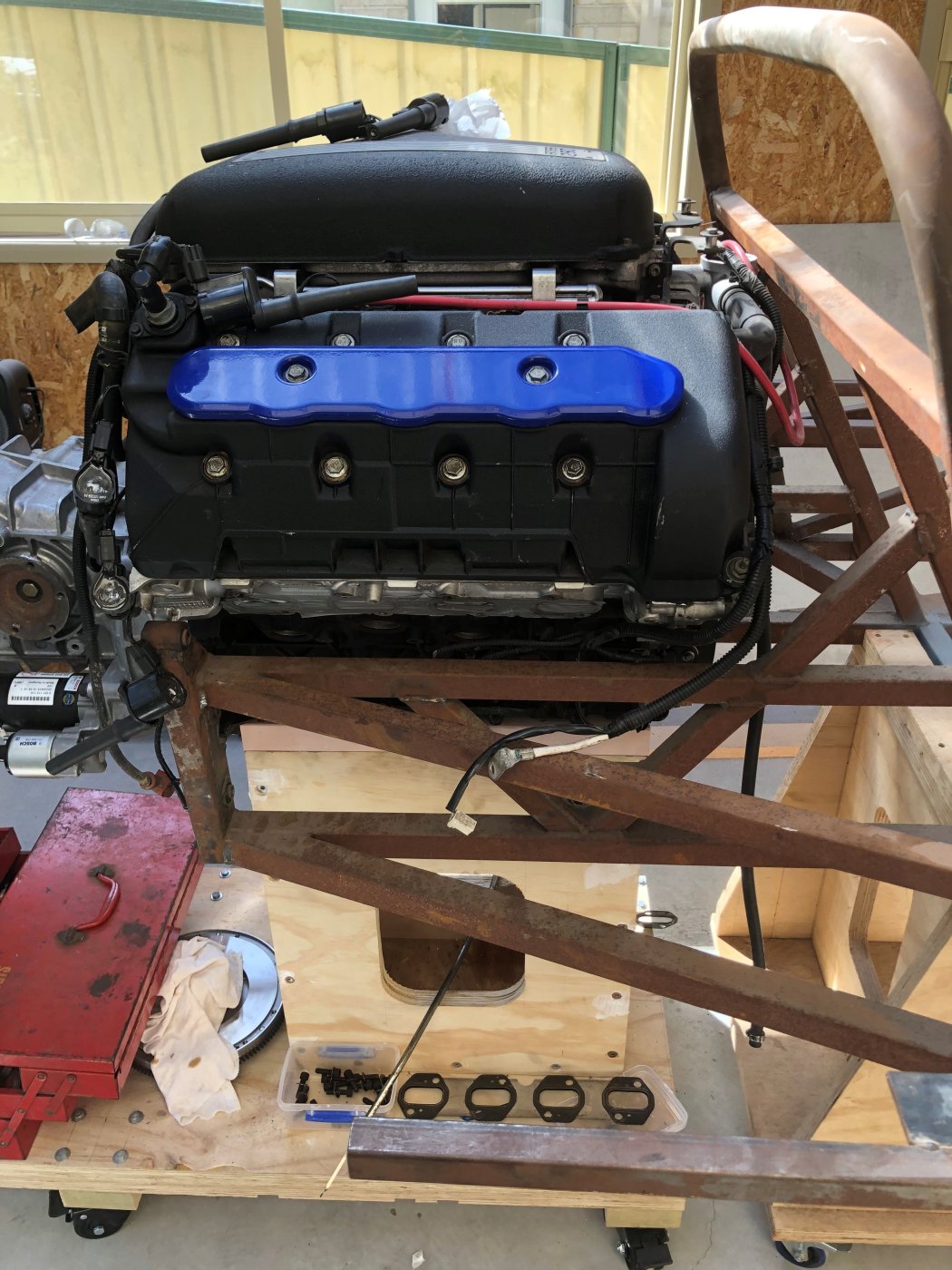

HI Dave ... I am fitting a 5.4 liter Ford Modular (Boss 290 in AU) with Porsche G50. Main issues are the oil inlet is very close to the chassis - and fitting the engine low enough may necessitate a Dry Sump. I can post images if you are interested ...
