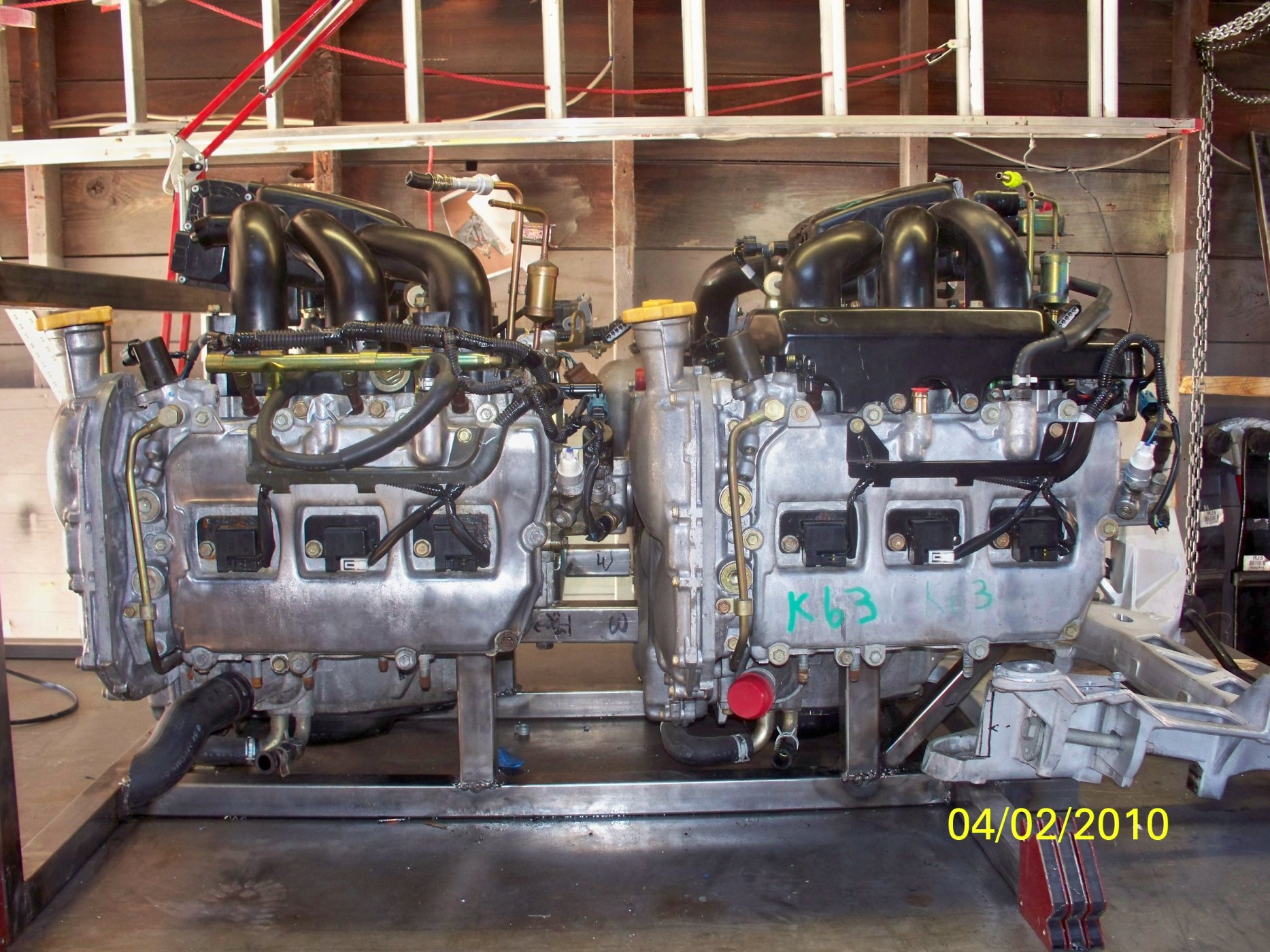

You could try what I did. I haven't sold the car yet but it's all there and was running when I parked it.
There are a couple of things that drive my enthusiasm for replicas. One is original manufacturer for components etc so Porsche engine and gearbox is important The other is the sound they make. A Porsche flat 12 would be great but there isn`t much living space inside a 917. Even if I sold the house to buy an engine it wouldn`t be enough. If it would fit I might try a BMW V12 or Mercedes V12. That way it would be German at least. Sticking a couple of flat 6`s together might be too long but is an idea I had year`s ago and I might still try. The BMW V12 idea might be the easiest but go with what suits you. It`s your dream?
Two Porsche designed Subaru EZ30 engines connected with a chain drive will fit into the engine compartment of a 917-wheelbase car.

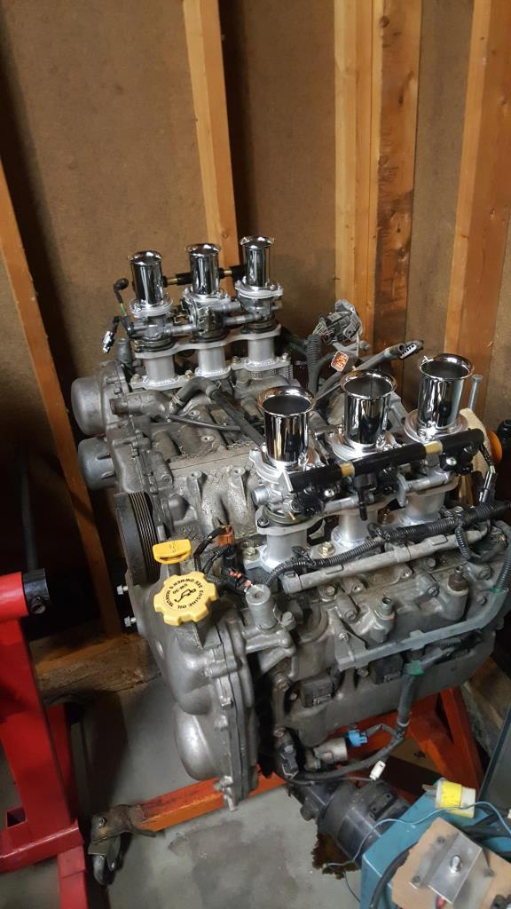

A Subaru 3 litre 6 cylindr is dead simple if doing a 906, reliable as well, I run the Subau car here in NZ, most of them over 300km and still going. Good auto and with simple engine in front of transaxle just like the Porsche.
