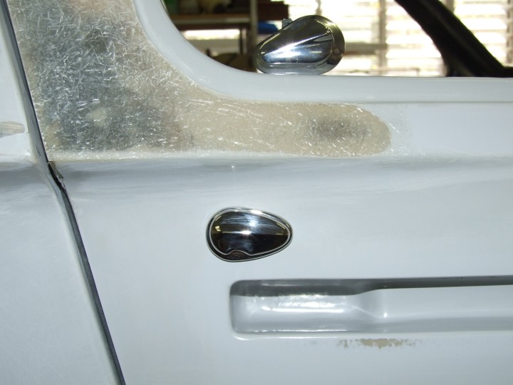

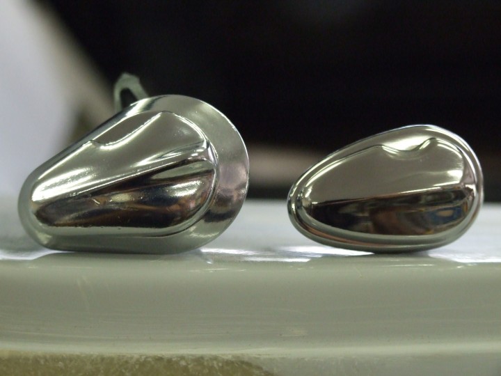

I'm in the middle of putting locks in the doors as well.
Bought a Rover P6 lock, but it seemed to have a very large base.
So I picked up a set of the Ford locks (copy this into Ebay - 140761922075)
and they seem to suit the space better. Haven't done the links yet.
Clayton

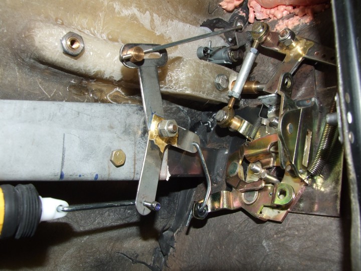

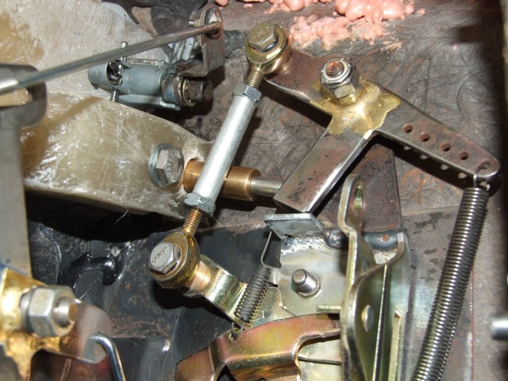

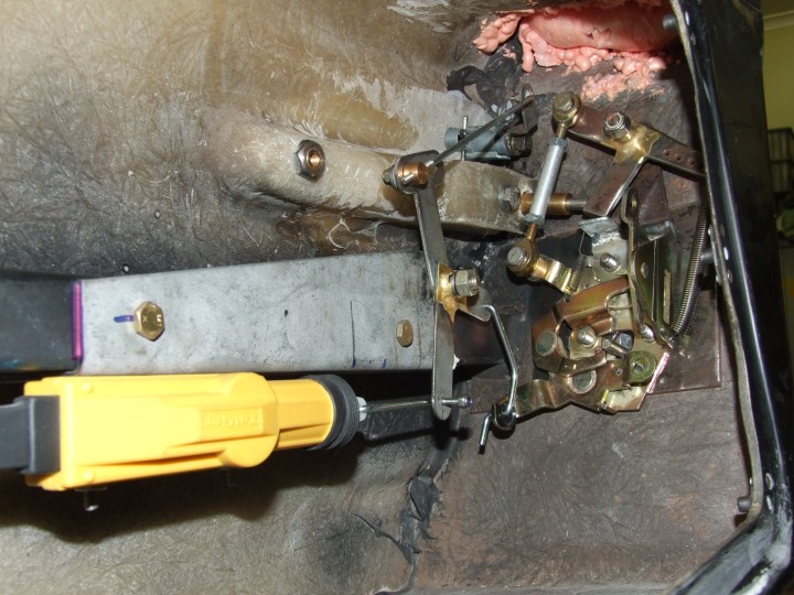

Hi Larry
I forgot to post some pics of the lock mechanism.
Had to add a few more levers due to central locking, but you get the idea.
Clayton
