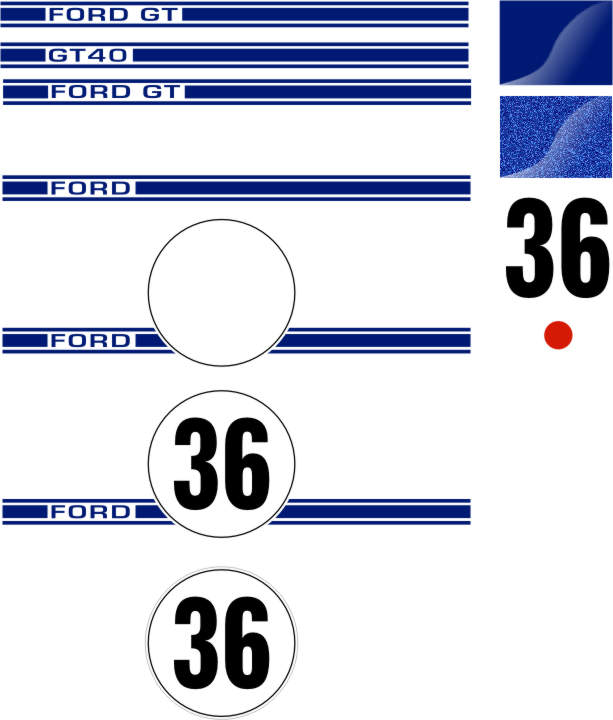

I'm contemplating setting up a graphics/paint resource page for the MDA website that would list PPG and DuPont Ford/Shelby paint swatches and thier color codes from 1965 thru to 1970.
Also, I am in the middle of setting up a graphics info page that would have period correct sizes and layout of stripes, number roundels etc..
Would anyone find this a benefit? Shall I proceed?

Great idea Chris. If I'm correct, you have a graphics background? Should result (especially from just what you've shown here) in a great resource of interest to lots of us. Will you have different views with changeable graphic overlays? what about a quicktime VR??? Look forward to more! /ubbthreads/images/graemlins/smile.gif

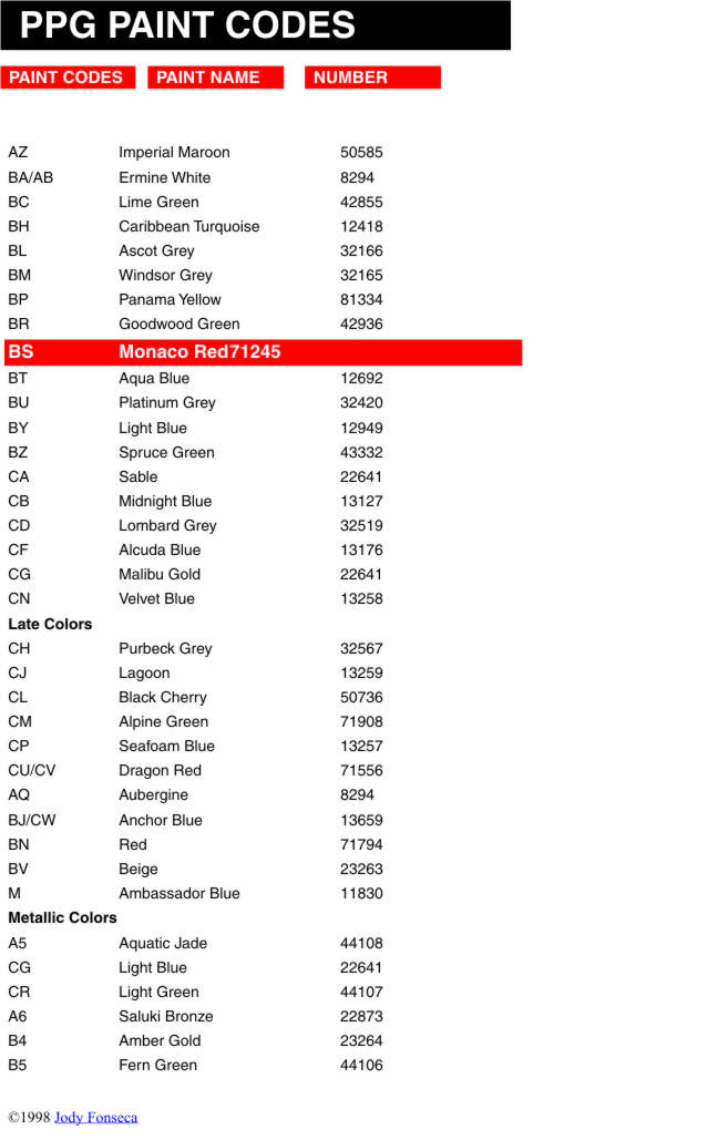

Hi Chris, Can you supply the paint mixing formula for 1966 Ford Monaco Red paint? My GT would have been painted in England at the Alan Mann race shop, early 1966.
These codes are for the Ford Cortina. This is not a complete list but most of the common EnFo colors are here. Even if there is no PPG dealer in your area, most dealers have a cross reference to whatever brand they sell.
Hope this helps-

I think I may need to tell SPF how much room to leave so I can have "FORD" airbrushed into the sill strips, your 4th example down. How far back from the wheel well would the blank area start and how long would it be. In fact I may need to tell them the dimentions for all the sill strips. Is there a name for the font Ford used? Thanks for the help.
Hi Richard,
The overall height of the sill stripes I provide are 3 in. The front inner stripe is 4 in long with a 1/2in space and the word 'Ford' is 7 in in length. I had a hard time finding a decent looking font so I just re-created it from scratch.
I can make these sill stripes with 3M paint mask.
Hope that helps
Chris

I guess I didn’t understand your answer at first. Does your answer means you can provide me with a paint mask for the "FORD" lettering? I would also think because you do it on a computer you could make it any high and width I needed depending on how SPF lays out the sill stripes, is that correct? You do beautiful work, thanks for the help.
Sorry for any confusion - I guess the simple answer is yes, I can make you a set of 'Ford' paint masks to fit within your sill stripes.
