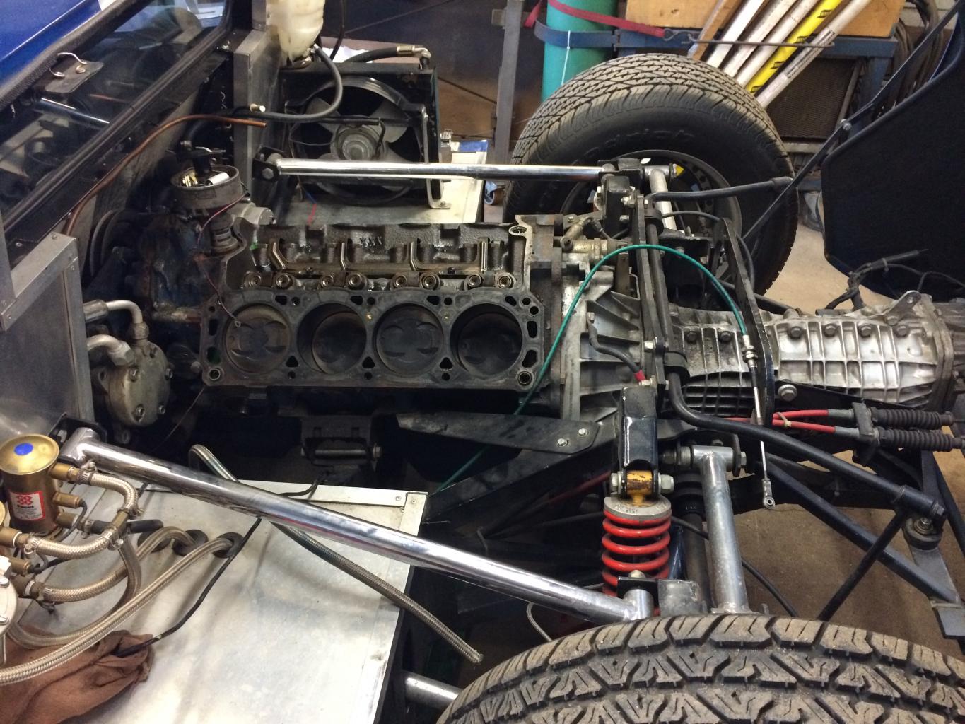

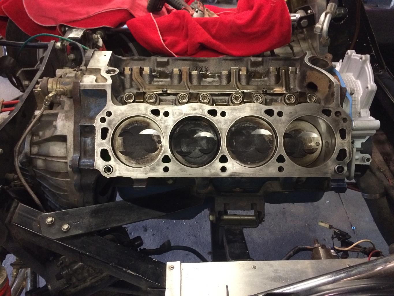

the cam is a 228 duration with 542 lift . with a 202 and 160 valves . we cut into the pistons to make room for the valves as you can see with the pics. also my engine is a 5 L it is a 1988 engine with forged piston. i was told it has a different firing order then the old 302s.

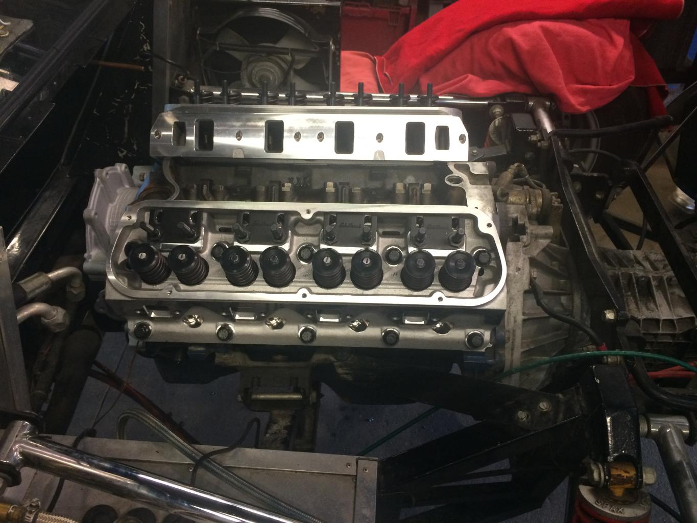

You are upgrading to hardened pushrods, right?

1) Cutting in your pistons means you are changing the balance of the rotating assembly...are you going to re-balance it ?
2) I see some marks on the valve stems of your new heads...did you checked the rocker geometry on to the stems (having the correct length of pushrods). The roller should stay in the middle during the cycle of going up and down, or at least have a minimum travel in the middle.
3) Did you calculated the new compression ratio ? Your Alu heads will handle more CR however you should know how much you are. For this you need piston cc, heads cc, headgasket thickness, bore size, etc..

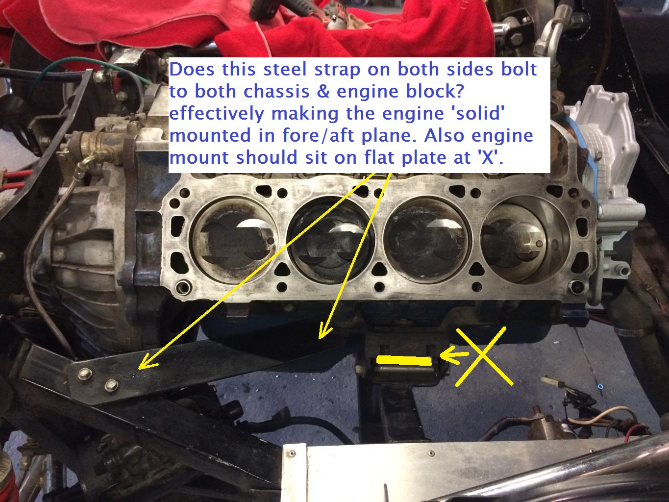

yes we up graded the pushrods. we pre set the tool so all pistons lost the same weight so I hope that will keep them in balance. they did check the to ensure proper length for the pushrods. I will ask what the new compression ratio is. also I noticed that steel bar that goes from the frame to the motor mount. the engine does seem to sit nice and not move much when under load.
Hi Paul,
Those steel bars act as a spring since the are bend under torque. Depending on the thickness, quite a strong spring but not harming to my feeling.

I would not be to concerned about that minor flycut you have made on inlet eyebrow of pistons, they all 'look' similar and should not have increased any variation across the set by more than a gram or two. The reciprocating portion of the effective bob-weight on your combo will be ~ 800gm's, the amount you have removed will only be about 12/15 gm's max, probably less which is less than 1.75%... as its quite acceptable to 'overbalance' reciprocating weight by a couple of percent for a performance engine you should be OK. The fact that its a 3.00" stroke ( short ) also reduces the concerns, if it was a 4.25" stroker the change would be more critical.

..Seriously, make sure you get new hardened steel pushrods. The guideplates on your new heads will eat your stock ones in short order.
