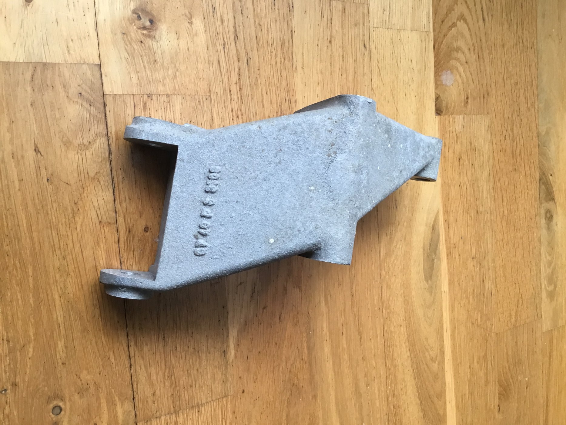

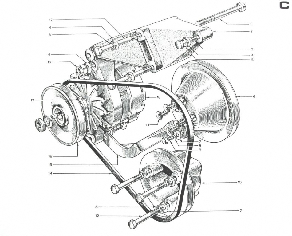

Road car .
The parts are typical the ones you may found on 289 or 302 engine block, mounted on Mustang 65 up to 69. Look at Mustang part supplier.

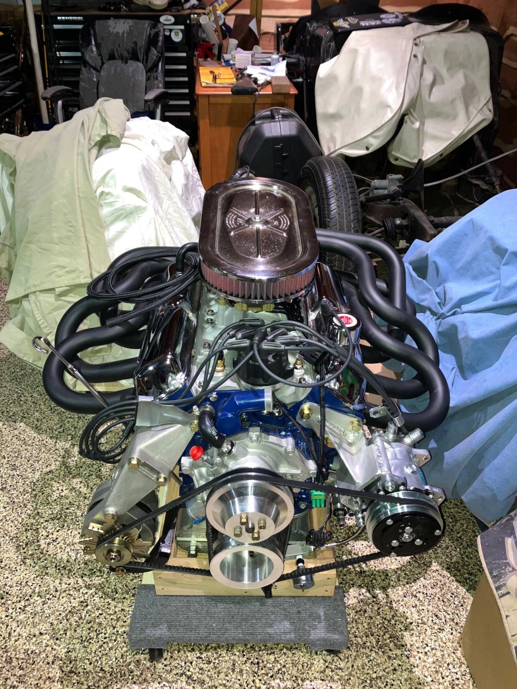

Davidmgbv8
I used the oem alternator bracket, looks great works well, my AC bracket kicked out the compressor to where it hit a tube that supports the back
of the cockpit, now on to rev2 with a smaller compressor.
