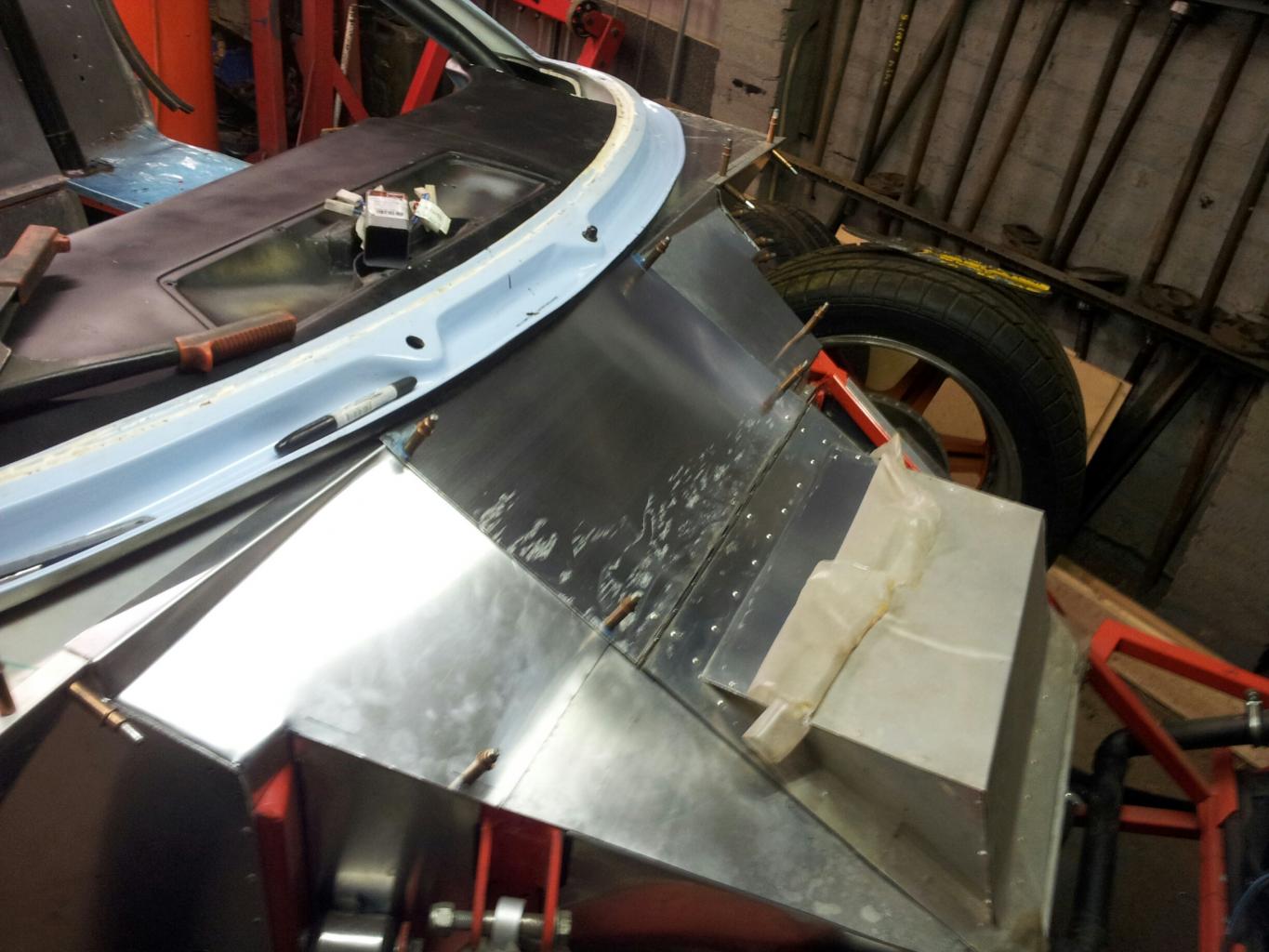

First attempt. Panelling needs tidying up and cleaned/polished but trying to enclose the full area.
Comments please?

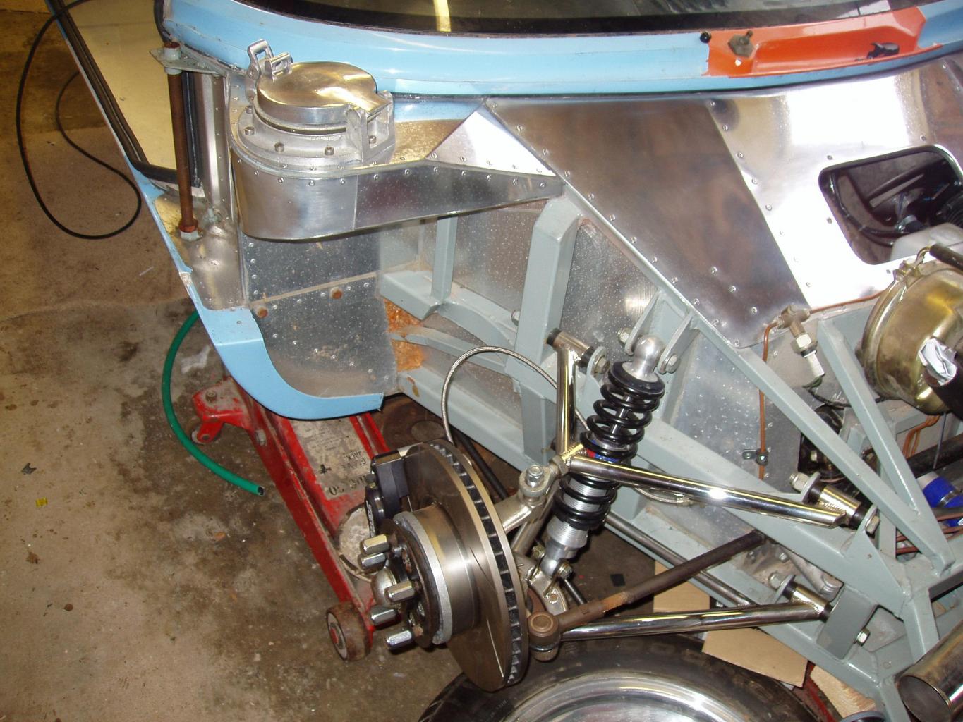

Just found these KVA pics which may be useful.
