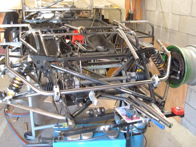

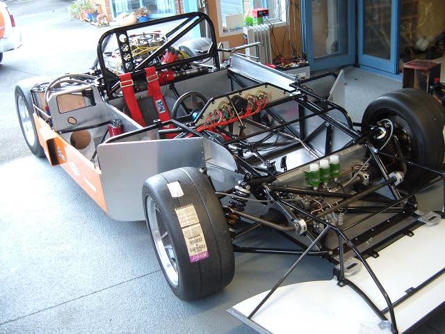

Sorry about the clutter but you can see the rack in position.
